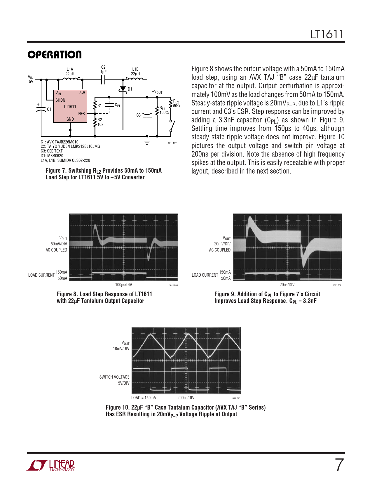

OPERATIO. Figure 7. Switching RL2 Provides 50mA to 150mA. Load Step for LT1611 5V to – 5V Converter
OPERATIO Figure 7 Switching RL2 Provides 50mA to 150mA Load Step for LT1611 5V to – 5V Converter
LT1611
U OPERATIO
C2 L1A L1B Figure 8 shows the output voltage with a 50mA to 150mA 1µF 22µH 22µH VIN load step, using an AVX TAJ “B” case 22µF tantalum 5V capacitor at the output. Output perturbation is approxi- D1 V –V IN SW OUT mately 100mV as the load changes from 50mA to 150mA. SHDN R + L2 Steady-state ripple voltage is 20mV R1 CPL 50Ω P–P, due to L1’s ripple LT1611 C1 RL1 NFB 100Ω current and C3’s ESR. Step response can be improved by C3 + GND R2 adding a 3.3nF capacitor (CPL) as shown in Figure 9. 10k Settling time improves from 150µs to 40µs, although steady-state ripple voltage does not improve. Figure 10 C1: AVX TAJB226M010 1611 F07 C2: TAIYO YUDEN LMK212BJ105MG pictures the output voltage and switch pin voltage at C3: SEE TEXT D1: MBR0520 200ns per division. Note the absence of high frequency L1A, L1B: SUMIDA CLS62-220 spikes at the output. This is easily repeatable with proper
layout, described in the next section.
VOUT VOUT 50mV/DIV 20mV/DIV AC COUPLED AC COUPLED 150mA 150mA LOAD CURRENT LOAD CURRENT 50mA 50mA 100µs/DIV 1611 F08 20µs/DIV 1611 F09
Figure 8. Load Step Response of LT1611 Figure 9. Addition of CPL to Figure 7’s Circuit with 22
µ
F Tantalum Output Capacitor Improves Load Step Response. CPL = 3.3nF
VOUT 10mV/DIV SWITCH VOLTAGE 5V/DIV LOAD = 150mA 200ns/DIV 1611 F10
Figure 10. 22
µ
F “B” Case Tantalum Capacitor (AVX TAJ “B” Series) Has ESR Resulting in 20mVP–P Voltage Ripple at Output
