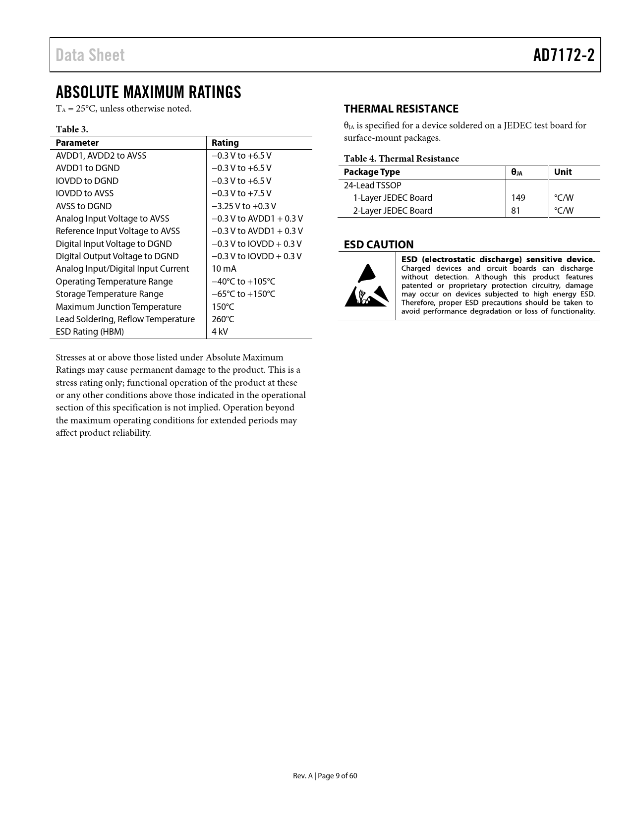

Data Sheet. AD7172-2. ABSOLUTE MAXIMUM RATINGS. THERMAL RESISTANCE. Table 3. Parameter. Rating. Table 4. Thermal Resistance
Data Sheet AD7172-2 ABSOLUTE MAXIMUM RATINGS THERMAL RESISTANCE Table 3 Parameter Rating Table 4 Thermal Resistance
TA = 25°C, unless otherwise noted.
THERMAL RESISTANCE Table 3.
θJA is specified for a device soldered on a JEDEC test board for
Parameter Rating
surface-mount packages. AVDD1, AVDD2 to AVSS −0.3 V to +6.5 V
AVDD1 to DGND −0.3 V to +6.5 V
Package Type θJA Unit
IOVDD to DGND −0.3 V to +6.5 V 24-Lead TSSOP IOVDD to AVSS −0.3 V to +7.5 V 1-Layer JEDEC Board 149 °C/W AVSS to DGND −3.25 V to +0.3 V 2-Layer JEDEC Board 81 °C/W Analog Input Voltage to AVSS −0.3 V to AVDD1 + 0.3 V Reference Input Voltage to AVSS −0.3 V to AVDD1 + 0.3 V Digital Input Voltage to DGND −0.3 V to IOVDD + 0.3 V
ESD CAUTION
Digital Output Voltage to DGND −0.3 V to IOVDD + 0.3 V Analog Input/Digital Input Current 10 mA Operating Temperature Range −40°C to +105°C Storage Temperature Range −65°C to +150°C Maximum Junction Temperature 150°C Lead Soldering, Reflow Temperature 260°C ESD Rating (HBM) 4 kV Stresses at or above those listed under Absolute Maximum Ratings may cause permanent damage to the product. This is a stress rating only; functional operation of the product at these or any other conditions above those indicated in the operational section of this specification is not implied. Operation beyond the maximum operating conditions for extended periods may affect product reliability. Rev. A | Page 9 of 60 Document Outline FEATURES APPLICATIONS GENERAL DESCRIPTION FUNCTIONAL BLOCK DIAGRAM REVISION HISTORY SPECIFICATIONS TIMING CHARACTERISTICS TIMING DIAGRAMS ABSOLUTE MAXIMUM RATINGS THERMAL RESISTANCE ESD CAUTION PIN CONFIGURATION AND FUNCTION DESCRIPTIONS TYPICAL PERFORMANCE CHARACTERISTICS NOISE PERFORMANCE AND RESOLUTION GETTING STARTED POWER SUPPLIES Recommended Linear Regulators DIGITAL COMMUNICATION Accessing the ADC Register Map AD7172-2 RESET CONFIGURATION OVERVIEW Channel Configuration Channel Registers ADC Setups Setup Configuration Registers Filter Configuration Registers Gain Registers Offset Registers ADC Mode and Interface Mode Configuration ADC Mode Register Interface Mode Register Understanding Configuration Flexibility CIRCUIT DESCRIPTION BUFFERED ANALOG INPUT CROSSPOINT MULTIPLEXER Fully Differential Inputs Single-Ended Inputs AD7172-2 REFERENCE External Reference Internal Reference BUFFERED REFERENCE INPUT CLOCK SOURCE Internal Oscillator External Crystal External Clock DIGITAL FILTERS SINC5 + SINC1 FILTER SINC3 FILTER SINGLE CYCLE SETTLING ENHANCED 50 Hz AND 60 Hz REJECTION FILTERS OPERATING MODES CONTINUOUS CONVERSION MODE CONTINUOUS READ MODE SINGLE CONVERSION MODE STANDBY AND POWER-DOWN MODES CALIBRATION DIGITAL INTERFACE CHECKSUM PROTECTION CRC CALCULATION Polynomial Example of a Polynomial CRC Calculation—24-Bit Word: 0x654321 (8-Bit Command and 16-Bit Data) XOR Calculation Example of an XOR Calculation—24-Bit Word: 0x654321 (8-Bit Command and 16-Bit Data) INTEGRATED FUNCTIONS GENERAL-PURPOSE INPUT/OUTPUT EXTERNAL MULTIPLEXER CONTROL DELAY 16-BIT/24-BIT CONVERSIONS DOUT_RESET SYNCHRONIZATION Normal Synchronization Alternate Synchronization ERROR FLAGS ADC_ERROR CRC_ERROR REG_ERROR Input/Output DATA_STAT IOSTRENGTH INTERNAL TEMPERATURE SENSOR GROUNDING AND LAYOUT REGISTER SUMMARY REGISTER DETAILS COMMUNICATIONS REGISTER STATUS REGISTER ADC MODE REGISTER INTERFACE MODE REGISTER REGISTER CHECK DATA REGISTER GPIO CONFIGURATION REGISTER ID REGISTER CHANNEL REGISTER 0 CHANNEL REGISTER 1 TO CHANNEL REGISTER 3 SETUP CONFIGURATION REGISTER 0 SETUP CONFIGURATION REGISTER 1 TO SETUP CONFIGURATION REGISTER 3 FILTER CONFIGURATION REGISTER 0 FILTER CONFIGURATION REGISTER 1 TO FILTER CONFIGURATION REGISTER 3 OFFSET REGISTER 0 OFFSET REGISTER 1 TO OFFSET REGISTER 3 GAIN REGISTER 0 GAIN REGISTER 1 TO GAIN REGISTER 3 OUTLINE DIMENSIONS ORDERING GUIDE
