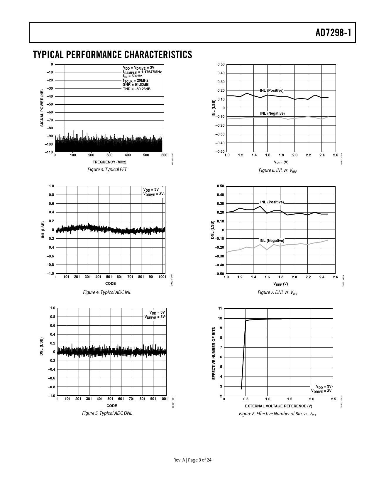

AD7298-1. TYPICAL PERFORMANCE CHARACTERISTICS. 0.50. VDD = VDRIVE = 3V. –10. fSAMPLE = 1.17647MHz. 0.40. fIN = 50kHz. –20. fSCLK = 20MHz
AD7298-1 TYPICAL PERFORMANCE CHARACTERISTICS 0.50 VDD = VDRIVE = 3V –10 fSAMPLE = 1.17647MHz 0.40 fIN = 50kHz –20 fSCLK = 20MHz
AD7298-1 TYPICAL PERFORMANCE CHARACTERISTICS 0 0.50 VDD = VDRIVE = 3V –10 fSAMPLE = 1.17647MHz 0.40 fIN = 50kHz –20 fSCLK = 20MHz 0.30 SNR = 61.83dB –30 ) THD = –80.23dB 0.20 INL (Positive) dB ( –40 R ) 0.10 –50 SB OWE 0 (L –60 L L P INL (Negative) A IN –0.10 –70 IGN S –0.20 –80 –0.30 –90 –100 –0.40 –110 –0.50 0 100 200 300 400 500 600

09321- Figure 3. Typical FFT Figure 6. INL vs. VREF

09321- Figure 4. Typical ADC INL Figure 7. DNL vs. VREF

09321- Figure 5. Typical ADC DNL Figure 8. Effective Number of Bits vs. VREF Rev. A | Page 9 of 24 Document Outline Features Functional Block Diagram General Description Product Highlights Revision History Specifications Timing Specifications Absolute Maximum Ratings Thermal Resistance ESD Caution Pin Configuration and Function Description Typical Performance Characteristics Terminology Circuit Information Converter Operation Analog Input ADC Transfer Function VDRIVE The Internal or External Reference Control Register Modes of Operation Traditional Multichannel Mode of Operation Repeat Operation Power-Down Modes Normal Mode Partial Power-Down Mode Full Power-Down Mode Powering Up the AD7298-1 Reset Serial Interface Layout and Configuration Outline Dimensions Ordering Guide
