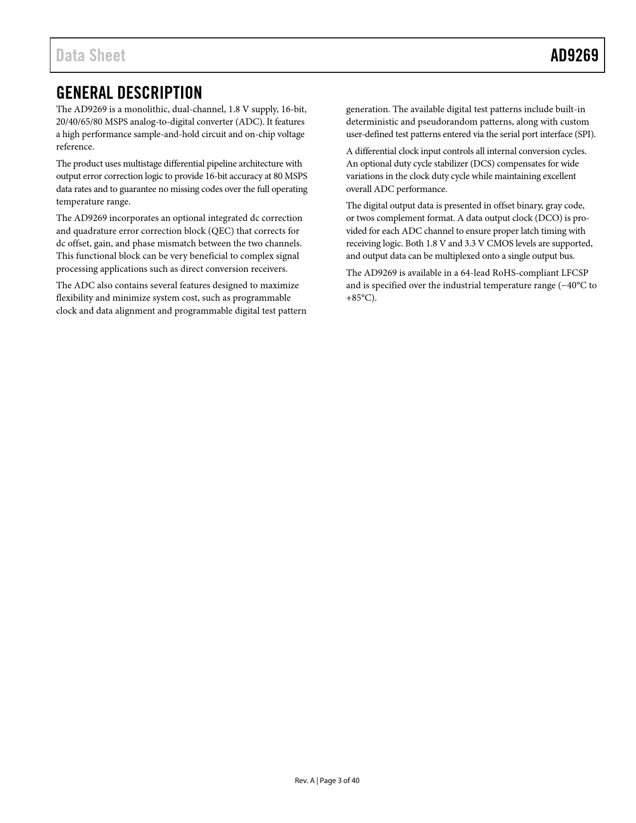

Data Sheet. AD9269. GENERAL DESCRIPTION
Data Sheet AD9269 GENERAL DESCRIPTION
The AD9269 is a monolithic, dual-channel, 1.8 V supply, 16-bit, generation. The available digital test patterns include built-in 20/40/65/80 MSPS analog-to-digital converter (ADC). It features deterministic and pseudorandom patterns, along with custom a high performance sample-and-hold circuit and on-chip voltage user-defined test patterns entered via the serial port interface (SPI). reference. A differential clock input controls al internal conversion cycles. The product uses multistage differential pipeline architecture with An optional duty cycle stabilizer (DCS) compensates for wide output error correction logic to provide 16-bit accuracy at 80 MSPS variations in the clock duty cycle while maintaining excel ent data rates and to guarantee no missing codes over the full operating overal ADC performance. temperature range. The digital output data is presented in offset binary, gray code, The AD9269 incorporates an optional integrated dc correction or twos complement format. A data output clock (DCO) is pro- and quadrature error correction block (QEC) that corrects for vided for each ADC channel to ensure proper latch timing with dc offset, gain, and phase mismatch between the two channels. receiving logic. Both 1.8 V and 3.3 V CMOS levels are supported, This functional block can be very beneficial to complex signal and output data can be multiplexed onto a single output bus. processing applications such as direct conversion receivers. The AD9269 is available in a 64-lead RoHS-compliant LFCSP The ADC also contains several features designed to maximize and is specified over the industrial temperature range (−40°C to flexibility and minimize system cost, such as programmable +85°C). clock and data alignment and programmable digital test pattern Rev. A | Page 3 of 40 Document Outline Features Applications Functional Block Diagram Product Highlights Revision History General Description Specifications DC Specifications AC Specifications Digital Specifications Switching Specifications Timing Specifications Absolute Maximum Ratings Thermal Characteristics ESD Caution Pin Configuration and Function Descriptions Typical Performance Characteristics AD9269-80 AD9269-65 AD9269-40 AD9269-20 Equivalent Circuits Theory of Operation ADC Architecture Analog Input Considerations Input Common Mode Differential Input Configurations Single-Ended Input Configuration Voltage Reference Internal Reference Connection External Reference Operation Clock Input Considerations Clock Input Options Input Clock Divider Clock Duty Cycle Jitter Considerations Power Dissipation and Standby Mode Digital Outputs Digital Output Enable Function (OEB) Timing Data Clock Output (DCO) Built-In Self-Test (BIST) and Output Test Built-In Self-Test (BIST) Output Test Modes Channel/Chip Synchronization DC and Quadrature Error Correction (QEC) LO Leakage (DC) Correction QEC and DC Correction Range Serial Port Interface (SPI) Configuration Using the SPI Hardware Interface Configuration Without the SPI SPI Accessible Features Memory Map Reading the Memory Map Register Table Open Locations Default Values Logic Levels Transfer Register Map Channel-Specific Registers Memory Map Register Table Memory Map Register Descriptions Sync Control (Register 0x100) Bit 1—Clock Divider Sync Enable Bit 0—Master Sync Enable USR2 (Register 0x101) Bit 7—Enable OEB (Pin 47) Bits [6:4]—Open Bit 3—Enable GCLK Detect Bit 2—Run GCLK Bit 1—Open Bit 0—Disable SDIO Pull-Down QEC Control 0 (Register 0x110) Bits[7:6]—Open Bits[5:3]—Freeze DC/Freeze Phase/Freeze Gain Bits[2:0]—DC Enable/Phase Enable/Gain Enable QEC Control 1 (Register 0x111) Bits[7:3]—Open Bit 2—Force DC Bit 1—Force Phase Bit 0—Force Gain QEC Gain Bandwidth Control (Register 0x112) Bits[7:5]—Open Bits[4:0]—KEXP_GAIN QEC Phase Bandwidth Control (Register 0x113) Bits[7:5]—Open Bits[4:0]—KEXP_PHASE QEC DC Bandwidth Control (Register 0x114) Bits[7:5]—Open Bits[4:0]—KEXP_DC QEC Initial Gain 0, QEC Initial Gain 1 (Register 0x116 and Register 0x117) Bits[14:0]—Initial Gain QEC Initial Phase 0, QEC Initial Phase 1 (Register 0x118 and Register 0x119) Bits[12:0]—Initial Phase QEC Initial DC I 0, QEC Initial DC I 1 (Register 0x11A and Register 0x11B) Bits[13:0]—Initial DC I QEC Initial DC Q 0, QEC Initial DC Q 1 (Register 0x11C and Register 0x11D) Bits[13:0]—Initial DC Q Applications Information Design Guidelines Power and Ground Recommendations Exposed Paddle Thermal Heat Sink Recommendations VCM RBIAS Reference Decoupling SPI Port Outline Dimensions Ordering Guide
