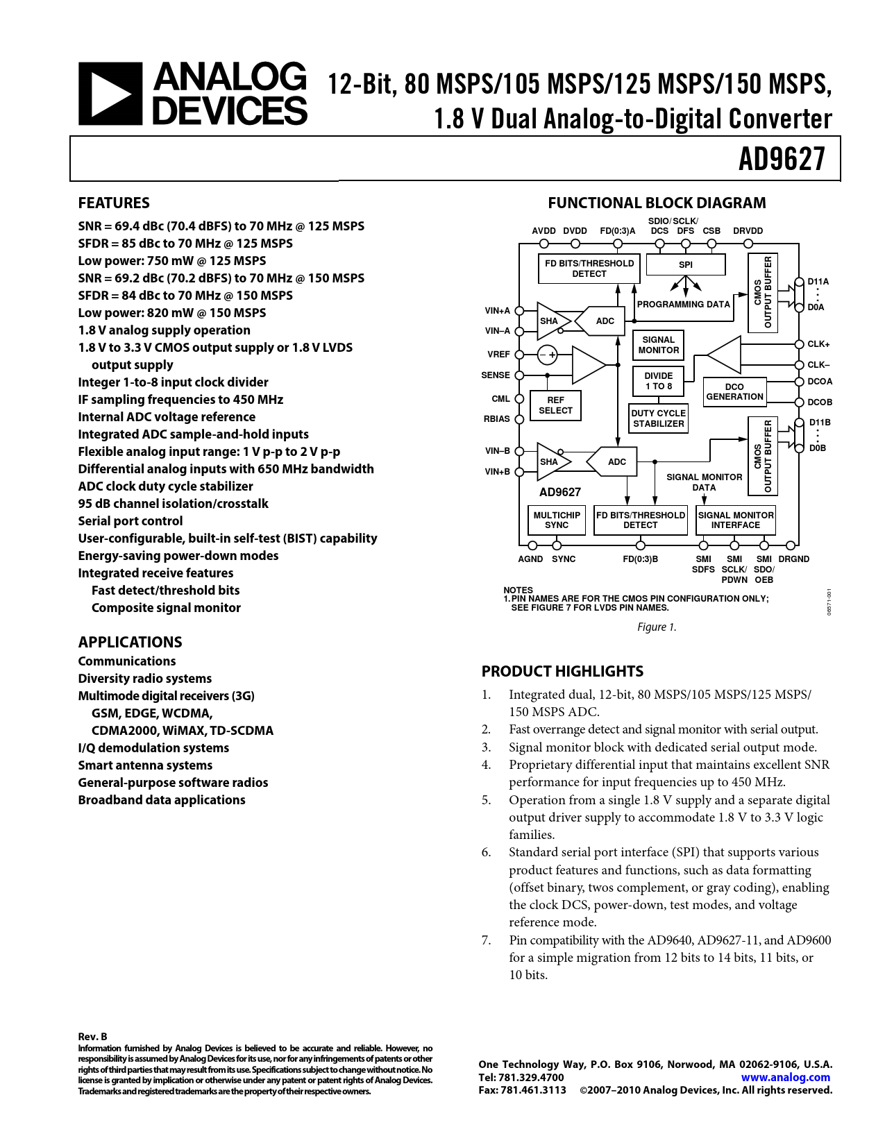

12-Bit, 80 MSPS/105 MSPS/125 MSPS/150 MSPS,. 1.8 V Dual Analog-to-Digital Converter. AD9627. FEATURES. FUNCTIONAL BLOCK DIAGRAM
12-Bit, 80 MSPS/105 MSPS/125 MSPS/150 MSPS, 1.8 V Dual Analog-to-Digital Converter AD9627 FEATURES FUNCTIONAL BLOCK DIAGRAM SNR = 69.4 dBc (70.4 dBFS) to 70 MHz @ 125 MSPS SDIO/ SCLK/ AVDD DVDD FD(0:3)A DCS DFS CSB DRVDD SFDR = 85 dBc to 70 MHz @ 125 MSPS Low power: 750 mW @ 125 MSPS R FD BITS/THRESHOLD SPI SNR = 69.2 dBc (70.2 dBFS) to 70 MHz @ 150 MSPS DETECT FFE S U D11A O SFDR = 84 dBc to 70 MHz @ 150 MSPS B T PROGRAMMING DATA CM U Low power: 820 mW @ 150 MSPS VIN+A P D0A T SHA ADC 1.8 V analog supply operation OU VIN–A SIGNAL 1.8 V to 3.3 V CMOS output supply or 1.8 V LVDS CLK+ MONITOR VREF output supply CLK– SENSE DIVIDE Integer 1-to-8 input clock divider DCOA 1 TO 8 DCO IF sampling frequencies to 450 MHz CML REF GENERATION DCOB SELECT Internal ADC voltage reference DUTY CYCLE RBIAS STABILIZER R D11B Integrated ADC sample-and-hold inputs E F Flexible analog input range: 1 V p-p to 2 V p-p S VIN–B D0B O BUF SHA ADC Differential analog inputs with 650 MHz bandwidth CM UT VIN+B P SIGNAL MONITOR ADC clock duty cycle stabilizer UT DATA O AD9627 95 dB channel isolation/crosstalk MULTICHIP FD BITS/THRESHOLD SIGNAL MONITOR Serial port control SYNC DETECT INTERFACE User-configurable, built-in self-test (BIST) capability Energy-saving power-down modes AGND SYNC FD(0:3)B SMI SMI SMI DRGND Integrated receive features SDFS SCLK/ SDO/ PDWN OEB Fast detect/threshold bits NOTES
001
1. PIN NAMES ARE FOR THE CMOS PIN CONFIGURATION ONLY; Composite signal monitor SEE FIGURE 7 FOR LVDS PIN NAMES.
06571- Figure 1.
APPLICATIONS Communications PRODUCT HIGHLIGHTS Diversity radio systems Multimode digital receivers (3G)
1. Integrated dual, 12-bit, 80 MSPS/105 MSPS/125 MSPS/
GSM, EDGE, WCDMA,
150 MSPS ADC.
CDMA2000, WiMAX, TD-SCDMA
2. Fast overrange detect and signal monitor with serial output.
I/Q demodulation systems
3. Signal monitor block with dedicated serial output mode.
Smart antenna systems
4. Proprietary differential input that maintains excellent SNR
General-purpose software radios
performance for input frequencies up to 450 MHz.
Broadband data applications
5. Operation from a single 1.8 V supply and a separate digital output driver supply to accommodate 1.8 V to 3.3 V logic families. 6. Standard serial port interface (SPI) that supports various product features and functions, such as data formatting (offset binary, twos complement, or gray coding), enabling the clock DCS, power-down, test modes, and voltage reference mode. 7. Pin compatibility with the AD9640, AD9627-11, and AD9600 for a simple migration from 12 bits to 14 bits, 11 bits, or 10 bits.
