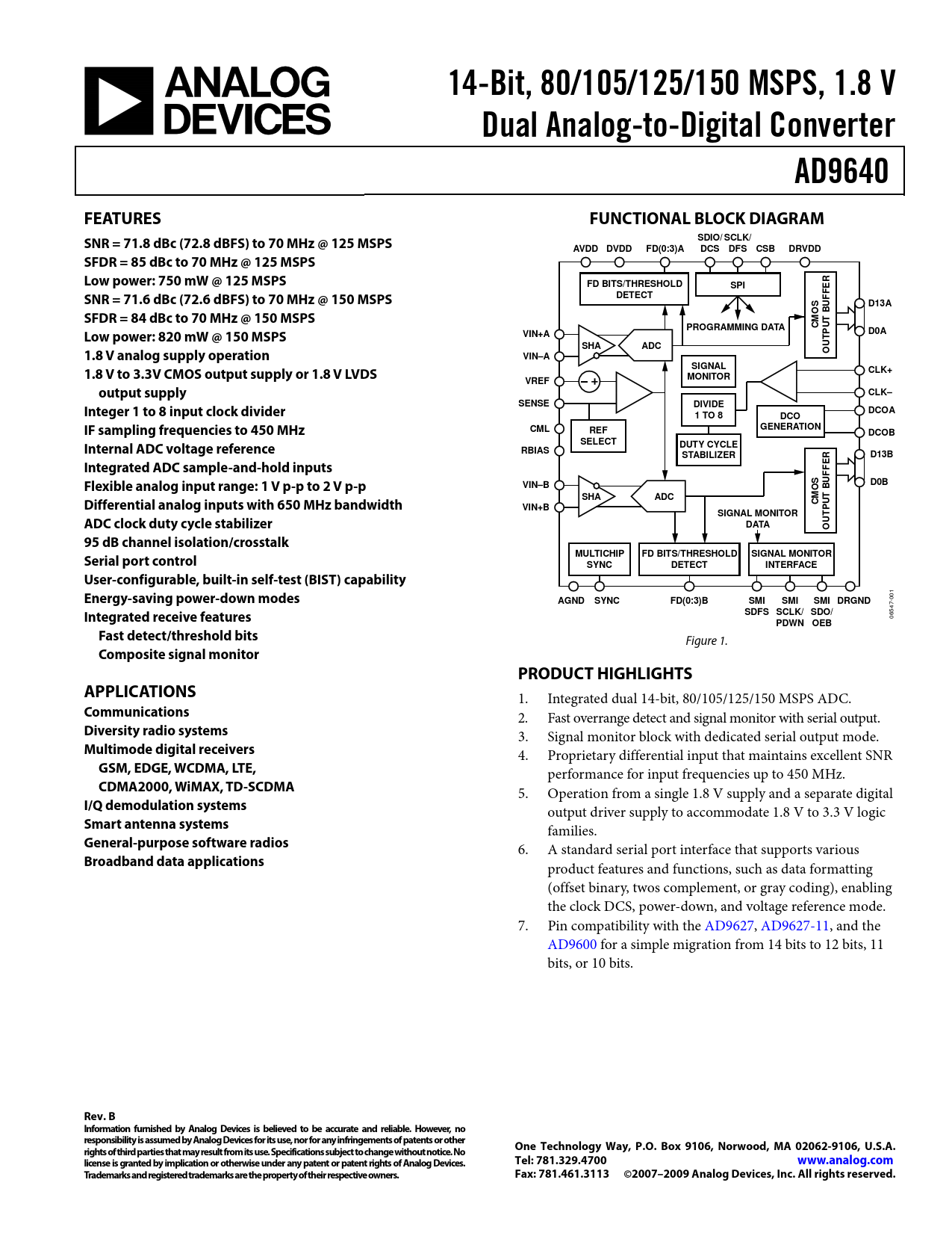

14-Bit, 80/105/125/150 MSPS, 1.8 V. Dual Analog-to-Digital Converter. AD9640. FEATURES. FUNCTIONAL BLOCK DIAGRAM
Datasheet AD9640 Analog Devices, Revision: B
14-Bit, 80/105/125/150 MSPS, 1.8 V Dual Analog-to-Digital Converter AD9640 FEATURES FUNCTIONAL BLOCK DIAGRAM SNR = 71.8 dBc (72.8 dBFS) to 70 MHz @ 125 MSPS SDIO/ SCLK/ AVDD DVDD FD(0:3)A DCS DFS CSB DRVDD SFDR = 85 dBc to 70 MHz @ 125 MSPS Low power: 750 mW @ 125 MSPS R FD BITS/THRESHOLD SPI E F SNR = 71.6 dBc (72.6 dBFS) to 70 MHz @ 150 MSPS DETECT F S D13A O BU SFDR = 84 dBc to 70 MHz @ 150 MSPS PROGRAMMING DATA CM UT P D0A Low power: 820 mW @ 150 MSPS VIN+A SHA ADC UT 1.8 V analog supply operation O VIN–A SIGNAL 1.8 V to 3.3V CMOS output supply or 1.8 V LVDS CLK+ MONITOR VREF output supply CLK– SENSE DIVIDE Integer 1 to 8 input clock divider DCOA 1 TO 8 DCO IF sampling frequencies to 450 MHz CML REF GENERATION DCOB SELECT Internal ADC voltage reference DUTY CYCLE RBIAS STABILIZER R D13B E Integrated ADC sample-and-hold inputs F S Flexible analog input range: 1 V p-p to 2 V p-p VIN–B D0B O BUF SHA ADC Differential analog inputs with 650 MHz bandwidth CM UT VIN+B P SIGNAL MONITOR T ADC clock duty cycle stabilizer U DATA O 95 dB channel isolation/crosstalk MULTICHIP FD BITS/THRESHOLD SIGNAL MONITOR Serial port control SYNC DETECT INTERFACE User-configurable, built-in self-test (BIST) capability Energy-saving power-down modes

Figure 1.
Composite signal monitor PRODUCT HIGHLIGHTS APPLICATIONS
1. Integrated dual 14-bit, 80/105/125/150 MSPS ADC.
Communications
2. Fast overrange detect and signal monitor with serial output.
Diversity radio systems
3. Signal monitor block with dedicated serial output mode.
Multimode digital receivers
4. Proprietary differential input that maintains excellent SNR
GSM, EDGE, WCDMA, LTE,
performance for input frequencies up to 450 MHz.
CDMA2000, WiMAX, TD-SCDMA
5. Operation from a single 1.8 V supply and a separate digital
I/Q demodulation systems
output driver supply to accommodate 1.8 V to 3.3 V logic
Smart antenna systems
families.
General-purpose software radios
6. A standard serial port interface that supports various
Broadband data applications
product features and functions, such as data formatting (offset binary, twos complement, or gray coding), enabling the clock DCS, power-down, and voltage reference mode. 7. Pin compatibility with the AD9627, AD9627-11, and the AD9600 for a simple migration from 14 bits to 12 bits, 11 bits, or 10 bits.
