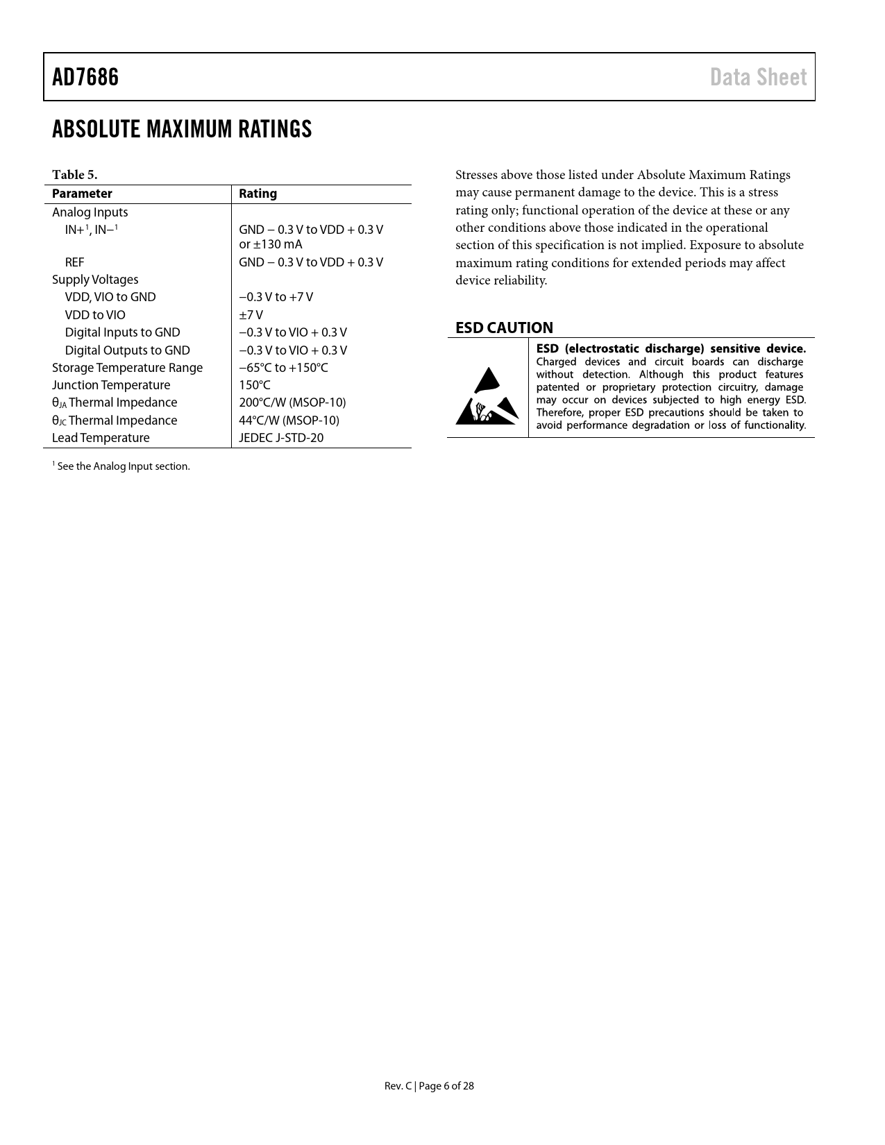

AD7686 Data Sheet ABSOLUTE MAXIMUM RATINGS Table 5.
Stresses above those listed under Absolute Maximum Ratings
Parameter Rating
may cause permanent damage to the device. This is a stress Analog Inputs rating only; functional operation of the device at these or any IN+1, IN−1 GND − 0.3 V to VDD + 0.3 V other conditions above those indicated in the operational or ±130 mA section of this specification is not implied. Exposure to absolute REF GND − 0.3 V to VDD + 0.3 V maximum rating conditions for extended periods may affect Supply Voltages device reliability. VDD, VIO to GND −0.3 V to +7 V VDD to VIO ±7 V Digital Inputs to GND −0.3 V to VIO + 0.3 V
ESD CAUTION
Digital Outputs to GND −0.3 V to VIO + 0.3 V Storage Temperature Range −65°C to +150°C Junction Temperature 150°C θJA Thermal Impedance 200°C/W (MSOP-10) θJC Thermal Impedance 44°C/W (MSOP-10) Lead Temperature JEDEC J-STD-20 1 See the Analog Input section. Rev. C | Page 6 of 28 Document Outline Features Applications Functional Block Diagram General Description Table of Contents Revision History Specifications Timing Specifications Absolute Maximum Ratings ESD Caution Pin Configurations and Function Descriptions Terminology Typical Performance Characteristics Theory of Operation Circuit Information Converter Operation Transfer Functions Typical Connection Diagram Analog Input Driver Amplifier Choice Voltage Reference Input Power Supply Supplying the ADC from the Reference Digital Interface CS/ MODE 3-Wire, No Busy Indicator CS/ Mode 3-Wire with Busy Indicator CS/ Mode 4-Wire, No Busy Indicator CS/ Mode 4-Wire with Busy Indicator Chain Mode, No Busy Indicator Chain Mode with Busy Indicator Application Hints Layout Evaluating the Performance of the AD7686 True 16-Bit Isolated Application Example Outline Dimensions Ordering Guide
