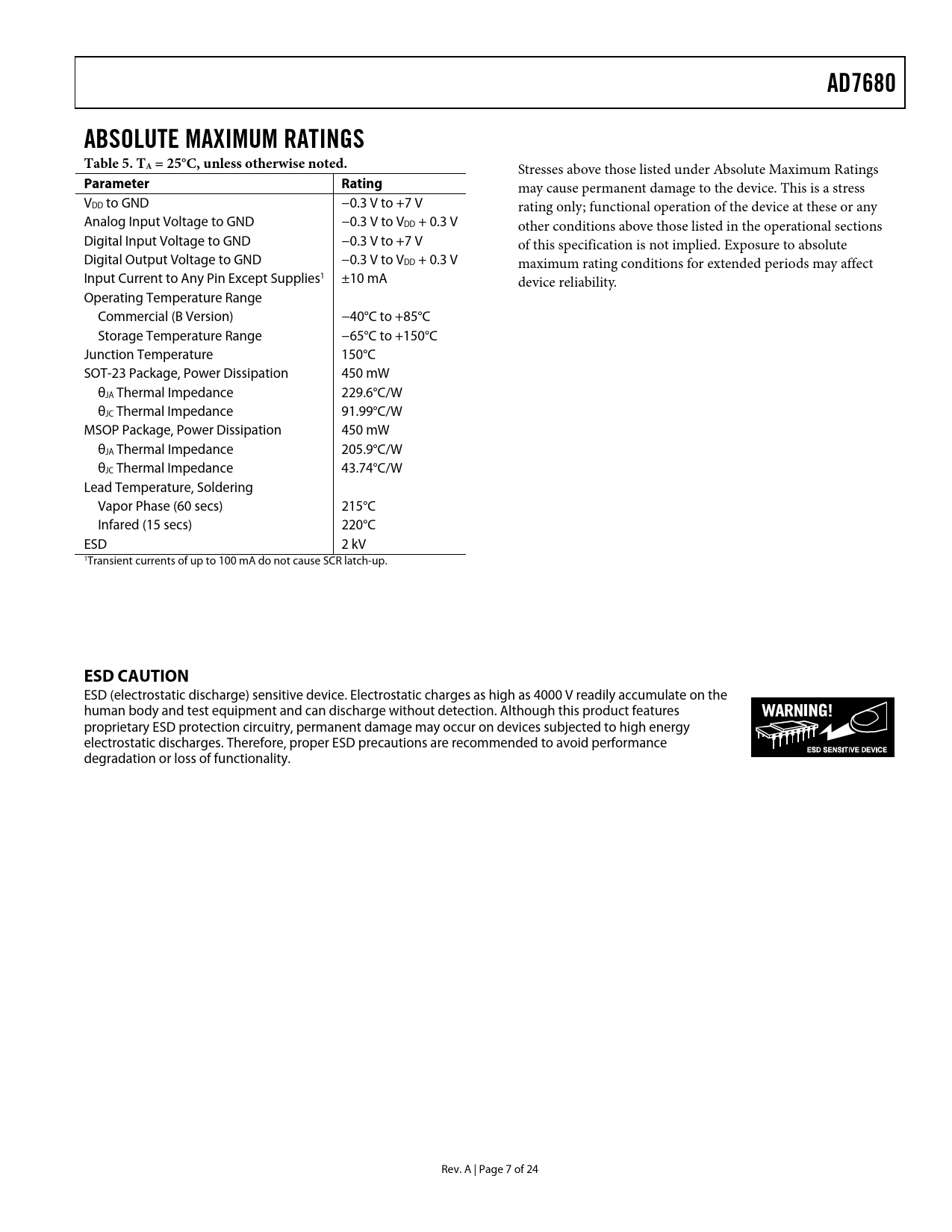

AD7680 ABSOLUTE MAXIMUM RATINGS Table 5. TA = 25°C, unless otherwise noted.
Stresses above those listed under Absolute Maximum Ratings
Parameter Rating
may cause permanent damage to the device. This is a stress VDD to GND −0.3 V to +7 V rating only; functional operation of the device at these or any Analog Input Voltage to GND −0.3 V to VDD + 0.3 V other conditions above those listed in the operational sections Digital Input Voltage to GND −0.3 V to +7 V of this specification is not implied. Exposure to absolute Digital Output Voltage to GND −0.3 V to VDD + 0.3 V maximum rating conditions for extended periods may affect Input Current to Any Pin Except Supplies1 ±10 mA device reliability. Operating Temperature Range Commercial (B Version) −40°C to +85°C Storage Temperature Range −65°C to +150°C Junction Temperature 150°C SOT-23 Package, Power Dissipation 450 mW θJA Thermal Impedance 229.6°C/W θ JC Thermal Impedance 91.99°C/W MSOP Package, Power Dissipation 450 mW θJA Thermal Impedance 205.9°C/W θJC Thermal Impedance 43.74°C/W Lead Temperature, Soldering Vapor Phase (60 secs) 215°C Infared (15 secs) 220°C ESD 2 kV 1Transient currents of up to 100 mA do not cause SCR latch-up.
ESD CAUTION
ESD (electrostatic discharge) sensitive device. Electrostatic charges as high as 4000 V readily accumulate on the human body and test equipment and can discharge without detection. Although this product features proprietary ESD protection circuitry, permanent damage may occur on devices subjected to high energy electrostatic discharges. Therefore, proper ESD precautions are recommended to avoid performance degradation or loss of functionality. Rev. A | Page 7 of 24 Document Outline SPECIFICATIONS SPECIFICATIONS TIMING SPECIFICATIONS ABSOLUTE MAXIMUM RATINGS ESD CAUTION PIN CONFIGURATIONS AND FUNCTION DESCRIPTIONS TERMINOLOGY TYPICAL PERFORMANCE CHARACTERISTICS CIRCUIT INFORMATION CONVERTER OPERATION ANALOG INPUT ADC TRANSFER FUNCTION TYPICAL CONNECTION DIAGRAM Digital Inputs MODES OF OPERATION NORMAL MODE POWER-DOWN MODE POWER VS. THROUGHPUT RATE SERIAL INTERFACE AD7680 TO ADSP-218x APPLICATION HINTS GROUNDING AND LAYOUT OUTLINE DIMENSIONS ORDERING GUIDE
