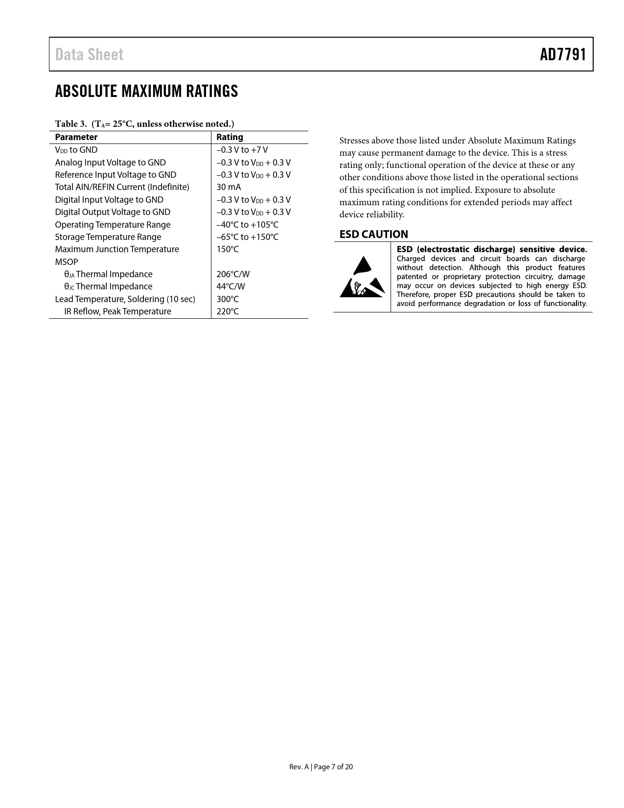

Data Sheet. AD7791. ABSOLUTE MAXIMUM RATINGS. Table 3. (TA= 25°C, unless otherwise noted.) Parameter Rating. ESD CAUTION
Data Sheet AD7791 ABSOLUTE MAXIMUM RATINGS Table 3 (TA= 25°C, unless otherwise noted.) Parameter Rating ESD CAUTION
Data Sheet AD7791 ABSOLUTE MAXIMUM RATINGS Table 3. (TA= 25°C, unless otherwise noted.) Parameter Rating
Stresses above those listed under Absolute Maximum Ratings VDD to GND –0.3 V to +7 V may cause permanent damage to the device. This is a stress Analog Input Voltage to GND –0.3 V to VDD + 0.3 V rating only; functional operation of the device at these or any Reference Input Voltage to GND –0.3 V to VDD + 0.3 V other conditions above those listed in the operational sections Total AIN/REFIN Current (Indefinite) 30 mA of this specification is not implied. Exposure to absolute Digital Input Voltage to GND –0.3 V to VDD + 0.3 V maximum rating conditions for extended periods may affect Digital Output Voltage to GND –0.3 V to VDD + 0.3 V device reliability. Operating Temperature Range –40°C to +105°C Storage Temperature Range –65°C to +150°C
ESD CAUTION
Maximum Junction Temperature 150°C MSOP θJA Thermal Impedance 206°C/W θJC Thermal Impedance 44°C/W Lead Temperature, Soldering (10 sec) 300°C IR Reflow, Peak Temperature 220°C Rev. A | Page 7 of 20 Document Outline AD7791—Specifications Timing Characteristics Absolute Maximum Ratings ESD Caution Pin Configuration and Function Descriptions Typical Performance Characteristics On-chip Registers Communications Register (RS1, RS0 = 0, 0) Status Register (RS1, RS0 = 0, 0; Power-on/Reset = 0x8C) Mode Register (RS1, RS0 = 0, 1; Power-on/Reset = 0x02) Filter Register (RS1, RS0 = 1, 0; Power-on/Reset = 0x04) Data Register (RS1, RS0 = 1, 1; Power-on/Reset = 0x000000) ADC Circuit Information Overview Noise Performance Reduced Current Modes Digital Interface Single Conversion Mode Continuous Conversion Mode Continuous Read Mode Circuit Description Analog Input Channel Bipolar/Unipolar Configuration Data Output Coding Reference Input VDD Monitor Grounding and Layout Outline Dimensions Ordering Guide
