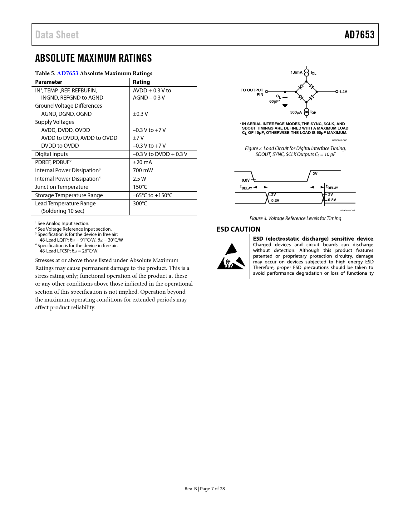

Data Sheet AD7653 ABSOLUTE MAXIMUM RATINGS Table 5. AD7653 Absolute M aximum Ratings 1.6mA IOL Parameter Rating
IN1, TEMP1,REF, REFBUFIN, AVDD + 0.3 V to
TO OUTPUT 1.4V PIN
INGND, REFGND to AGND AGND – 0.3 V
CL 60pF*
Ground Voltage Differences AGND, DGND, OGND ±0.3 V
500
A IOH
Supply Voltages
* IN SERIAL INTERFACE MODES,THE SYNC, SCLK, AND
AVDD, DVDD, OVDD –0.3 V to +7 V
SDOUT TIMINGS ARE DEFINED WITH A MAXIMUM LOAD CL OF 10pF; OTHERWISE,THE LOAD IS 60pF MAXIMUM.
AVDD to DVDD, AVDD to OVDD ±7 V 02966-0-006 DVDD to OVDD –0.3 V to +7 V Figure 2. Load Circuit for Digital Interface Timing, Digital Inputs –0.3 V to DVDD + 0.3 V SDOUT, SYNC, SCLK Outputs CL = 10 pF PDREF, PDBUF2 ±20 mA Internal Power Dissipation3 700 mW
2V
Internal Power Dissipation4 2.5 W
0.8V
Junction Temperature 150°C
t t DELAY DELAY
Storage Temperature Range –65°C to +150°C
2V 2V 0.8V 0.8V
Lead Temperature Range 300°C (Soldering 10 sec) 02966-0-007 Figure 3. Voltage Reference Levels for Timing 1 See Analog Input section. 2 See Voltage Reference Input section.

3 Specification is for the device in free air: 48-Lead LQFP; θJA = 91°C/W, θJC = 30°C/W 4 Specification is for the device in free air: 48-Lead LFCSP; θJA = 26°C/W. Stresses at or above those listed under Absolute Maximum Ratings may cause permanent damage to the product. This is a stress rating only; functional operation of the product at these or any other conditions above those indicated in the operational section of this specification is not implied. Operation beyond the maximum operating conditions for extended periods may affect product reliability. Rev. B | Page 7 of 28 Document Outline Features Applications General Description Functional Block Diagram Product Hightlights Revision History Specifications Timing Specifications Absolute Maximum Ratings ESD Caution Pin Configuration and Function Descriptions Definitions of Specifications Integral Nonlinearity Error (INL) Differential Nonlinearity Error (DNL) Full-Scale Error Unipolar Zero Error Spurious-Free Dynamic Range (SFDR) Effective Number of Bits (ENOB) Total Harmonic Distortion (THD) Signal-to-Noise Ratio (SNR) Signal-to-(Noise + Distortion) Ratio (S/[N+D]) Aperture Delay Transient Response Overvoltage Recovery Reference Voltage Temperature Coefficient Typical Performance Characteristics Circuit Information Converter Operation Modes of Operation Transfer Functions Typical Connection Diagram Analog Input Driver Amplifier Choice Voltage Reference Input Power Supply Power Dissipation vs. Throughput Conversion Control Digital Interface Parallel Interface Serial Interface Master Serial Interface Internal Clock Slave Serial Interface External Clock External Discontinuous Clock Data Read After Conversion External Clock Data Read During Conversion Microprocessor Interfacing SPI Interface (ADSP-2191M) Application Hints Bipolar and Wider Input Ranges Layout Outline Dimensions Ordering Guide
