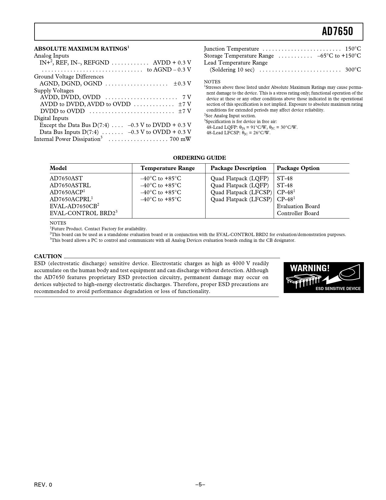

AD7650 ABSOLUTE MAXIMUM RATINGS1
Junction Temperature . 150°C Analog Inputs Storage Temperature Range . –65°C to +150°C IN+2, REF, IN–, REFGND . AVDD + 0.3 V Lead Temperature Range . to AGND – 0.3 V (Soldering 10 sec) . 300°C Ground Voltage Differences AGND, DGND, OGND . ± 0.3 V NOTES 1Stresses above those listed under Absolute Maximum Ratings may cause perma- Supply Voltages nent damage to the device. This is a stress rating only; functional operation of the AVDD, DVDD, OVDD . 7 V device at these or any other conditions above those indicated in the operational AVDD to DVDD, AVDD to OVDD . ± 7 V section of this specification is not implied. Exposure to absolute maximum rating DVDD to OVDD . ± 7 V conditions for extended periods may affect device reliability. 2 Digital Inputs See Analog Input section. 3Specification is for device in free air: Except the Data Bus D(7:4) . –0.3 V to DVDD + 0.3 V 48-Lead LQFP: θJA = 91°C/W, θJC = 30°C/W. Data Bus Inputs D(7:4) . –0.3 V to OVDD + 0.3 V 48-Lead LFCSP: θJC = 26°C/W. Internal Power Dissipation3 . 700 mW
ORDERING GUIDE Model Temperature Range Package Description Package Option
AD7650AST –40°C to +85°C Quad Flatpack (LQFP) ST-48 AD7650ASTRL –40°C to +85°C Quad Flatpack (LQFP) ST-48 AD7650ACP1 –40°C to +85°C Quad Flatpack (LFCSP) CP-481 AD7650ACPRL1 –40°C to +85°C Quad Flatpack (LFCSP) CP-481 EVAL-AD7650CB2 Evaluation Board EVAL-CONTROL BRD23 Controller Board NOTES 1Future Product. Contact Factory for availability. 2This board can be used as a standalone evaluation board or in conjunction with the EVAL-CONTROL BRD2 for evaluation/demonstration purposes. 3This board allows a PC to control and communicate with all Analog Devices evaluation boards ending in the CB designator.
