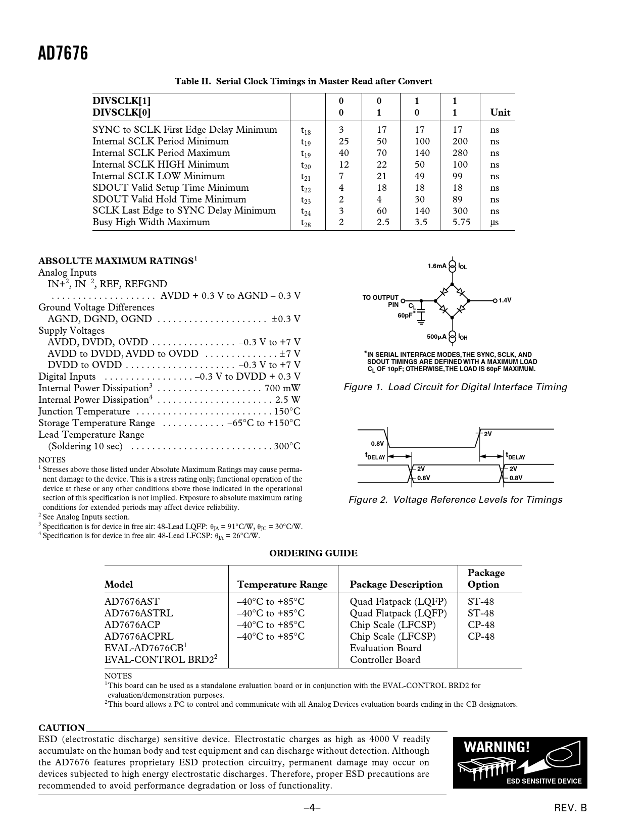

AD7676. Table II. Serial Clock Timings in Master Read after Convert. DIVSCLK[1]. DIVSCLK[0]. Unit. ABSOLUTE MAXIMUM RATINGS1. 1.6mA
AD7676 Table II Serial Clock Timings in Master Read after Convert DIVSCLK[1] DIVSCLK[0] Unit ABSOLUTE MAXIMUM RATINGS1 1.6mA
AD7676 Table II. Serial Clock Timings in Master Read after Convert DIVSCLK[1] 0 0 1 1 DIVSCLK[0] 0 1 0 1 Unit
SYNC to SCLK First Edge Delay Minimum t18 3 17 17 17 ns Internal SCLK Period Minimum t19 25 50 100 200 ns Internal SCLK Period Maximum t19 40 70 140 280 ns Internal SCLK HIGH Minimum t20 12 22 50 100 ns Internal SCLK LOW Minimum t21 7 21 49 99 ns SDOUT Valid Setup Time Minimum t22 4 18 18 18 ns SDOUT Valid Hold Time Minimum t23 2 4 30 89 ns SCLK Last Edge to SYNC Delay Minimum t24 3 60 140 300 ns Busy High Width Maximum t28 2 2.5 3.5 5.75 µs
ABSOLUTE MAXIMUM RATINGS1 1.6mA IOL
Analog Inputs IN+2, IN–2, REF, REFGND . AVDD + 0.3 V to AGND – 0.3 V
TO OUTPUT 1.4V
Ground Voltage Differences
PIN CL
AGND, DGND, OGND . ± 0.3 V
60pF*
Supply Voltages
500 A I
AVDD, DVDD, OVDD . –0.3 V to +7 V
OH
AVDD to DVDD, AVDD to OVDD . ± 7 V
IN SERIAL INTERF * ACE MODES, THE SYNC, SCLK, AND
DVDD to OVDD . –0.3 V to +7 V
SDOUT TIMINGS ARE DEFINED WITH A MAXIMUM LOAD CL OF 10pF; OTHERWISE, THE LOAD IS 60pF MAXIMUM.
Digital Inputs . –0.3 V to DVDD + 0.3 V Internal Power Dissipation3 . 700 mW Figure 1. Load Circuit for Digital Interface Timing Internal Power Dissipation4 . 2.5 W Junction Temperature . 150°C Storage Temperature Range . –65°C to +150°C Lead Temperature Range
2V
(Soldering 10 sec) . 300°C
0.8V t t
NOTES
DELAY DELAY
1 Stresses above those listed under Absolute Maximum Ratings may cause perma-
2V 2V
nent damage to the device. This is a stress rating only; functional operation of the
0.8V 0.8V
device at these or any other conditions above those indicated in the operational section of this specification is not implied. Exposure to absolute maximum rating Figure 2. Voltage Reference Levels for Timings conditions for extended periods may affect device reliability. 2 See Analog Inputs section. 3 Specification is for device in free air: 48-Lead LQFP: ␪JA = 91°C/W, ␪JC = 30°C/W. 4 Specification is for device in free air: 48-Lead LFCSP: ␪JA = 26°C/W.
