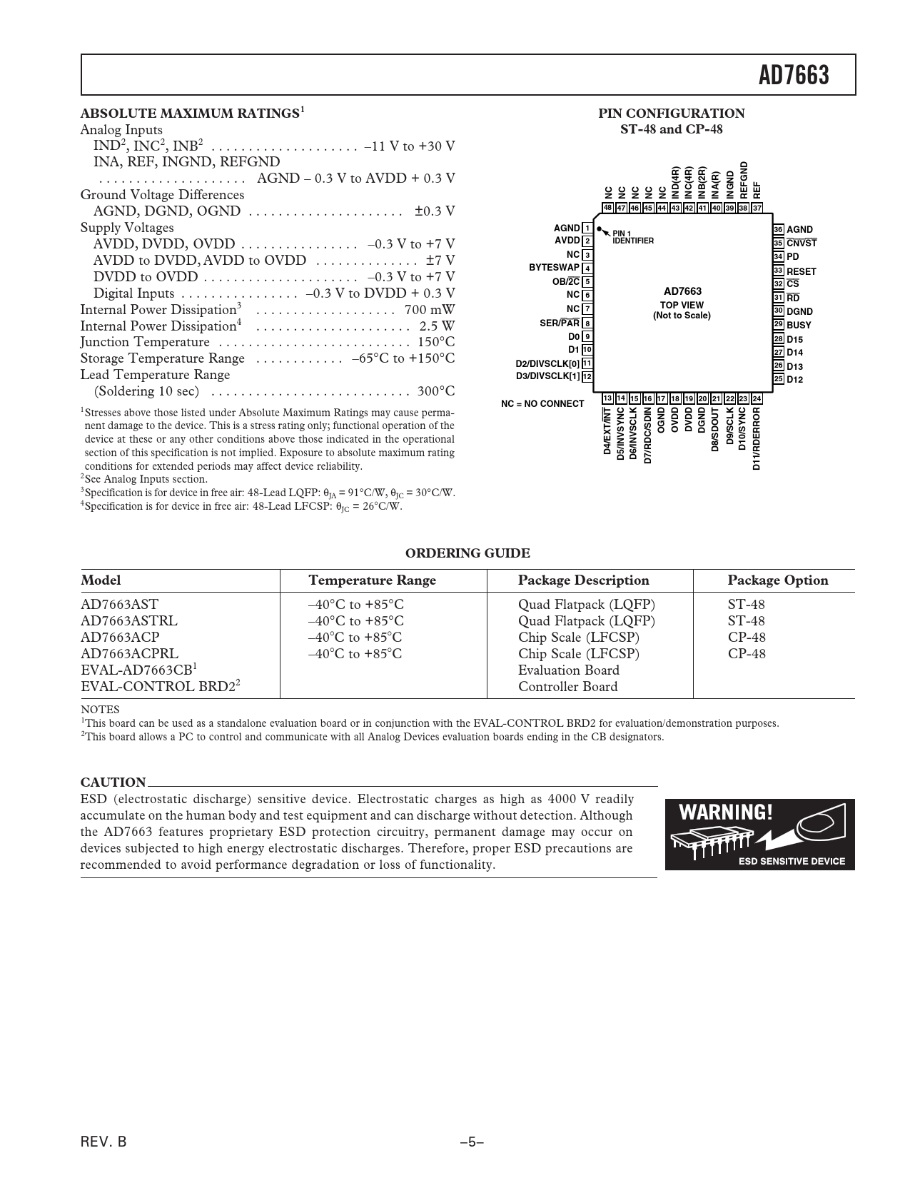

AD7663. ABSOLUTE MAXIMUM RATINGS1. PIN CONFIGURATION. ST-48 and CP-48. IND(4R). INC(4R). INB(2R). INA(R). INGND. REFGND. REF
AD7663 ABSOLUTE MAXIMUM RATINGS1 PIN CONFIGURATION ST-48 and CP-48 IND(4R) INC(4R) INB(2R) INA(R) INGND REFGND REF
Analog Inputs
ST-48 and CP-48
IND2, INC2, INB2 . –11 V to +30 V INA, REF, INGND, REFGND . AGND – 0.3 V to AVDD + 0.3 V Ground Voltage Differences
NC NC NC NC NC IND(4R) INC(4R) INB(2R) INA(R) INGND REFGND REF 48 47 46 45 44 43 42 41 40 39 38 37
AGND, DGND, OGND . ±0.3 V Supply Voltages
AGND 1 36 PIN 1 AGND AVDD 2 IDENTIFIER 35 CNVST
AVDD, DVDD, OVDD . –0.3 V to +7 V
NC 3 34 PD
AVDD to DVDD, AVDD to OVDD . ±7 V
BYTESWAP 4 33 RESET
DVDD to OVDD . –0.3 V to +7 V
OB/2C 5 32 CS
Digital Inputs . –0.3 V to DVDD + 0.3 V
NC 6 AD7663 31 RD NC 7 TOP VIEW
Internal Power Dissipation3 . 700 mW
30 (Not to Scale) DGND SER/PAR 8 29 BUSY
Internal Power Dissipation4 . 2.5 W
D0 9 28 D15
Junction Temperature . 150°C
D1 10 27 D14
Storage Temperature Range . –65°C to +150°C
D2/DIVSCLK[0] 11 26 D13
Lead Temperature Range
D3/DIVSCLK[1] 12 25 D12
(Soldering 10 sec) . 300°C
13 14 15 16 17 18 19 20 21 22 23 24 NC = NO CONNECT
1Stresses above those listed under Absolute Maximum Ratings may cause perma-
INT
nent damage to the device. This is a stress rating only; functional operation of the
OGND OVDD DVDD DGND
device at these or any other conditions above those indicated in the operational
D9/SCLK D10/SYNC
section of this specification is not implied. Exposure to absolute maximum rating
D4/EXT/ D8/SDOUT D5/INVSYNC D6/INVSCLK D7/RDC/SDIN
conditions for extended periods may affect device reliability.
D11/RDERROR
2See Analog Inputs section. 3Specification is for device in free air: 48-Lead LQFP: qJA = 91°C/W, qJC = 30°C/W. 4Specification is for device in free air: 48-Lead LFCSP: qJC = 26⬚C/W.
