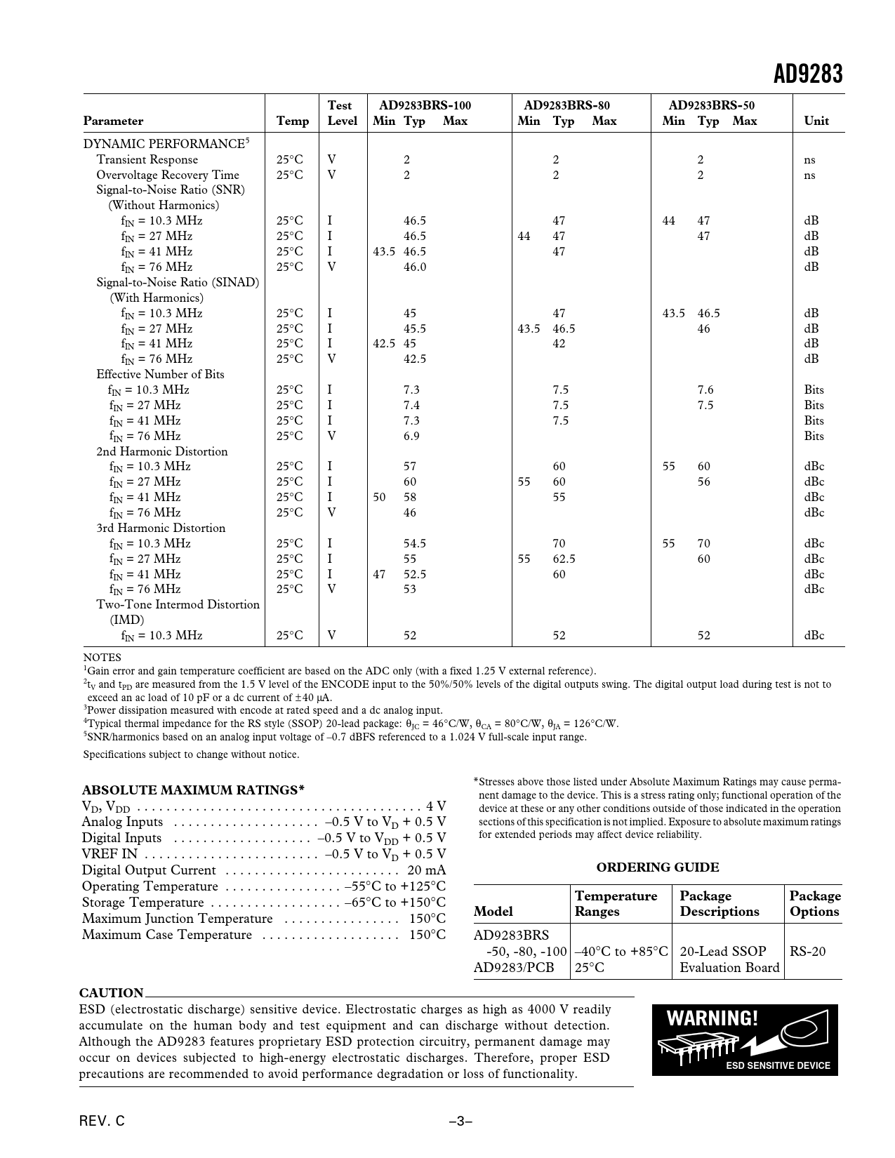

AD9283. Test. AD9283BRS-100. AD9283BRS-80. AD9283BRS-50. Parameter. Temp. Level. Min Typ. Max. Min. Typ. Unit. ABSOLUTE MAXIMUM RATINGS*
AD9283 Test AD9283BRS-100 AD9283BRS-80 AD9283BRS-50 Parameter Temp Level Min Typ Max Min Typ Unit ABSOLUTE MAXIMUM RATINGS*
AD9283 Test AD9283BRS-100 AD9283BRS-80 AD9283BRS-50 Parameter Temp Level Min Typ Max Min Typ Max Min Typ Max Unit
DYNAMIC PERFORMANCE5 Transient Response 25°C V 2 2 2 ns Overvoltage Recovery Time 25°C V 2 2 2 ns Signal-to-Noise Ratio (SNR) (Without Harmonics) fIN = 10.3 MHz 25°C I 46.5 47 44 47 dB fIN = 27 MHz 25°C I 46.5 44 47 47 dB fIN = 41 MHz 25°C I 43.5 46.5 47 dB fIN = 76 MHz 25°C V 46.0 dB Signal-to-Noise Ratio (SINAD) (With Harmonics) fIN = 10.3 MHz 25°C I 45 47 43.5 46.5 dB fIN = 27 MHz 25°C I 45.5 43.5 46.5 46 dB fIN = 41 MHz 25°C I 42.5 45 42 dB fIN = 76 MHz 25°C V 42.5 dB Effective Number of Bits fIN = 10.3 MHz 25°C I 7.3 7.5 7.6 Bits fIN = 27 MHz 25°C I 7.4 7.5 7.5 Bits fIN = 41 MHz 25°C I 7.3 7.5 Bits fIN = 76 MHz 25°C V 6.9 Bits 2nd Harmonic Distortion fIN = 10.3 MHz 25°C I 57 60 55 60 dBc fIN = 27 MHz 25°C I 60 55 60 56 dBc fIN = 41 MHz 25°C I 50 58 55 dBc fIN = 76 MHz 25°C V 46 dBc 3rd Harmonic Distortion fIN = 10.3 MHz 25°C I 54.5 70 55 70 dBc fIN = 27 MHz 25°C I 55 55 62.5 60 dBc fIN = 41 MHz 25°C I 47 52.5 60 dBc fIN = 76 MHz 25°C V 53 dBc Two-Tone Intermod Distortion (IMD) fIN = 10.3 MHz 25°C V 52 52 52 dBc NOTES 1Gain error and gain temperature coefficient are based on the ADC only (with a fixed 1.25 V external reference). 2tV and tPD are measured from the 1.5 V level of the ENCODE input to the 50%/50% levels of the digital outputs swing. The digital output load during test is not to exceed an ac load of 10 pF or a dc current of ± 40 µA. 3Power dissipation measured with encode at rated speed and a dc analog input. 4Typical thermal impedance for the RS style (SSOP) 20-lead package: θJC = 46°C/W, θCA = 80°C/W, θJA = 126°C/W. 5SNR/harmonics based on an analog input voltage of –0.7 dBFS referenced to a 1.024 V full-scale input range. Specifications subject to change without notice. *Stresses above those listed under Absolute Maximum Ratings may cause perma-
nent damage to the device. This is a stress rating only; functional operation of the VD, VDD . 4 V device at these or any other conditions outside of those indicated in the operation Analog Inputs . –0.5 V to VD + 0.5 V sections of this specification is not implied. Exposure to absolute maximum ratings Digital Inputs . –0.5 V to V for extended periods may affect device reliability. DD + 0.5 V VREF IN . –0.5 V to VD + 0.5 V Digital Output Current . 20 mA
ORDERING GUIDE
Operating Temperature . –55°C to +125°C
Temperature Package Package
Storage Temperature . –65°C to +150°C
Model Ranges Descriptions Options
Maximum Junction Temperature . 150°C Maximum Case Temperature . 150°C AD9283BRS -50, -80, -100 –40°C to +85°C 20-Lead SSOP RS-20 AD9283/PCB 25°C Evaluation Board
CAUTION
ESD (electrostatic discharge) sensitive device. Electrostatic charges as high as 4000 V readily
WARNING!
accumulate on the human body and test equipment and can discharge without detection. Although the AD9283 features proprietary ESD protection circuitry, permanent damage may occur on devices subjected to high-energy electrostatic discharges. Therefore, proper ESD
ESD SENSITIVE DEVICE
precautions are recommended to avoid performance degradation or loss of functionality. REV. C –3–
