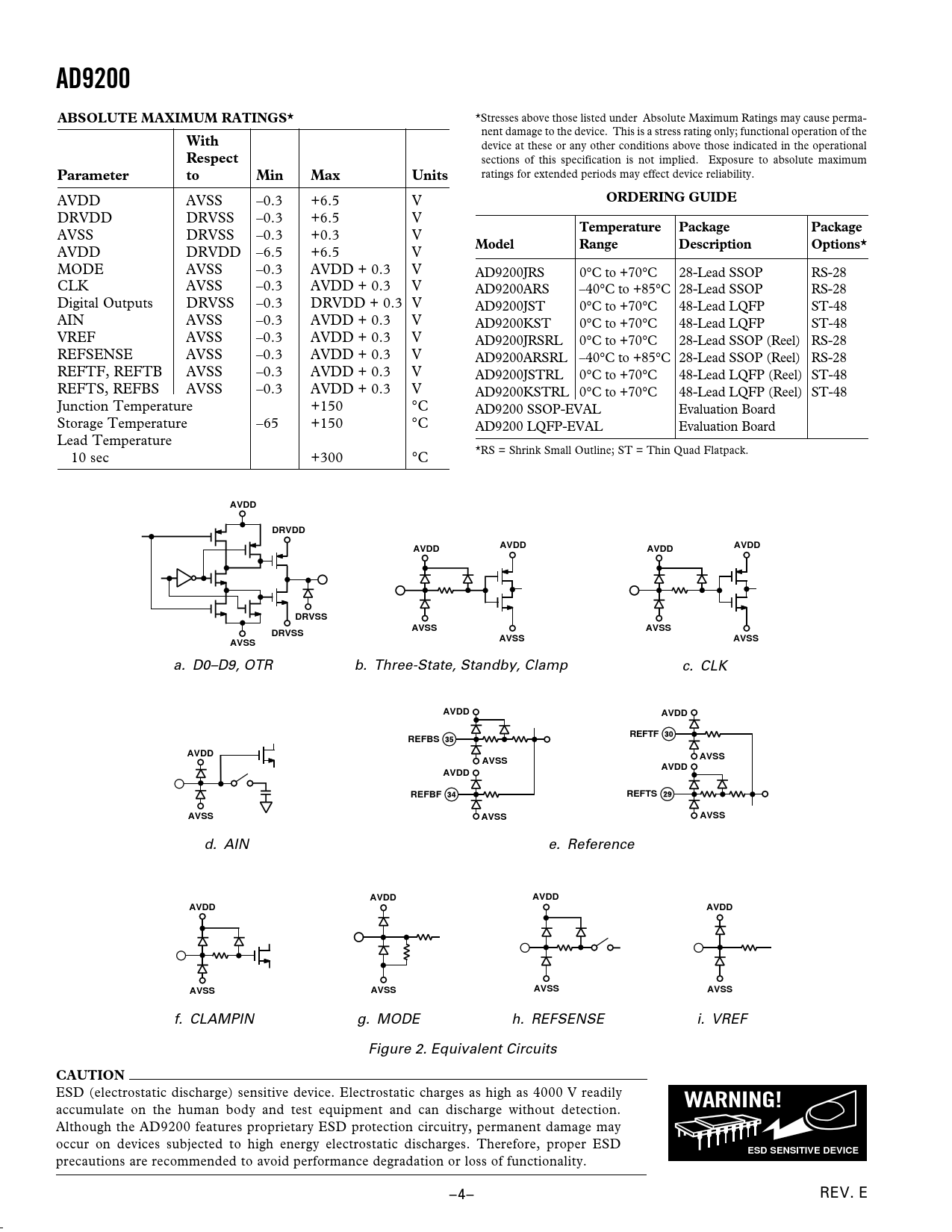

AD9200. ABSOLUTE MAXIMUM RATINGS*. With. Respect. Parameter. Min. Max. Units. ORDERING GUIDE. Temperature. Package. Model. Range. Description
AD9200 ABSOLUTE MAXIMUM RATINGS* With Respect Parameter Min Max Units ORDERING GUIDE Temperature Package Model Range Description
*Stresses above those listed under Absolute Maximum Ratings may cause perma- nent damage to the device. This is a stress rating only; functional operation of the
With
device at these or any other conditions above those indicated in the operational
Respect
sections of this specification is not implied. Exposure to absolute maximum
Parameter to Min Max Units
ratings for extended periods may effect device reliability. AVDD AVSS –0.3 +6.5 V
ORDERING GUIDE
DRVDD DRVSS –0.3 +6.5 V
Temperature Package Package
AVSS DRVSS –0.3 +0.3 V
Model Range Description Options*
AVDD DRVDD –6.5 +6.5 V MODE AVSS –0.3 AVDD + 0.3 V AD9200JRS 0°C to +70°C 28-Lead SSOP RS-28 CLK AVSS –0.3 AVDD + 0.3 V AD9200ARS –40°C to +85°C 28-Lead SSOP RS-28 Digital Outputs DRVSS –0.3 DRVDD + 0.3 V AD9200JST 0°C to +70°C 48-Lead LQFP ST-48 AIN AVSS –0.3 AVDD + 0.3 V AD9200KST 0°C to +70°C 48-Lead LQFP ST-48 VREF AVSS –0.3 AVDD + 0.3 V AD9200JRSRL 0°C to +70°C 28-Lead SSOP (Reel) RS-28 REFSENSE AVSS –0.3 AVDD + 0.3 V AD9200ARSRL –40°C to +85°C 28-Lead SSOP (Reel) RS-28 REFTF, REFTB AVSS –0.3 AVDD + 0.3 V AD9200JSTRL 0°C to +70°C 48-Lead LQFP (Reel) ST-48 REFTS, REFBS AVSS –0.3 AVDD + 0.3 V AD9200KSTRL 0°C to +70°C 48-Lead LQFP (Reel) ST-48 Junction Temperature +150 °C AD9200 SSOP-EVAL Evaluation Board Storage Temperature –65 +150 °C AD9200 LQFP-EVAL Evaluation Board Lead Temperature *RS = Shrink Small Outline; ST = Thin Quad Flatpack. 10 sec +300 °C
AVDD DRVDD AVDD AVDD AVDD AVDD DRVSS AVSS AVSS DRVSS AVSS AVSS AVSS
a. D0–D9, OTR b. Three-State, Standby, Clamp c. CLK
AVDD AVDD REFTF REFBS AVDD AVSS AVSS AVDD AVDD REFBF REFTS AVSS AVSS AVSS
d. AIN e. Reference
AVDD AVDD AVDD AVDD AVSS AVSS AVSS AVSS
f. CLAMPIN g. MODE h. REFSENSE i. VREF Figure 2. Equivalent Circuits
CAUTION
ESD (electrostatic discharge) sensitive device. Electrostatic charges as high as 4000 V readily
WARNING!
accumulate on the human body and test equipment and can discharge without detection. Although the AD9200 features proprietary ESD protection circuitry, permanent damage may occur on devices subjected to high energy electrostatic discharges. Therefore, proper ESD
ESD SENSITIVE DEVICE
precautions are recommended to avoid performance degradation or loss of functionality. –4– REV. E
