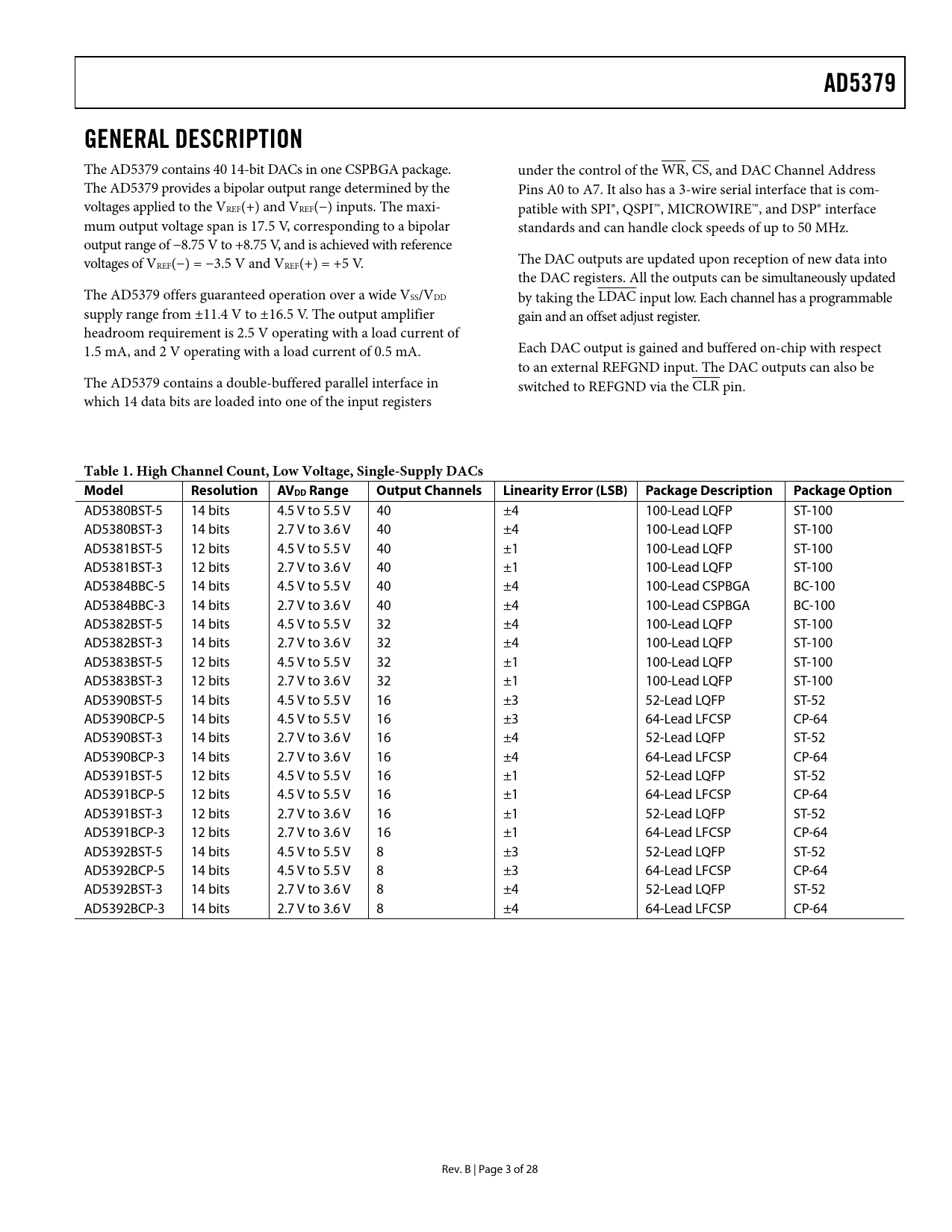

AD5379 GENERAL DESCRIPTION
The AD5379 contains 40 14-bit DACs in one CSPBGA package. under the control of the WR, CS, and DAC Channel Address The AD5379 provides a bipolar output range determined by the Pins A0 to A7. It also has a 3-wire serial interface that is com- voltages applied to the VREF(+) and VREF(−) inputs. The maxi- patible with SPI®, QSPI™, MICROWIRE™, and DSP® interface mum output voltage span is 17.5 V, corresponding to a bipolar standards and can handle clock speeds of up to 50 MHz. output range of −8.75 V to +8.75 V, and is achieved with reference voltages of V The DAC outputs are updated upon reception of new data into REF(−) = −3.5 V and VREF(+) = +5 V. the DAC registers. All the outputs can be simultaneously updated The AD5379 offers guaranteed operation over a wide VSS/VDD by taking the LDAC input low. Each channel has a programmable supply range from ±11.4 V to ±16.5 V. The output amplifier gain and an offset adjust register. headroom requirement is 2.5 V operating with a load current of 1.5 mA, and 2 V operating with a load current of 0.5 mA. Each DAC output is gained and buffered on-chip with respect to an external REFGND input. The DAC outputs can also be The AD5379 contains a double-buffered parallel interface in switched to REFGND via the CLR pin. which 14 data bits are loaded into one of the input registers
Table 1. High Channel Count, Low Voltage, Single-Supply DACs Model Resolution AVDD Range Output Channels Linearity Error (LSB) Package Description Package Option
AD5380BST-5 14 bits 4.5 V to 5.5 V 40 ±4 100-Lead LQFP ST-100 AD5380BST-3 14 bits 2.7 V to 3.6 V 40 ±4 100-Lead LQFP ST-100 AD5381BST-5 12 bits 4.5 V to 5.5 V 40 ±1 100-Lead LQFP ST-100 AD5381BST-3 12 bits 2.7 V to 3.6 V 40 ±1 100-Lead LQFP ST-100 AD5384BBC-5 14 bits 4.5 V to 5.5 V 40 ±4 100-Lead CSPBGA BC-100 AD5384BBC-3 14 bits 2.7 V to 3.6 V 40 ±4 100-Lead CSPBGA BC-100 AD5382BST-5 14 bits 4.5 V to 5.5 V 32 ±4 100-Lead LQFP ST-100 AD5382BST-3 14 bits 2.7 V to 3.6 V 32 ±4 100-Lead LQFP ST-100 AD5383BST-5 12 bits 4.5 V to 5.5 V 32 ±1 100-Lead LQFP ST-100 AD5383BST-3 12 bits 2.7 V to 3.6 V 32 ±1 100-Lead LQFP ST-100 AD5390BST-5 14 bits 4.5 V to 5.5 V 16 ±3 52-Lead LQFP ST-52 AD5390BCP-5 14 bits 4.5 V to 5.5 V 16 ±3 64-Lead LFCSP CP-64 AD5390BST-3 14 bits 2.7 V to 3.6 V 16 ±4 52-Lead LQFP ST-52 AD5390BCP-3 14 bits 2.7 V to 3.6 V 16 ±4 64-Lead LFCSP CP-64 AD5391BST-5 12 bits 4.5 V to 5.5 V 16 ±1 52-Lead LQFP ST-52 AD5391BCP-5 12 bits 4.5 V to 5.5 V 16 ±1 64-Lead LFCSP CP-64 AD5391BST-3 12 bits 2.7 V to 3.6 V 16 ±1 52-Lead LQFP ST-52 AD5391BCP-3 12 bits 2.7 V to 3.6 V 16 ±1 64-Lead LFCSP CP-64 AD5392BST-5 14 bits 4.5 V to 5.5 V 8 ±3 52-Lead LQFP ST-52 AD5392BCP-5 14 bits 4.5 V to 5.5 V 8 ±3 64-Lead LFCSP CP-64 AD5392BST-3 14 bits 2.7 V to 3.6 V 8 ±4 52-Lead LQFP ST-52 AD5392BCP-3 14 bits 2.7 V to 3.6 V 8 ±4 64-Lead LFCSP CP-64 Rev. B | Page 3 of 28 Document Outline FEATURES APPLICATIONS TABLE OF CONTENTS GENERAL DESCRIPTION SPECIFICATIONS AC CHARACTERISTICS TIMING CHARACTERISTICS SERIAL INTERFACE PARALLEL INTERFACE ABSOLUTE MAXIMUM RATINGS ESD CAUTION PIN CONFIGURATION AND FUNCTION DESCRIPTIONS TERMINOLOGY TYPICAL PERFORMANCE CHARACTERISTICS FUNCTIONAL DESCRIPTION DAC ARCHITECTURE—GENERAL CHANNEL GROUPS TRANSFER FUNCTION VBIAS FUNCTION REFERENCE SELECTION Reference Selection Example CALIBRATION Calibration Example CLEAR FUNCTION Hardware Clear Software Clear /BUSY AND /LDAC FUNCTIONS FIFO VS. NON-FIFO OPERATION /BUSY INPUT FUNCTION POWER-ON RESET FUNCTION /RESET INPUT FUNCTION INCREMENT/DECREMENT FUNCTION INTERFACES PARALLEL INTERFACE / CS Pin /WR Pin REG1, REG0 Pins DB13 to DB0 Pins A7 to A0 Pins SERIAL INTERFACE /SYNC , DIN, SCLK DCEN SDO Standalone Mode Daisy-Chain Mode DATA DECODING ADDRESS DECODING POWER SUPPLY DECOUPLING POWER-ON TYPICAL APPLICATION CIRCUIT OUTLINE DIMENSIONS ORDERING GUIDE
