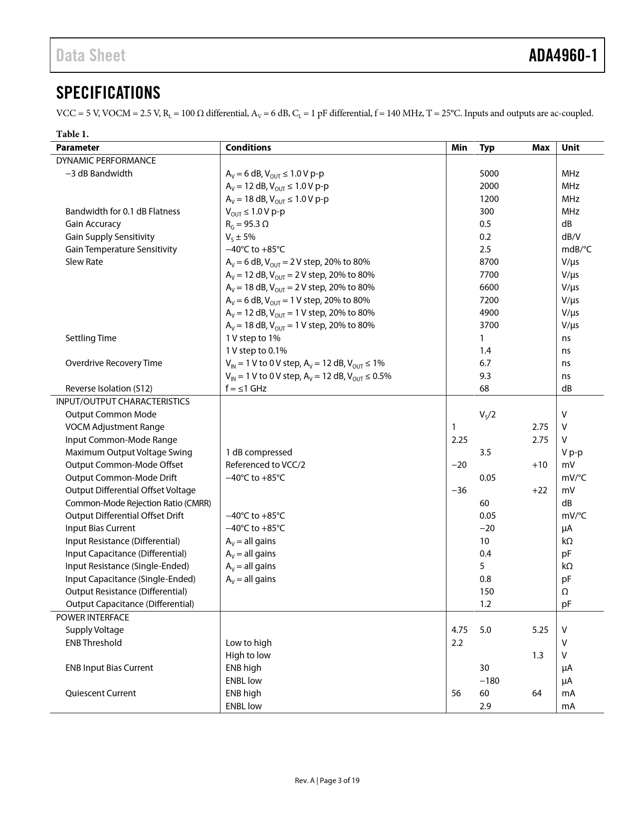

Data Sheet. ADA4960-1. SPECIFICATIONS. Table 1. Parameter. Conditions. Min Typ. Max Unit
Data Sheet ADA4960-1 SPECIFICATIONS Table 1 Parameter Conditions Min Typ Max Unit
VCC = 5 V, VOCM = 2.5 V, RL = 100 Ω differential, AV = 6 dB, CL = 1 pF differential, f = 140 MHz, T = 25°C. Inputs and outputs are ac-coupled.
Table 1. Parameter Conditions Min Typ Max Unit
DYNAMIC PERFORMANCE −3 dB Bandwidth A = 6 dB, V ≤ 1.0 V p-p 5000 MHz V OUT A = 12 dB, V ≤ 1.0 V p-p 2000 MHz V OUT A = 18 dB, V ≤ 1.0 V p-p 1200 MHz V OUT Bandwidth for 0.1 dB Flatness V ≤ 1.0 V p-p 300 MHz OUT Gain Accuracy R = 95.3 Ω 0.5 dB G Gain Supply Sensitivity V ± 5% 0.2 dB/V S Gain Temperature Sensitivity −40°C to +85°C 2.5 mdB/°C Slew Rate A = 6 dB, V = 2 V step, 20% to 80% 8700 V/µs V OUT A = 12 dB, V = 2 V step, 20% to 80% 7700 V/µs V OUT A = 18 dB, V = 2 V step, 20% to 80% 6600 V/µs V OUT A = 6 dB, V = 1 V step, 20% to 80% 7200 V/µs V OUT A = 12 dB, V = 1 V step, 20% to 80% 4900 V/µs V OUT A = 18 dB, V = 1 V step, 20% to 80% 3700 V/µs V OUT Settling Time 1 V step to 1% 1 ns 1 V step to 0.1% 1.4 ns Overdrive Recovery Time V = 1 V to 0 V step, A = 12 dB, V ≤ 1% 6.7 ns IN V OUT V = 1 V to 0 V step, A = 12 dB, V ≤ 0.5% 9.3 ns IN V OUT Reverse Isolation (S12) f = ≤1 GHz 68 dB INPUT/OUTPUT CHARACTERISTICS Output Common Mode V /2 V S VOCM Adjustment Range 1 2.75 V Input Common-Mode Range 2.25 2.75 V Maximum Output Voltage Swing 1 dB compressed 3.5 V p-p Output Common-Mode Offset Referenced to VCC/2 −20 +10 mV Output Common-Mode Drift −40°C to +85°C 0.05 mV/°C Output Differential Offset Voltage −36 +22 mV Common-Mode Rejection Ratio (CMRR) 60 dB Output Differential Offset Drift −40°C to +85°C 0.05 mV/°C Input Bias Current −40°C to +85°C −20 µA Input Resistance (Differential) A = all gains 10 kΩ V Input Capacitance (Differential) A = all gains 0.4 pF V Input Resistance (Single-Ended) A = all gains 5 kΩ V Input Capacitance (Single-Ended) A = all gains 0.8 pF V Output Resistance (Differential) 150 Ω Output Capacitance (Differential) 1.2 pF POWER INTERFACE Supply Voltage 4.75 5.0 5.25 V ENB Threshold Low to high 2.2 V High to low 1.3 V ENB Input Bias Current ENB high 30 µA ENBL low −180 µA Quiescent Current ENB high 56 60 64 mA ENBL low 2.9 mA Rev. A | Page 3 of 19 Document Outline Features Applications Functional Block Diagram General Description Revision History Specifications Absolute Maximum Ratings Thermal Resistance Maximum Power Dissipation ESD Caution Pin Configuration and Function Descriptions Typical Performance Characteristics Test Circuits Circuit Description Basic Structure Applications Information Basic Connections Input and Output Interfacing Gain Adjust Bandwidth Extension ADC Interfacing Line Driver Applications Overdrive and Recovery Layout, Grounding, and Bypassing Outline Dimensions Ordering Guide
