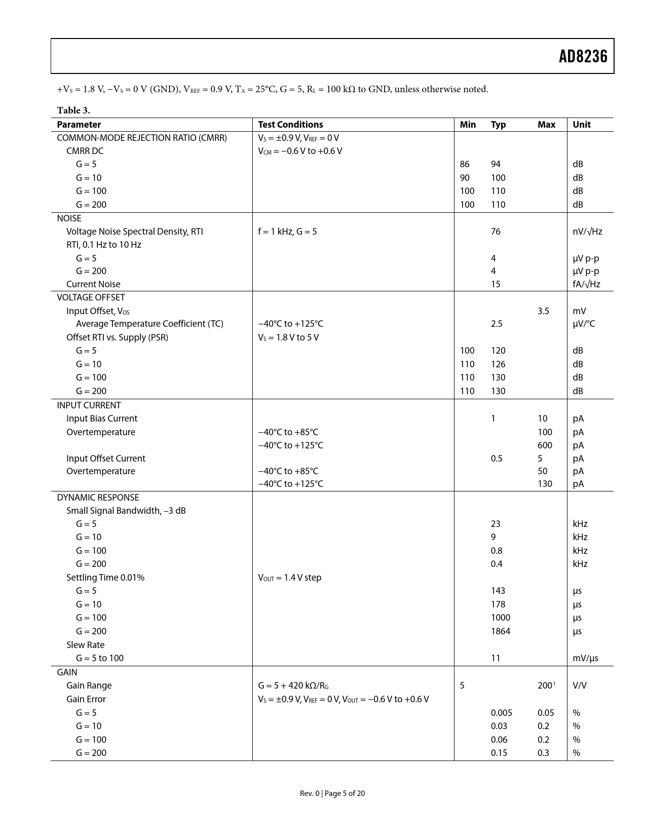

+VS = 1.8 V, −VS = 0 V (GND), VREF = 0.9 V, TA = 25°C, G = 5, RL = 100 kΩ to GND, unless otherwise noted.
Table 3. Parameter Test Conditions Min Typ Max Unit
COMMON-MODE REJECTION RATIO (CMRR) VS = ±0.9 V, VREF = 0 V CMRR DC VCM = −0.6 V to +0.6 V G = 5 86 94 dB G = 10 90 100 dB G = 100 100 110 dB G = 200 100 110 dB NOISE Voltage Noise Spectral Density, RTI f = 1 kHz, G = 5 76 nV/√Hz RTI, 0.1 Hz to 10 Hz G = 5 4 μV p-p G = 200 4 μV p-p Current Noise 15 fA/√Hz VOLTAGE OFFSET Input Offset, VOS 3.5 mV Average Temperature Coefficient (TC) −40°C to +125°C 2.5 μV/°C Offset RTI vs. Supply (PSR) VS = 1.8 V to 5 V G = 5 100 120 dB G = 10 110 126 dB G = 100 110 130 dB G = 200 110 130 dB INPUT CURRENT Input Bias Current 1 10 pA Overtemperature −40°C to +85°C 100 pA −40°C to +125°C 600 pA Input Offset Current 0.5 5 pA Overtemperature −40°C to +85°C 50 pA −40°C to +125°C 130 pA DYNAMIC RESPONSE Small Signal Bandwidth, –3 dB G = 5 23 kHz G = 10 9 kHz G = 100 0.8 kHz G = 200 0.4 kHz Settling Time 0.01% VOUT = 1.4 V step G = 5 143 μs G = 10 178 μs G = 100 1000 μs G = 200 1864 μs Slew Rate G = 5 to 100 11 mV/μs GAIN Gain Range G = 5 + 420 kΩ/RG 5 2001 V/V Gain Error VS = ±0.9 V, VREF = 0 V, VOUT = −0.6 V to +0.6 V G = 5 0.005 0.05 % G = 10 0.03 0.2 % G = 100 0.06 0.2 % G = 200 0.15 0.3 % Rev. 0 | Page 5 of 20 Document Outline FEATURES APPLICATIONS GENERAL DESCRIPTION CONNECTION DIAGRAM TABLE OF CONTENTS REVISION HISTORY SPECIFICATIONS ABSOLUTE MAXIMUM RATINGS MAXIMUM POWER DISSIPATION ESD CAUTION PIN CONFIGURATION AND FUNCTION DESCRIPTIONS TYPICAL PERFORMANCE CHARACTERISTICS THEORY OF OPERATION BASIC OPERATION GAIN SELECTION LAYOUT Grounding REFERENCE TERMINAL POWER SUPPLY REGULATION AND BYPASSING INPUT BIAS CURRENT RETURN PATH INPUT PROTECTION RF INTERFERENCE COMMON-MODE INPUT VOLTAGE RANGE APPLICATIONS INFORMATION AC-COUPLED INSTRUMENTATION AMPLIFIER LOW POWER HEART RATE MONITOR OUTLINE DIMENSIONS ORDERING GUIDE
