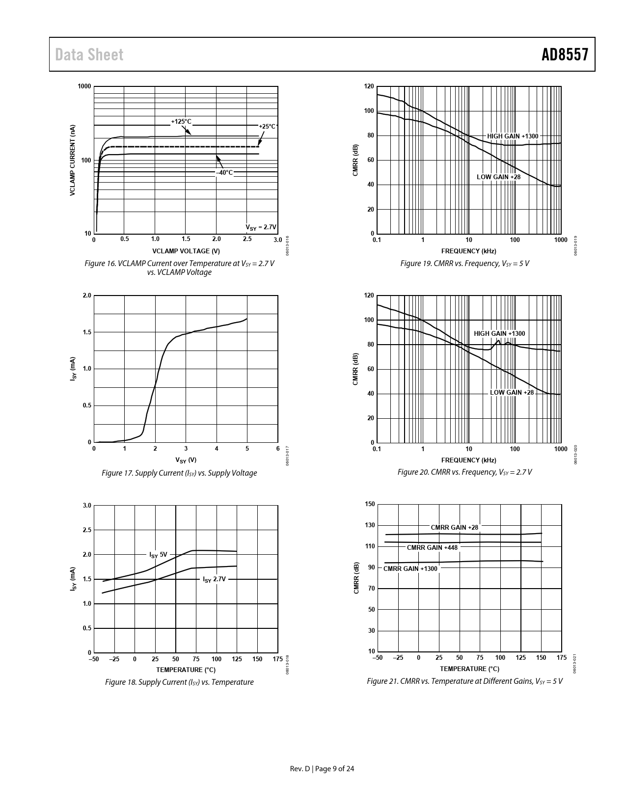

Data Sheet. AD8557. 1000. 120. 100. +125°C. +25°C. n (. HIGH GAIN +1300. B) d. CURRE. RR (. –40°C. LOW GAIN +28. CL V. VSY = 2.7V. 0.5. 1.0. 1.5. 2.0. 2.5. 3.0

01 06 06 Figure 16. VCLAMP Current over Temperature at VSY = 2.7 V Figure 19. CMRR vs. Frequency, VSY = 5 V vs. VCLAMP Voltage

01 06 06 Figure 17. Supply Current (I Figure 20. CMRR vs. Frequency, V SY) vs. Supply Voltage SY = 2.7 V

01 06 06 Figure 18. Supply Current (I Figure 21. CMRR vs. Temperature at Different Gains, V SY) vs. Temperature SY = 5 V Rev. D | Page 9 of 24 Document Outline FEATURES APPLICATIONS FUNCTIONAL BLOCK DIAGRAM GENERAL DESCRIPTION TABLE OF CONTENTS REVISION HISTORY SPECIFICATIONS ABSOLUTE MAXIMUM RATINGS THERMAL RESISTANCE ESD CAUTION PIN CONFIGURATIONS AND FUNCTION DESCRIPTIONS TYPICAL PERFORMANCE CHARACTERISTICS THEORY OF OPERATION GAIN VALUES OPEN WIRE FAULT DETECTION SHORTED WIRE FAULT DETECTION FLOATING VPOS, VNEG, OR VCLAMP FAULT DETECTION DEVICE PROGRAMMING Digital Interface Initial State Simulation Mode Programming Mode Read Mode Sense Current Programming Procedure Determining Optimal Gain and Offset Codes OUTLINE DIMENSIONS ORDERING GUIDE AUTOMOTIVE PRODUCTS
