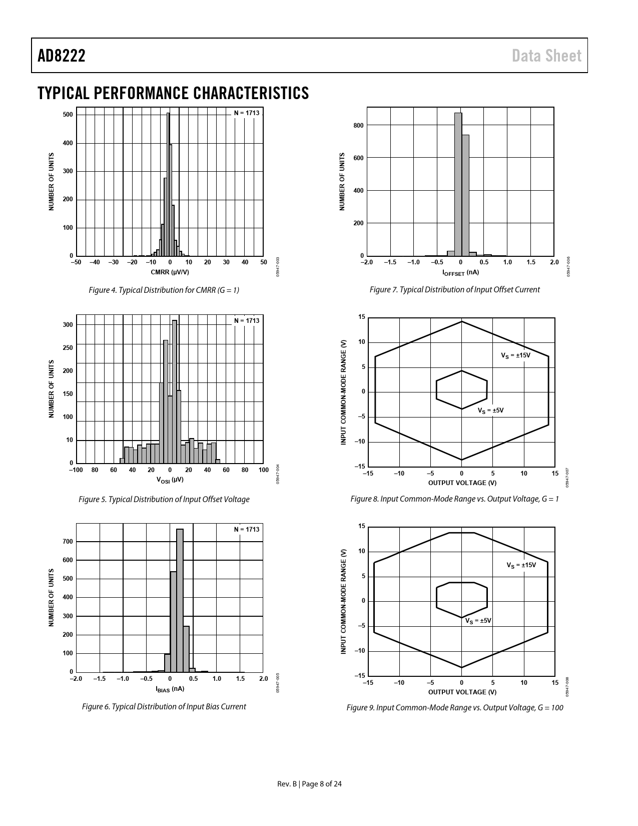

AD8222. Data Sheet. TYPICAL PERFORMANCE CHARACTERISTICS. 500. N = 1713. 800. 400. 600. UNI. 300. R O. 200. NUM. 100. –50. –40. –30. –20. –10. –2.0. –1.5. –1.0

05 Figure 4. Typical Distribution for CMRR (G = 1) Figure 7. Typical Distribution of Input Offset Current
15 N = 1713 300 ) 10 V 250 ( E G VS = ±15V S T 5 200 RAN UNI F DE O R O 150 M 0 N- BE O M VS = ±5V NUM M 100 –5 CO UT 10 INP –10 0 –100 80 60 40 20 0 20 40 60 80 100

94 05 Figure 5. Typical Distribution of Input Offset Voltage Figure 8. Input Common-Mode Range vs. Output Voltage, G = 1
15 N = 1713 700 ) 10 V 600 ( E G V S S = ±15V T 500 5 RAN UNI F DE 400 O R O M 0 N- BE O 300 M V NUM M –5 S = ±5V 200 CO UT 100 INP –10 0–2.0 –1.5 –1.0 –0.5 0 0.5 1.0 1.5 2.0

94 05 Figure 6. Typical Distribution of Input Bias Current Figure 9. Input Common-Mode Range vs. Output Voltage, G = 100 Rev. B | Page 8 of 24 Document Outline FEATURES APPLICATIONS GENERAL DESCRIPTION FUNCTIONAL BLOCK DIAGRAM TABLE OF CONTENTS REVISION HISTORY SPECIFICATIONS ABSOLUTE MAXIMUM RATINGS THERMAL RESISTANCE Maximum Power Dissipation ESD CAUTION PIN CONFIGURATIONS AND FUNCTION DESCRIPTIONS TYPICAL PERFORMANCE CHARACTERISTICS THEORY OF OPERATION AMPLIFIER ARCHITECTURE GAIN SELECTION REFERENCE TERMINAL PACKAGE CONSIDERATIONS Package Without Thermal Pad Package with Thermal Pad LAYOUT Common-Mode Rejection Over Frequency Reference Power Supplies INPUT BIAS CURRENT RETURN PATH INPUT PROTECTION Input Voltages Beyond the Rails Differential Input Voltages at High Gains RF INTERFERENCE COMMON-MODE INPUT VOLTAGE RANGE APPLICATIONS INFORMATION DIFFERENTIAL OUTPUT Setting the Common-Mode Voltage 2-Channel Differential Output Using a Dual Op Amp DRIVING A DIFFERENTIAL INPUT ADC RFI and Antialiasing Filter Second Antialiasing Filter Reference PRECISION STRAIN GAGE DRIVING CABLING OUTLINE DIMENSIONS ORDERING GUIDE
