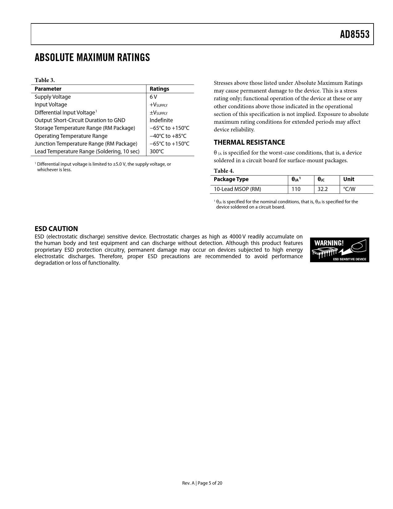

AD8553 ABSOLUTE MAXIMUM RATINGS Table 3.
Stresses above those listed under Absolute Maximum Ratings
Parameter Ratings
may cause permanent damage to the device. This is a stress Supply Voltage 6 V rating only; functional operation of the device at these or any Input Voltage +VSUPPLY other conditions above those indicated in the operational Differential Input Voltage1 ±VSUPPLY section of this specification is not implied. Exposure to absolute Output Short-Circuit Duration to GND Indefinite maximum rating conditions for extended periods may affect Storage Temperature Range (RM Package) −65°C to +150°C device reliability. Operating Temperature Range −40°C to +85°C Junction Temperature Range (RM Package) −65°C to +150°C
THERMAL RESISTANCE
Lead Temperature Range (Soldering, 10 sec) 300°C θ JA is specified for the worst-case conditions, that is, a device soldered in a circuit board for surface-mount packages. 1 Differential input voltage is limited to ±5.0 V, the supply voltage, or whichever is less.
Table 4. Package Type θ 1 JA θJC Unit
10-Lead MSOP (RM) 110 32.2 °C/W 1 θJA is specified for the nominal conditions, that is, θJA is specified for the device soldered on a circuit board.
ESD CAUTION
ESD (electrostatic discharge) sensitive device. Electrostatic charges as high as 4000 V readily accumulate on the human body and test equipment and can discharge without detection. Although this product features proprietary ESD protection circuitry, permanent damage may occur on devices subjected to high energy electrostatic discharges. Therefore, proper ESD precautions are recommended to avoid performance degradation or loss of functionality. Rev. A | Page 5 of 20 Document Outline FEATURES APPLICATIONS PIN CONFIGURATION GENERAL DESCRIPTION TABLE OF CONTENTS REVISION HISTORY SPECIFICATIONS ELECTRICAL CHARACTERISTICS ABSOLUTE MAXIMUM RATINGS THERMAL RESISTANCE ESD CAUTION TYPICAL PERFORMANCE CHARACTERISTICS THEORY OF OPERATION HIGH PSR AND CMR 1/f NOISE CORRECTION APPLICATIONS GAIN SELECTION (GAIN-SETTING RESISTORS) REFERENCE CONNECTION DISABLE FUNCTION OUTPUT FILTERING CLOCK FEEDTHROUGH LOW IMPEDANCE OUTPUT MAXIMIZING PERFORMANCE THROUGH PROPER LAYOUT POWER SUPPLY BYPASSING INPUT OVERVOLTAGE PROTECTION CAPACITIVE LOAD DRIVE CIRCUIT DIAGRAMS/CONNECTIONS OUTLINE DIMENSIONS ORDERING GUIDE
