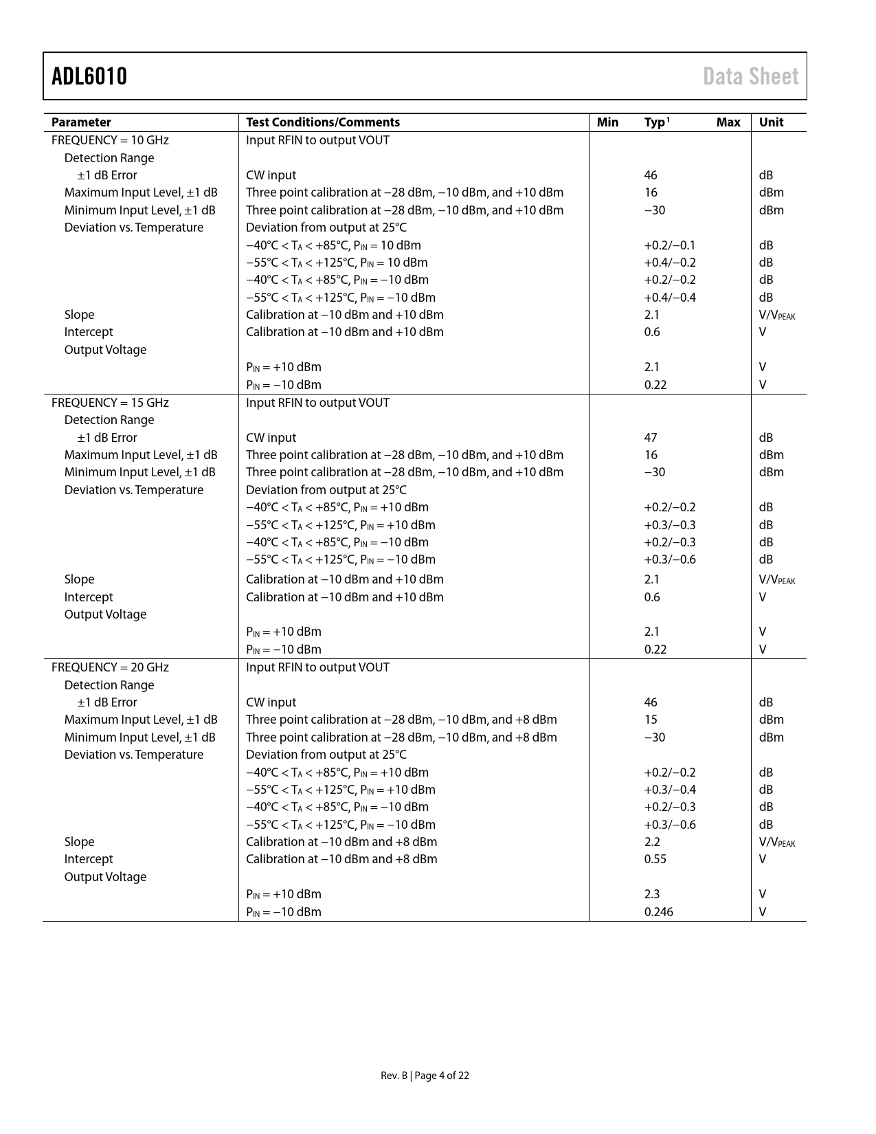

DescriptionFast Responding, 45 dB Range, 0.5 GHz TO 43.5 GHz Envelope Detector

ADL6010. Data Sheet. Parameter. Test Conditions/Comments. Min. Typ1. Max. Unit
ADL6010 Data Sheet Parameter Test Conditions/Comments Min Typ1 Max Unit
link to page 6
FREQUENCY = 10 GHz Input RFIN to output VOUT Detection Range ±1 dB Error CW input 46 dB Maximum Input Level, ±1 dB Three point calibration at −28 dBm, −10 dBm, and +10 dBm 16 dBm Minimum Input Level, ±1 dB Three point calibration at −28 dBm, −10 dBm, and +10 dBm −30 dBm Deviation vs. Temperature Deviation from output at 25°C −40°C < TA < +85°C, PIN = 10 dBm +0.2/−0.1 dB −55°C < TA < +125°C, PIN = 10 dBm +0.4/−0.2 dB −40°C < TA < +85°C, PIN = −10 dBm +0.2/−0.2 dB −55°C < TA < +125°C, PIN = −10 dBm +0.4/−0.4 dB Slope Calibration at −10 dBm and +10 dBm 2.1 V/VPEAK Intercept Calibration at −10 dBm and +10 dBm 0.6 V Output Voltage PIN = +10 dBm 2.1 V PIN = −10 dBm 0.22 V FREQUENCY = 15 GHz Input RFIN to output VOUT Detection Range ±1 dB Error CW input 47 dB Maximum Input Level, ±1 dB Three point calibration at −28 dBm, −10 dBm, and +10 dBm 16 dBm Minimum Input Level, ±1 dB Three point calibration at −28 dBm, −10 dBm, and +10 dBm −30 dBm Deviation vs. Temperature Deviation from output at 25°C −40°C < TA < +85°C, PIN = +10 dBm +0.2/−0.2 dB −55°C < TA < +125°C, PIN = +10 dBm +0.3/−0.3 dB −40°C < TA < +85°C, PIN = −10 dBm +0.2/−0.3 dB −55°C < TA < +125°C, PIN = −10 dBm +0.3/−0.6 dB Slope Calibration at −10 dBm and +10 dBm 2.1 V/VPEAK Intercept Calibration at −10 dBm and +10 dBm 0.6 V Output Voltage PIN = +10 dBm 2.1 V PIN = −10 dBm 0.22 V FREQUENCY = 20 GHz Input RFIN to output VOUT Detection Range ±1 dB Error CW input 46 dB Maximum Input Level, ±1 dB Three point calibration at −28 dBm, −10 dBm, and +8 dBm 15 dBm Minimum Input Level, ±1 dB Three point calibration at −28 dBm, −10 dBm, and +8 dBm −30 dBm Deviation vs. Temperature Deviation from output at 25°C −40°C < TA < +85°C, PIN = +10 dBm +0.2/−0.2 dB −55°C < TA < +125°C, PIN = +10 dBm +0.3/−0.4 dB −40°C < TA < +85°C, PIN = −10 dBm +0.2/−0.3 dB −55°C < TA < +125°C, PIN = −10 dBm +0.3/−0.6 dB Slope Calibration at −10 dBm and +8 dBm 2.2 V/VPEAK Intercept Calibration at −10 dBm and +8 dBm 0.55 V Output Voltage PIN = +10 dBm 2.3 V PIN = −10 dBm 0.246 V Rev. B | Page 4 of 22 Document Outline FEATURES APPLICATIONS FUNCTIONAL BLOCK DIAGRAM GENERAL DESCRIPTION TABLE OF CONTENTS REVISION HISTORY SPECIFICATIONS ABSOLUTE MAXIMUM RATINGS ESD CAUTION PIN CONFIGURATION AND FUNCTION DESCRIPTIONS TYPICAL PERFORMANCE CHARACTERISTICS MEASUREMENT SETUPS THEORY OF OPERATION BASIC CONNECTIONS PCB LAYOUT RECOMMENDATIONS SYSTEM CALIBRATION AND ERROR CALCULATION EFFECT OF A CAPACITAVE LOAD ON RISE TIME AND FALL TIME EVALUATION BOARD EVALUATION BOARD ASSEMBLY DRAWINGS OUTLINE DIMENSIONS ORDERING GUIDE
