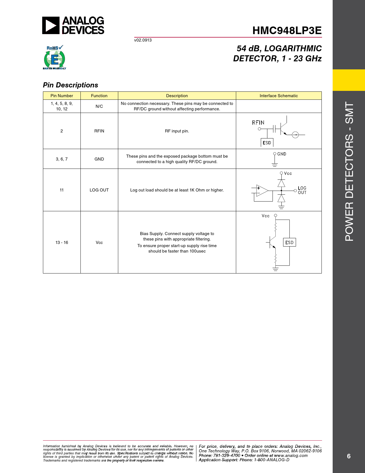

54 dB, LOGARITHMIC DETECTOR, 1 - 23 GHz Pin Descriptions
Pin Number Function Description Interface Schematic 1, 4, 5, 8, 9, No connection necessary. These pins may be connected to N/C 10, 12 RF/DC ground without affecting performance. T M S 2 RFIN RF input pin. - RS These pins and the exposed package bottom must be O 3, 6, 7 GND connected to a high quality RF/DC ground. T C TE 11 LOG OUT Log out load should be at least 1K Ohm or higher. E D R WE Bias Supply. Connect supply voltage to O these pins with appropriate filtering. 13 - 16 Vcc P To ensure proper start-up supply rise time should be faster than 100usec Inf F or o m r p atio r n ifc ur e n , d ishe e d lbiv y e A r n y a alog n D d t evic o p es is la beclie o eved rd to ebre sa: H ccur iattti e tae M nd re ilicarbloew . H a o ve C wever, o n rp o For price, delivery, and to place orders: Analog Devices, Inc., responsibility is assumed by Analog Devices for its use, nor for any infringements of patents or other oration, 2 Elizabeth Drive, Chelmsford, MA 01824 One Technology Way, P.O. Box 9106, Norwood, MA 02062-9106 Phone: 978-250-3343 Fax: 978-250-3373 O rights of third parties that may result from its use. Specifications subject to change without notice. No P rd hone e r O : 7 n 81- -3li 2n 9 e a -47 t w 0 w 0 • O w rd .h e it r o t niltie n .c e ao t m license is granted by implication or otherwise under any patent or patent rights of Analog Devices. www.analog.com
