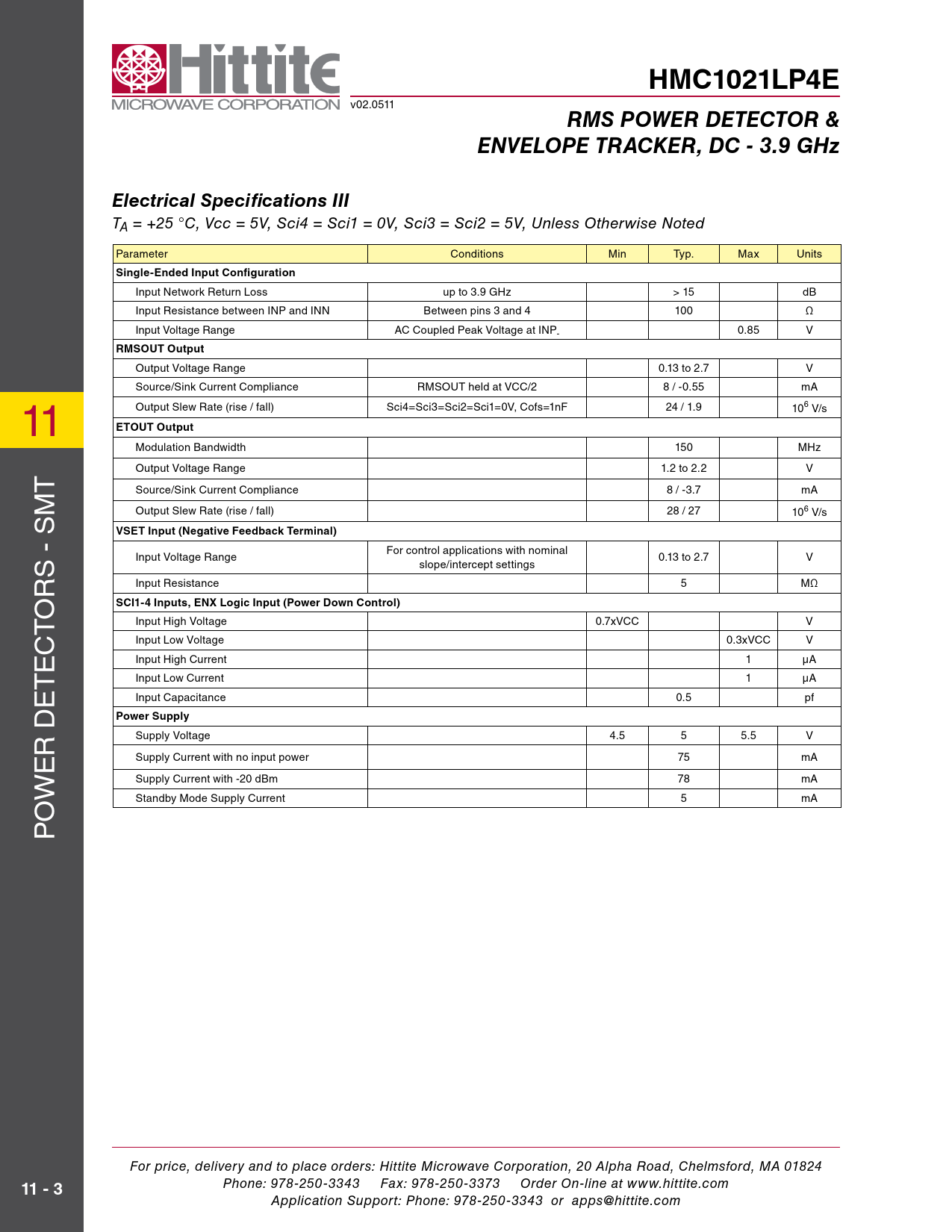

HMC1021LP4E. RMS POWER DETECTOR &. ENVELOPE TRACKER, DC - 3.9 GHz. Electrical Specifications III
HMC1021LP4E RMS POWER DETECTOR & ENVELOPE TRACKER, DC - 3.9 GHz Electrical Specifications III
HMC1021LP4E
v02.0511
TA = +25 °C, Vcc = 5V, Sci4 = Sci1 = 0V, Sci3 = Sci2 = 5V, Unless Otherwise Noted Parameter conditions Min typ. Max Units
Single-Ended Input Configuration
Input Network return Loss up to 3.9 GHz > 15 dB Input resistance between INP and INN Between pins 3 and 4 100 Ω Input Voltage range Ac coupled Peak Voltage at INP- 0.85 V
RMSOUT Output
output Voltage range 0.13 to 2.7 V Source/Sink Current Compliance RMSOUT held at VCC/2 8 / -0.55 mA 11 Output Slew Rate (rise / fall) sci4=sci3=sci2=sci1=0V, cofs=1nF 24 / 1.9 106 V/s
ETOUT Output
Modulation Bandwidth 150 MHz t output Voltage range 1.2 to 2.2 V Source/Sink Current Compliance 8 / -3.7 mA M Output Slew Rate (rise / fall) 28 / 27 106 V/s s
VSET Input (Negative Feedback Terminal)
- For control applications with nominal Input Voltage range 0.13 to 2.7 V slope/intercept settings rs Input resistance 5 MΩ o
SCI1-4 Inputs, ENX Logic Input (Power Down Control)
t Input High Voltage 0.7xVcc V c Input Low Voltage 0.3xVcc V e Input High current 1 μA t Input Low current 1 μA e Input capacitance 0.5 pf D
Power Supply
r supply Voltage 4.5 5 5.5 V e supply current with no input power 75 mA w supply current with -20 dBm 78 mA o standby Mode supply current 5 mA P For price, delivery and to place orders: Hittite Microwave Corporation, 20 Alpha Road, Chelmsford, MA 01824
