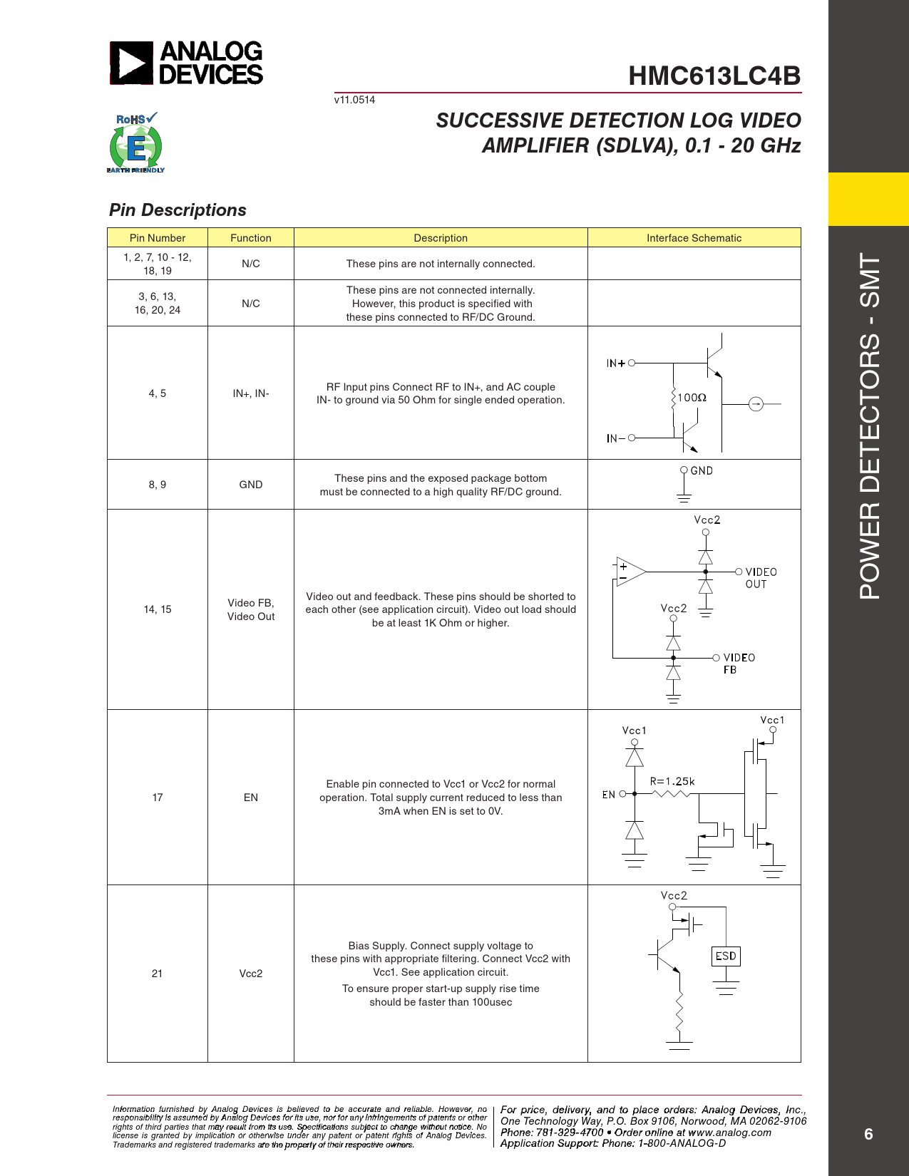

HMC613LC4B. SUCCESSIVE DETECTION LOG VIDEO. AMPLIFIER (SDLVA), 0.1 - 20 GHz. Pin Descriptions
HMC613LC4B SUCCESSIVE DETECTION LOG VIDEO AMPLIFIER (SDLVA), 0.1 - 20 GHz Pin Descriptions
HMC613LC4B
v11.0514
Pin Number Function Description Interface Schematic 1, 2, 7, 10 - 12, N/C These pins are not internally connected. 18, 19 T These pins are not connected internally. M 3, 6, 13, N/C However, this product is specified with 16, 20, 24 these pins connected to RF/DC Ground. S - RS RF Input pins Connect RF to IN+, and AC couple O 4, 5 IN+, IN- IN- to ground via 50 Ohm for single ended operation. T C E T E These pins and the exposed package bottom 8, 9 GND must be connected to a high quality RF/DC ground. D R E W O Video out and feedback. These pins should be shorted to Video FB, P 14, 15 each other (see application circuit). Video out load should Video Out be at least 1K Ohm or higher. Enable pin connected to Vcc1 or Vcc2 for normal 17 EN operation. Total supply current reduced to less than 3mA when EN is set to 0V. Bias Supply. Connect supply voltage to these pins with appropriate filtering. Connect Vcc2 with 21 Vcc2 Vcc1. See application circuit. To ensure proper start-up supply rise time should be faster than 100usec I F nf o or r p mati r o in cfe ur , d nish e e l d iv b e y r A y a nalo n g d t Devi o p ces i la s c bele o ieve rd d t e o rbs e : H acc iutrtatite e M and ic reli rao bl w e. a H v o e C wever o , nrp o For price, delivery, and to place orders: Analog Devices, Inc., responsibility is assumed by Analog Devices for its use, nor for any infringements of patents or other oration, 2 Elizabeth Drive, Chelmsford, MA 01824 One Technology Way, P.O. Box 9106, Norwood, MA 02062-9106 Phone: 978-250-3343 Fax: 978-250-3373 O rights of third parties that may result from its use. Specifications subject to change without notice. No rd Phoe n r O e: 7 n- 81-li 3 n 2 e a 9-4 t w 70 ww 0 • O . rdh e itt r o it nle i . n co e a m license is granted by implication or otherwise under any patent or patent rights of Analog Devices. t www.analog.com
