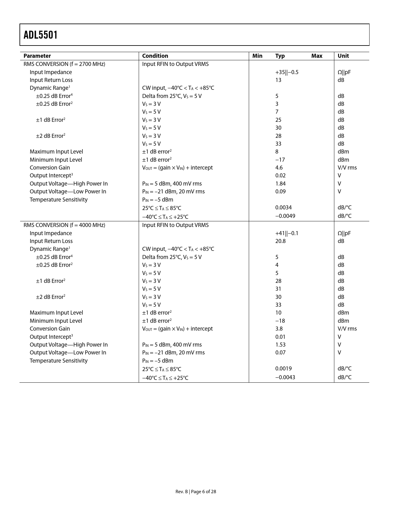

RMS CONVERSION (f = 2700 MHz) Input RFIN to Output VRMS Input Impedance +35||−0.5 Ω||pF Input Return Loss 13 dB Dynamic Range1 CW input, −40°C < TA < +85°C ±0.25 dB Error4 Delta from 25°C, VS = 5 V 5 dB ±0.25 dB Error2 VS = 3 V 3 dB VS = 5 V 7 dB ±1 dB Error2 VS = 3 V 25 dB VS = 5 V 30 dB ±2 dB Error2 VS = 3 V 28 dB VS = 5 V 33 dB Maximum Input Level ±1 dB error2 8 dBm Minimum Input Level ±1 dB error2 −17 dBm Conversion Gain VOUT = (gain × VIN) + intercept 4.6 V/V rms Output Intercept3 0.02 V Output Voltage—High Power In PIN = 5 dBm, 400 mV rms 1.84 V Output Voltage—Low Power In PIN = –21 dBm, 20 mV rms 0.09 V Temperature Sensitivity PIN = –5 dBm 25°C ≤ TA ≤ 85°C 0.0034 dB/°C −40°C ≤ TA ≤ +25°C −0.0049 dB/°C RMS CONVERSION (f = 4000 MHz) Input RFIN to Output VRMS Input Impedance +41||−0.1 Ω||pF Input Return Loss 20.8 dB Dynamic Range1 CW input, −40°C < TA < +85°C ±0.25 dB Error4 Delta from 25°C, VS = 5 V 5 dB ±0.25 dB Error2 VS = 3 V 4 dB VS = 5 V 5 dB ±1 dB Error2 VS = 3 V 28 dB VS = 5 V 31 dB ±2 dB Error2 VS = 3 V 30 dB VS = 5 V 33 dB Maximum Input Level ±1 dB error2 10 dBm Minimum Input Level ±1 dB error2 −18 dBm Conversion Gain VOUT = (gain × VIN) + intercept 3.8 V/V rms Output Intercept3 0.01 V Output Voltage—High Power In PIN = 5 dBm, 400 mV rms 1.53 V Output Voltage—Low Power In PIN = –21 dBm, 20 mV rms 0.07 V Temperature Sensitivity PIN = –5 dBm 25°C ≤ TA ≤ 85°C 0.0019 dB/°C −40°C ≤ TA ≤ +25°C −0.0043 dB/°C Rev. B | Page 6 of 28 Document Outline FEATURES APPLICATIONS GENERAL DESCRIPTION FUNCTIONAL BLOCK DIAGRAM TABLE OF CONTENTS REVISION HISTORY SPECIFICATIONS ABSOLUTE MAXIMUM RATINGS ESD CAUTION PIN CONFIGURATION AND FUNCTION DESCRIPTIONS TYPICAL PERFORMANCE CHARACTERISTICS CIRCUIT DESCRIPTION FILTERING APPLICATIONS INFORMATION BASIC CONNECTIONS OUTPUT SWING LINEARITY INPUT COUPLING USING A SERIES RESISTOR MULTIPLE RF INPUTS SELECTING THE SQUARE-DOMAIN FILTER AND OUTPUT LOW-PASS FILTER POWER CONSUMPTION, ENABLE, AND POWER-ON/POWER-OFF RESPONSE TIME OUTPUT DRIVE CAPABILITY AND BUFFERING VRMS OUTPUT OFFSET DEVICE CALIBRATION AND ERROR CALCULATION CALIBRATION FOR IMPROVED ACCURACY DRIFT OVER A REDUCED TEMPERATURE RANGE OPERATION BELOW 100 MHz EVALUATION BOARD OUTLINE DIMENSIONS ORDERING GUIDE
