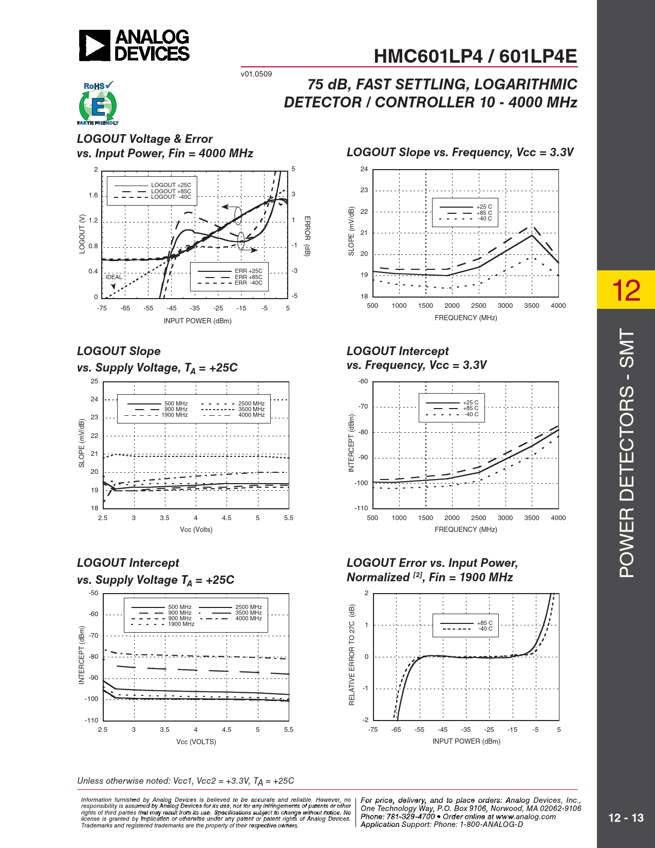

HMC601LP4 / 601LP4E. 75 dB, FAST SETTLING, LOGARITHMIC. DETECTOR / CONTROLLER 10 - 4000 MHz
HMC601LP4 / 601LP4E 75 dB, FAST SETTLING, LOGARITHMIC DETECTOR / CONTROLLER 10 - 4000 MHz
HMC601LP4 / 601LP4E
v01.0509
75 dB, FAST SETTLING, LOGARITHMIC DETECTOR / CONTROLLER 10 - 4000 MHz LOGOUT Voltage & Error vs. Input Power, Fin = 4000 MHz LOGOUT Slope vs. Frequency, Vcc = 3.3V
2 5 24 LOGOUT +25C LOGOUT +85C 23 1.6 3 LOGOUT -40C +25 C ERROR (dB) 22 +85 C 1.2 1 -40 C 21 0.8 -1 LOGOUT (V) SLOPE (mV/dB) 20 0.4 ERR +25C -3 IDEAL ERR +85C 19 ERR -40C 0 -5 18 12 -75 -65 -55 -45 -35 -25 -15 -5 5 500 1000 1500 2000 2500 3000 3500 4000 FREQUENCY (MHz) INPUT POWER (dBm) T
LOGOUT Slope LOGOUT Intercept vs. Supply Voltage, T vs. Frequency, Vcc = 3.3V A = +25C
25 -60 24 S - SM 500 MHz 2500 MHz +25 C -70 900 MHz 3500 MHz +85 C R -40 C 23 1900 MHz 4000 MHz O -80 22 T C 21 -90 E SLOPE (mV/dB) 20 INTERCEPT (dBm) T -100 E 19 18 -110 2.5 3 3.5 4 4.5 5 5.5 500 1000 1500 2000 2500 3000 3500 4000 R D Vcc (Volts) FREQUENCY (MHz) E W
LOGOUT Intercept LOGOUT Error vs. Input Power,
O
Normalized [2], Fin = 1900 MHz
P
vs. Supply Voltage TA = +25C
-50 2 500 MHz 2500 MHz -60 900 MHz 3500 MHz 900 MHz 4000 MHz 1900 MHz 1 +85 C -40 C -70 -80 0 -90 INTERCEPT (dBm) -1 -100 RELATIVE ERROR TO 27C (dB) -110 -2 2.5 3 3.5 4 4.5 5 5.5 -75 -65 -55 -45 -35 -25 -15 -5 5 Vcc (VOLTS) INPUT POWER (dBm) Unless otherwise noted: Vcc1, Vcc2 = +3.3V, TA = +25C Information furnis F heod r pri by An ce, de alog Devi lcievs eir s y b , a eliev nd to pla ed to be accu ce o rate anrder d relia sbl, pl e. H ease co owever, no For price, delivery, and to place orders: Analog Devices, Inc., responsibility is assumed by Analog Devices for its use, nor for any infringements of patents or other ntact Hittite Microwave Corporation: One Technology Way, P.O. Box 9106, Norwood, MA 02062-9106 20 Alpha Road, Chelmsford, MA 01824 Phone: 978 rights of third parties that may result from its use. Specifications subject to change without notice. No Ph - o 25 ne 0 : 7 -3 81- 3 3 4 29 3 F -470 ax: 978 0 • Orde - r o 25 nlin 0- e a3 t 373 license is granted by implication or otherwise under any patent or patent rights of Analog Devices. www.analog.com
