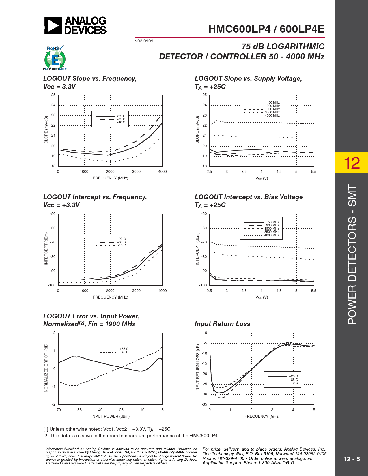

HMC600LP4 / 600LP4E. 75 dB LOGARITHMIC. DETECTOR / CONTROLLER 50 - 4000 MHz. LOGOUT Slope vs. Frequency,
HMC600LP4 / 600LP4E 75 dB LOGARITHMIC DETECTOR / CONTROLLER 50 - 4000 MHz LOGOUT Slope vs Frequency,
HMC600LP4 / 600LP4E
v02.0909
75 dB LOGARITHMIC DETECTOR / CONTROLLER 50 - 4000 MHz LOGOUT Slope vs. Frequency, LOGOUT Slope vs. Supply Voltage, Vcc = 3.3V TA = +25C
25 25 50 MHz 24 24 900 MHz 1900 MHz 3500 MHz 23 +25 C 23 4000 MHz +85 C -40 C 22 22 21 21 SLOPE (mV/dB) SLOPE (mV/dB) 20 20 19 19 18 18 12 0 1000 2000 3000 4000 2.5 3 3.5 4 4.5 5 5.5 FREQUENCY (MHz) Vcc (V) T
LOGOUT Intercept vs. Frequency, LOGOUT Intercept vs. Bias Voltage Vcc = +3.3V TA = +25C
-50 -50 50 MHz S - SM 900 MHz -60 -60 1900 MHz R 3500 MHz 4000 MHz +25 C O -70 +85 C -70 -40 C T C -80 -80 E INTERCEPT (dBm) INTERCEPT (dBm) T -90 -90 E -100 -100 0 1000 2000 3000 4000 2.5 3 3.5 4 4.5 5 5.5 R D FREQUENCY (MHz) Vcc (V) E W
LOGOUT Error vs. Input Power,
O
Normalized[2], Fin = 1900 MHz Input Return Loss
P 2 0 -5 1 +85 C -40 C -10 -15 0 -20 +25 C +85 C -25 -40 C -1 NORMALIZED ERROR (dB) INPUT RETURN LOSS (dB) -30 -2 -35 -70 -55 -40 -25 -10 5 0 1 2 3 4 5 INPUT POWER (dBm) FREQUENCY (GHz) [1] Unless otherwise noted: Vcc1, Vcc2 = +3.3V, TA = +25C [2] This data is relative to the room temperature performance of the HMC600LP4 Information furnis F heod r pri by An ce, de alog Devi lcievs eir s y b , a eliev nd to pla ed to be accu ce o rate anrder d relia sbl, pl e. H ease co owever, no For price, delivery, and to place orders: Analog Devices, Inc., responsibility is assumed by Analog Devices for its use, nor for any infringements of patents or other ntact Hittite Microwave Corporation: One Technology Way, P.O. Box 9106, Norwood, MA 02062-9106 20 Alpha Road, Chelmsford, MA 01824 Phone: 978 rights of third parties that may result from its use. Specifications subject to change without notice. No Ph - o 25 ne 0 : 7 -3 81- 3 3 4 29 3 F -470 ax: 978 0 • Orde - r o 25 nlin 0- e a3 t 373 license is granted by implication or otherwise under any patent or patent rights of Analog Devices. www.analog.com
