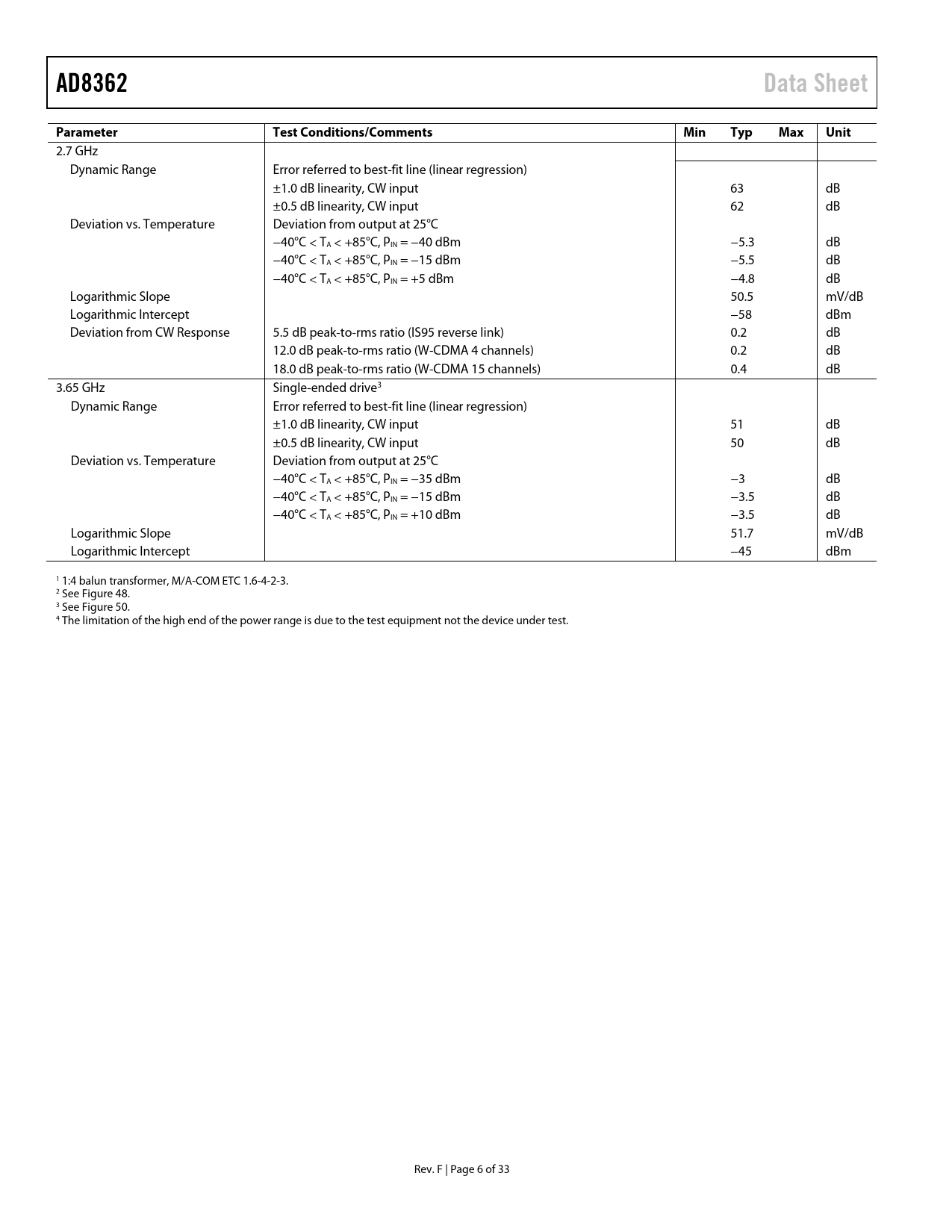

2.7 GHz Dynamic Range Error referred to best-fit line (linear regression) ±1.0 dB linearity, CW input 63 dB ±0.5 dB linearity, CW input 62 dB Deviation vs. Temperature Deviation from output at 25°C −40°C < TA < +85°C, PIN = −40 dBm −5.3 dB −40°C < TA < +85°C, PIN = −15 dBm −5.5 dB −40°C < TA < +85°C, PIN = +5 dBm −4.8 dB Logarithmic Slope 50.5 mV/dB Logarithmic Intercept −58 dBm Deviation from CW Response 5.5 dB peak-to-rms ratio (IS95 reverse link) 0.2 dB 12.0 dB peak-to-rms ratio (W-CDMA 4 channels) 0.2 dB 18.0 dB peak-to-rms ratio (W-CDMA 15 channels) 0.4 dB 3.65 GHz Single-ended drive3 Dynamic Range Error referred to best-fit line (linear regression) ±1.0 dB linearity, CW input 51 dB ±0.5 dB linearity, CW input 50 dB Deviation vs. Temperature Deviation from output at 25°C −40°C < TA < +85°C, PIN = −35 dBm −3 dB −40°C < TA < +85°C, PIN = −15 dBm −3.5 dB −40°C < TA < +85°C, PIN = +10 dBm −3.5 dB Logarithmic Slope 51.7 mV/dB Logarithmic Intercept −45 dBm 1 1:4 balun transformer, M/A-COM ETC 1.6-4-2-3. 2 See Figure 48. 3 See Figure 50. 4 The limitation of the high end of the power range is due to the test equipment not the device under test. Rev. F | Page 6 of 33 Document Outline FEATURES APPLICATIONS FUNCTIONAL BLOCK DIAGRAM GENERAL DESCRIPTION TABLE OF CONTENTS REVISION HISTORY SPECIFICATIONS ABSOLUTE MAXIMUM RATINGS ESD CAUTION PIN CONFIGURATION AND FUNCTION DESCRIPTIONS EQUIVALENT CIRCUITS TYPICAL PERFORMANCE CHARACTERISTICS CHARACTERIZATION SETUP EQUIPMENT ANALYSIS CIRCUIT DESCRIPTION SQUARE LAW DETECTION VOLTAGE vs. POWER CALIBRATION OFFSET ELIMINATION TIME-DOMAIN RESPONSE OF THE CLOSED LOOP OPERATION IN RF MEASUREMENT MODE BASIC CONNECTIONS DEVICE DISABLE RECOMMENDED INPUT COUPLING Choosing Input Coupling Capacitors Single-Ended Input Drive OPERATION AT LOW FREQUENCIES CHOOSING A VALUE FOR CHPF CHOOSING A VALUE FOR CLPF ADJUSTING VTGT TO ACCOMMODATE SIGNALS WITH VERY HIGH CREST FACTORS ALTERING THE SLOPE TEMPERATURE COMPENSATION AND REDUCTION OF TRANSFER FUNCTION RIPPLE TEMPERATURE COMPENSATION AT VARIOUS WiMAX FREQUENCIES UP TO 3.8 GHz OPERATION IN CONTROLLER MODE RMS VOLTMETER WITH 90 dB DYNAMIC RANGE AD8362 EVALUATION BOARD OUTLINE DIMENSIONS ORDERING GUIDE
