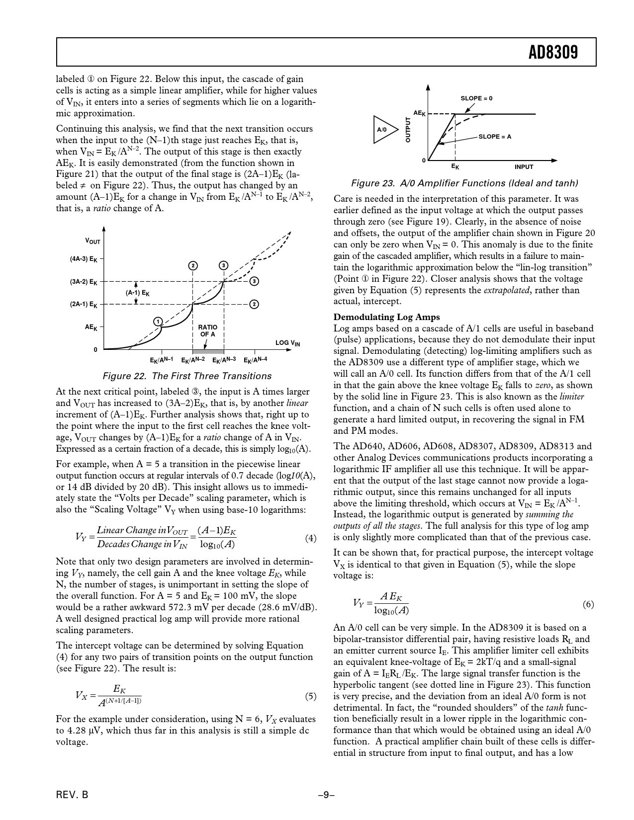

labeled ① on Figure 22. Below this input, the cascade of gain cells is acting as a simple linear amplifier, while for higher values of V
SLOPE = 0
IN, it enters into a series of segments which lie on a logarith- mic approximation.
AEK
Continuing this analysis, we find that the next transition occurs
A/0
when the input to the (N–1)th stage just reaches E
SLOPE = A
K, that is,
OUTPUT
when VIN = EK /AN–2. The output of this stage is then exactly AE
0
K. It is easily demonstrated (from the function shown in
EK INPUT
Figure 21) that the output of the final stage is (2A–1)EK (la- beled ≠ on Figure 22). Thus, the output has changed by an Figure 23. A/0 Amplifier Functions (Ideal and tanh) amount (A–1)EK for a change in VIN from EK /AN–1 to EK /AN–2, Care is needed in the interpretation of this parameter. It was that is, a ratio change of A. earlier defined as the input voltage at which the output passes through zero (see Figure 19). Clearly, in the absence of noise and offsets, the output of the amplifier chain shown in Figure 20
VOUT
can only be zero when VIN = 0. This anomaly is due to the finite gain of the cascaded amplifier, which results in a failure to main-
(4A-3) EK
tain the logarithmic approximation below the “lin-log transition” (Point ① in Figure 22). Closer analysis shows that the voltage
(3A-2) EK (A-1) E
given by Equation (5) represents the extrapolated, rather than
K
actual, intercept.
(2A-1) EK Demodulating Log Amps AE RATIO K
Log amps based on a cascade of A/1 cells are useful in baseband
OF A
(pulse) applications, because they do not demodulate their input
LOG VIN 0
signal. Demodulating (detecting) log-limiting amplifiers such as
EK/AN–1 EK/AN–2 EK/AN–3 EK/AN–4
