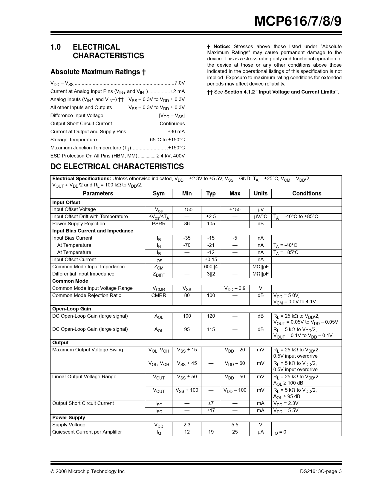

MCP616/7/8/9. 1.0. ELECTRICAL. † Notice:. CHARACTERISTICS. Absolute Maximum Ratings †
MCP616/7/8/9 1.0 ELECTRICAL † Notice: CHARACTERISTICS Absolute Maximum Ratings †
link to page 15
Stresses above those listed under “Absolute Maximum Ratings” may cause permanent damage to the
CHARACTERISTICS
device. This is a stress rating only and functional operation of the device at those or any other conditions above those
indicated in the operational listings of this specification is not implied. Exposure to maximum rating conditions for extended VDD – VSS ..7.0V periods may affect device reliability. Current at Analog Input Pins (VIN+ and VIN–)..±2 mA
See
Section 4.1.2 “Input Voltage and Current Limits”
. Analog Inputs (VIN+ and VIN–) †† .. VSS – 0.3V to VDD + 0.3V All other Inputs and Outputs .. VSS – 0.3V to VDD + 0.3V Difference Input Voltage .. |VDD – VSS| Output Short Circuit Current .. Continuous Current at Output and Supply Pins ..±30 mA Storage Temperature ... –65°C to +150°C Maximum Junction Temperature (TJ)... .+150°C ESD Protection On All Pins (HBM; MM) .. ≥ 4 kV; 400V
DC ELECTRICAL CHARACTERISTICS Electrical Specifications:
Unless otherwise indicated, VDD = +2.3V to +5.5V, VSS = GND, TA = +25°C, VCM = VDD/2, VOUT ≈ VDD/2 and RL = 100 kΩ to VDD/2.
Parameters Sym Min Typ Max Units Conditions Input Offset
Input Offset Voltage V –150 — +150 µV OS Input Offset Drift with Temperature ΔV /ΔT OS A — ±2.5 — µV/°C TA = -40°C to +85°C Power Supply Rejection PSRR 86 105 — dB
Input Bias Current and Impedance
Input Bias Current IB -35 -15 -5 nA At Temperature IB -70 -21 — nA TA = -40°C At Temperature IB — -12 — nA TA = +85°C Input Offset Current IOS — ±0.15 — nA Common Mode Input Impedance ZCM — 600||4 — MΩ||pF Differential Input Impedance ZDIFF — 3||2 — MΩ||pF
Common Mode
Common Mode Input Voltage Range VCMR VSS VDD – 0.9 V Common Mode Rejection Ratio CMRR 80 100 — dB VDD = 5.0V, VCM = 0.0V to 4.1V
Open-Loop Gain
DC Open-Loop Gain (large signal) AOL 100 120 — dB RL = 25 kΩ to VDD/2, VOUT = 0.05V to VDD – 0.05V DC Open-Loop Gain (large signal) AOL 95 115 — dB RL = 5 kΩ to VDD/2, VOUT = 0.1V to VDD – 0.1V
Output
Maximum Output Voltage Swing VOL, VOH VSS + 15 — VDD – 20 mV RL = 25 kΩ to VDD/2, 0.5V input overdrive VOL, VOH VSS + 45 — VDD – 60 mV RL = 5 kΩ to VDD/2, 0.5V input overdrive Linear Output Voltage Range VOUT VSS + 50 — VDD – 50 mV RL = 25 kΩ to VDD/2, AOL ≥ 100 dB VOUT VSS + 100 — VDD – 100 mV RL = 5 kΩ to VDD/2, AOL ≥ 95 dB Output Short Circuit Current ISC — ±7 — mA VDD = 2.3V ISC — ±17 — mA VDD = 5.5V
Power Supply
Supply Voltage VDD 2.3 — 5.5 V Quiescent Current per Amplifier IQ 12 19 25 µA IO = 0 © 2008 Microchip Technology Inc. DS21613C-page 3 Document Outline 1.0 Electrical Characteristics FIGURE 1-1: Timing Diagram for the CS Pin on the MCP618. 1.1 Test Circuits FIGURE 1-2: AC and DC Test Circuit for Most Non-Inverting Gain Conditions. FIGURE 1-3: AC and DC Test Circuit for Most Inverting Gain Conditions. 2.0 Typical Performance Curves FIGURE 2-1: Input Offset Voltage at VDD = 5.5V. FIGURE 2-2: Input Offset Voltage at VDD = 2.3V. FIGURE 2-3: Input Bias Current at VDD = 5.5V. FIGURE 2-4: Input Offset Voltage Drift at VDD = 5.5V. FIGURE 2-5: Input Offset Voltage Drift at VDD = 2.3V. FIGURE 2-6: Input Offset Current at VDD = 5.5V. FIGURE 2-7: Input Offset Voltage vs. Ambient Temperature. FIGURE 2-8: Quiescent Current vs. Ambient Temperature. FIGURE 2-9: Maximum Output Voltage Swing vs. Ambient Temperature at RL = 5 kW. FIGURE 2-10: Input Bias, Offset Currents vs. Ambient Temperature. FIGURE 2-11: CMRR, PSRR vs. Ambient Temperature. FIGURE 2-12: Maximum Output Voltage Swing vs. Ambient Temperature at RL = 25 kW. FIGURE 2-13: Output Short Circuit Current vs. Ambient Temperature. FIGURE 2-14: Slew Rate vs. Ambient Temperature. FIGURE 2-15: Input Bias, Offset Currents vs. Common Mode Input Voltage. FIGURE 2-16: Gain Bandwidth Product, Phase Margin vs. Ambient Temperature. FIGURE 2-17: Input Offset Voltage vs. Common Mode Input Voltage. FIGURE 2-18: Input Offset Voltage vs. Output Voltage. FIGURE 2-19: Quiescent Current vs. Power Supply Voltage. FIGURE 2-20: DC Open-Loop Gain vs. Load Resistance. FIGURE 2-21: Gain-Bandwidth Product, Phase Margin vs. Load Resistance. FIGURE 2-22: Output Voltage Headroom vs. Output Current Magnitude. FIGURE 2-23: DC Open-Loop Gain vs. Power Supply Voltage. FIGURE 2-24: Channel-to-Channel Separation vs. Frequency (MCP617 and MCP619 only). FIGURE 2-25: Open-Loop Gain, Phase vs. Frequency. FIGURE 2-26: Input Noise Voltage, Current Densities vs. Frequency. FIGURE 2-27: Small-Signal, Non-Inverting Pulse Response. FIGURE 2-28: CMRR, PSRR vs. Frequency. FIGURE 2-29: Maximum Output Voltage Swing vs. Frequency. FIGURE 2-30: Small-Signal, Inverting Pulse Response. FIGURE 2-31: Large-Signal, Non-Inverting Pulse Response. FIGURE 2-32: Chip Select (CS) to Amplifier Output Response Time (MCP618 only). FIGURE 2-33: The MCP616/7/8/9 Show No Phase Reversal. FIGURE 2-34: Large-Signal, Inverting Pulse Response. FIGURE 2-35: Chip Select (CS) Internal Hysteresis (MCP618 only). FIGURE 2-36: Measured Input Current vs. Input Voltage (below VSS). 3.0 Pin Descriptions TABLE 3-1: Pin Function Table 3.1 Analog Outputs 3.2 Analog Inputs 3.3 Chip Select Digital Input (CS) 3.4 Power Supply Pins (VDD, VSS) 4.0 Applications Information 4.1 Rail-to-Rail Inputs FIGURE 4-1: Simplified Analog Input ESD Structures. FIGURE 4-2: Protecting the Analog Inputs. 4.2 DC Offsets FIGURE 4-3: Example Circuit for Calculating DC Offset. FIGURE 4-4: Equivalent DC Circuit. 4.3 Rail-to-Rail Output 4.4 Capacitive Loads FIGURE 4-5: Output Resistor, RISO stabilizes large capacitive loads. FIGURE 4-6: Recommended RISO Values for Capacitive Loads. 4.5 MCP618 Chip Select (CS) 4.6 Supply Bypass 4.7 Unused Op Amps FIGURE 4-7: Unused Op Amps. 4.8 PCB Surface Leakage FIGURE 4-8: Example Guard Ring Layout for Inverting Gain. 4.9 Application Circuits FIGURE 4-9: High Gain Pre-amplifier. FIGURE 4-10: Two-Op Amp Instrumentation Amplifier. FIGURE 4-11: Three-Op Amp Instrumentation Amplifier. FIGURE 4-12: Precision Gain with Good Load Isolation. 5.0 Design Aids 5.1 SPICE Macro Model 5.2 Mindi™ Circuit Designer & Simulator 5.3 Microchip Advanced Part Selector (MAPS) 5.4 Analog Demonstration and Evaluation Boards 5.5 Application Notes 6.0 Packaging Information 6.1 Package Marking Information
