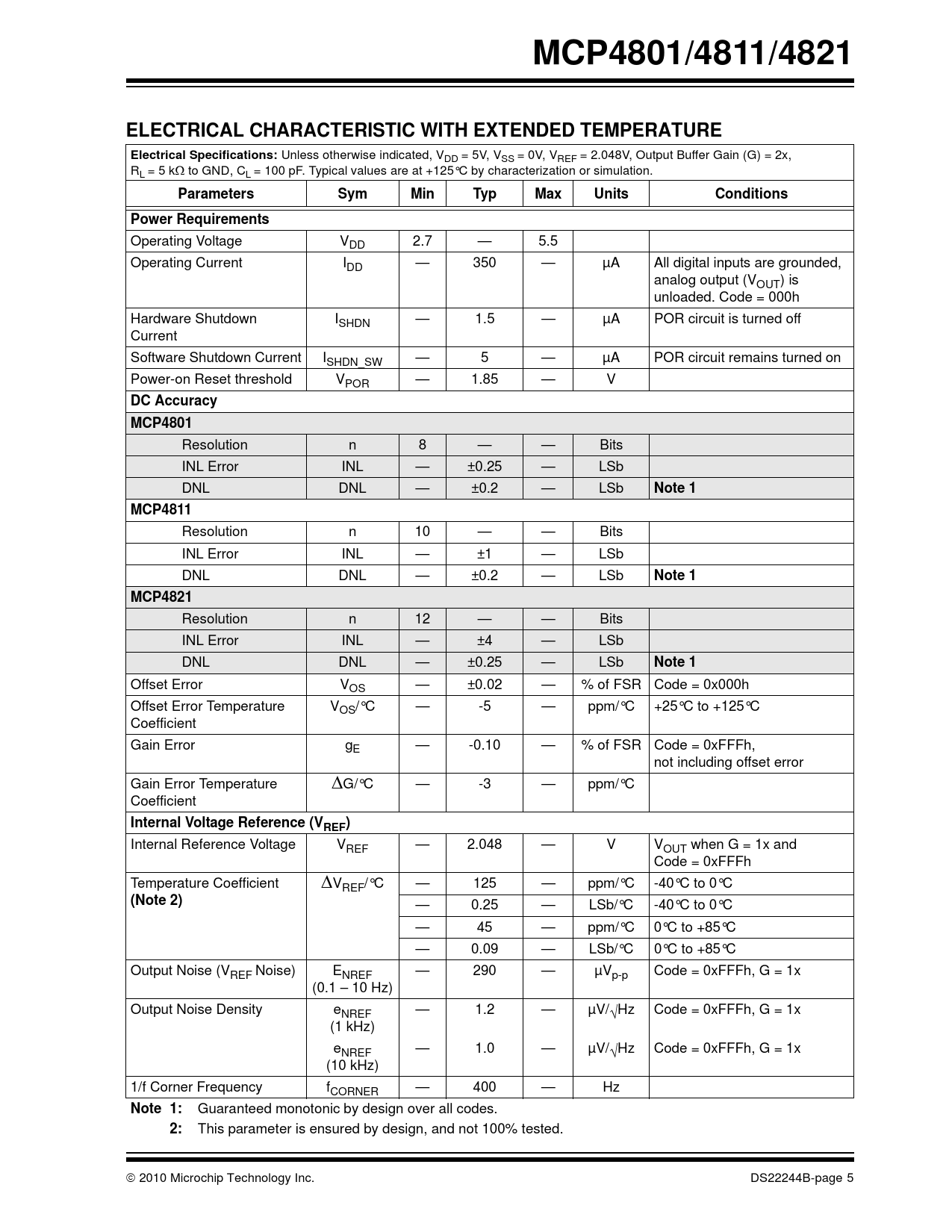

Pages / Page48 / 5 — MCP4801/4811/4821. ELECTRICAL CHARACTERISTIC WITH EXTENDED TEMPERATURE. …
MCP4801/4811/4821. ELECTRICAL CHARACTERISTIC WITH EXTENDED TEMPERATURE. Electrical Specifications:. Parameters. Sym. Min. Typ. Max
MCP4801/4811/4821 ELECTRICAL CHARACTERISTIC WITH EXTENDED TEMPERATURE Electrical Specifications: Parameters Sym Min Typ Max
link to page 5 link to page 5 link to page 5 link to page 5
Unless otherwise indicated, VDD = 5V, VSS = 0V, VREF = 2.048V, Output Buffer Gain (G) = 2x, RL = 5 k to GND, CL = 100 pF. Typical values are at +125°C by characterization or simulation.
Parameters Sym Min Typ Max Units Conditions Power Requirements
Operating Voltage VDD 2.7 — 5.5 Operating Current IDD — 350 — µA All digital inputs are grounded, analog output (VOUT) is unloaded. Code = 000h Hardware Shutdown ISHDN — 1.5 — µA POR circuit is turned off Current Software Shutdown Current ISHDN_SW — 5 — µA POR circuit remains turned on Power-on Reset threshold VPOR — 1.85 — V
DC Accuracy MCP4801
Resolution n 8 — — Bits INL Error INL — ±0.25 — LSb DNL DNL — ±0.2 — LSb
Note 1 MCP4811
Resolution n 10 — — Bits INL Error INL — ±1 — LSb DNL DNL — ±0.2 — LSb
Note 1 MCP4821
Resolution n 12 — — Bits INL Error INL — ±4 — LSb DNL DNL — ±0.25 — LSb
Note 1
Offset Error VOS — ±0.02 — % of FSR Code = 0x000h Offset Error Temperature VOS/°C — -5 — ppm/°C +25°C to +125°C Coefficient Gain Error gE — -0.10 — % of FSR Code = 0xFFFh, not including offset error Gain Error Temperature G/°C — -3 — ppm/°C Coefficient
Internal Voltage Reference (VREF)
Internal Reference Voltage VREF — 2.048 — V VOUT when G = 1x and Code = 0xFFFh Temperature Coefficient VREF/°C — 125 — ppm/°C -40°C to 0°C
(Note 2)
— 0.25 — LSb/°C -40°C to 0°C — 45 — ppm/°C 0°C to +85°C — 0.09 — LSb/°C 0°C to +85°C Output Noise (VREF Noise) ENREF — 290 — µVp-p Code = 0xFFFh, G = 1x (0.1 – 10 Hz) Output Noise Density eNREF — 1.2 — µV/Hz Code = 0xFFFh, G = 1x (1 kHz) eNREF — 1.0 — µV/Hz Code = 0xFFFh, G = 1x (10 kHz) 1/f Corner Frequency fCORNER — 400 — Hz
Note 1:
Guaranteed monotonic by design over all codes.
2:
