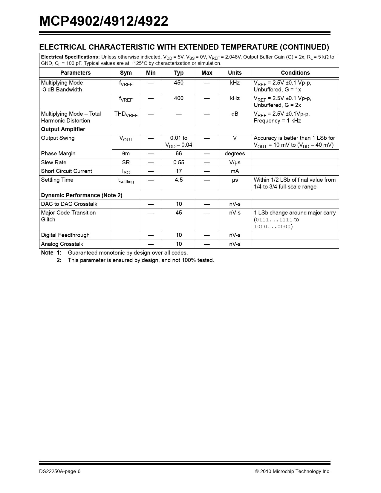

MCP4902/4912/4922. ELECTRICAL CHARACTERISTIC WITH EXTENDED TEMPERATURE (CONTINUED). Electrical Specifications:. Parameters. Sym
MCP4902/4912/4922 ELECTRICAL CHARACTERISTIC WITH EXTENDED TEMPERATURE (CONTINUED) Electrical Specifications: Parameters Sym
link to page 3
Unless otherwise indicated, VDD = 5V, VSS = 0V, VREF = 2.048V, Output Buffer Gain (G) = 2x, RL = 5 k to GND, CL = 100 pF. Typical values are at +125°C by characterization or simulation.
Parameters Sym Min Typ Max Units Conditions
Multiplying Mode fVREF — 450 — kHz VREF = 2.5V ±0.1 Vp-p, -3 dB Bandwidth Unbuffered, G = 1x fVREF — 400 — kHz VREF = 2.5V ±0.1 Vp-p, Unbuffered, G = 2x Multiplying Mode – Total THDVREF — — — dB VREF = 2.5V ±0.1Vp-p, Harmonic Distortion Frequency = 1 kHz
Output Amplifier
Output Swing VOUT — 0.01 to — V Accuracy is better than 1 LSb for VDD – 0.04 VOUT = 10 mV to (VDD – 40 mV) Phase Margin m — 66 — degrees Slew Rate SR — 0.55 — V/µs Short Circuit Current ISC — 17 — mA Settling Time tsettling — 4.5 — µs Within 1/2 LSb of final value from 1/4 to 3/4 full-scale range
Dynamic Performance (Note 2)
DAC to DAC Crosstalk — 10 — nV-s Major Code Transition — 45 — nV-s 1 LSb change around major carry Glitch (0111...1111 to 1000...0000) Digital Feedthrough — 10 — nV-s Analog Crosstalk — 10 — nV-s
