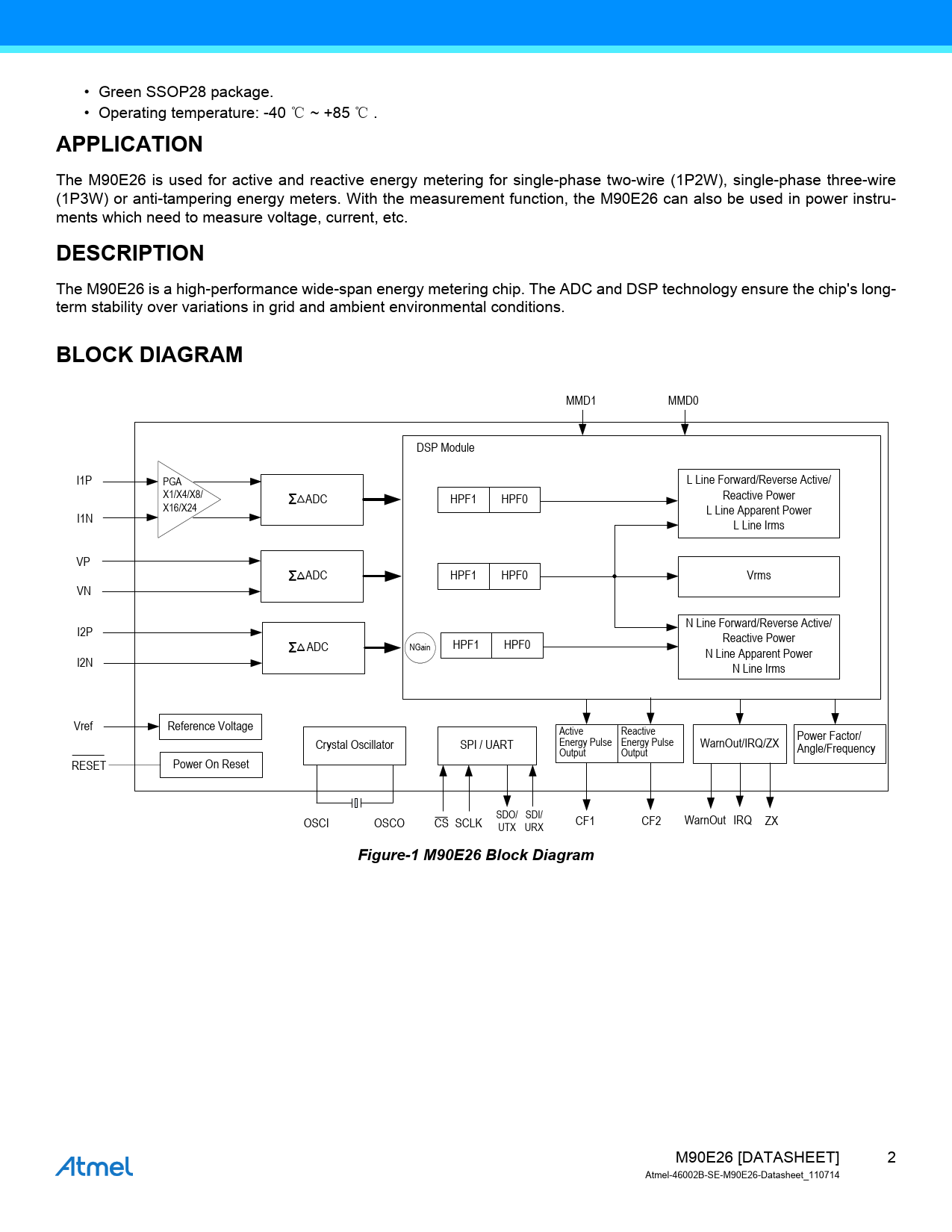

• Green SSOP28 package. • Operating temperature: -40 ℃ ~ +85 ℃ .
APPLICATION
The M90E26 is used for active and reactive energy metering for single-phase two-wire (1P2W), single-phase three-wire (1P3W) or anti-tampering energy meters. With the measurement function, the M90E26 can also be used in power instru- ments which need to measure voltage, current, etc.
DESCRIPTION
The M90E26 is a high-performance wide-span energy metering chip. The ADC and DSP technology ensure the chip's long- term stability over variations in grid and ambient environmental conditions.
BLOCK DIAGRAM
MMD1 MMD0 DSP Module I1P PGA L Line Forward/Reverse Active/ X1/X4/X8/ Reactive Power ADC HPF1 HPF0 X16/X24 L Line Apparent Power I1N L Line Irms VP ADC HPF1 HPF0 Vrms VN N Line Forward/Reverse Active/ I2P Reactive Power ADC NGain HPF1 HPF0 N Line Apparent Power I2N N Line Irms Vref Reference Voltage Active Reactive Power Factor/ Crystal Oscillator SPI / UART Energy Pulse Energy Pulse WarnOut/IRQ/ZX Output Output Angle/Frequency RESET Power On Reset SDO/ SDI/ OSCI OSCO CS SCLK CF1 CF2 WarnOut IRQ ZX UTX URX
Figure-1 M90E26 Block Diagram
