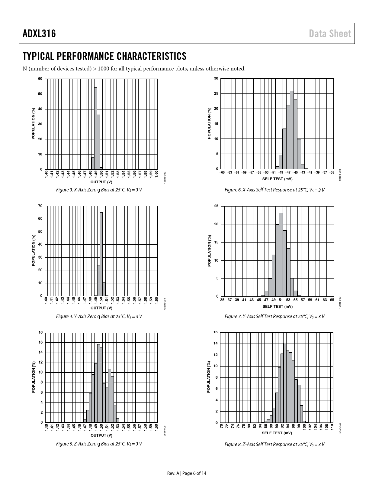

ADXL316. Data Sheet. TYPICAL PERFORMANCE CHARACTERISTICS. TION. –65 –63 –61 –59 –57 –55 –53 –51 –49 –47 –45 –43 –41 –39 –37 –35
ADXL316 Data Sheet TYPICAL PERFORMANCE CHARACTERISTICS TION –65 –63 –61 –59 –57 –55 –53 –51 –49 –47 –45 –43 –41 –39 –37 –35
N (number of devices tested) > 1000 for all typical performance plots, unless otherwise noted.
60 30 50 25 ) 40 ) 20 % % ( ( TION 30 TION A 15 A L L PU PU PO 20 PO 10 10 5 0 0 40 41 42 43 44 45 46 47 48 49 50 51 52 53 54 55 56 57 58 59 60 –65 –63 –61 –59 –57 –55 –53 –51 –49 –47 –45 –43 –41 –39 –37 –35
006
1. 1. 1. 1. 1. 1. 1. 1. 1. 1. 1. 1. 1. 1. 1. 1. 1. 1. 1. 1. 1.
003
SELF TEST (mV) OUTPUT (V)
13686- 13686- Figure 3. X-Axis Zero g Bias at 25°C, VS = 3 V Figure 6. X-Axis Self Test Response at 25°C, VS = 3 V
70 25 60 20 50 ) ) % % ( ( 15 40 TION TION A A L L 30 PU PU 10 PO PO 20 5 10 0 0 40 41 42 43 44 45 46 47 48 49 50 51 52 53 54 55 56 57 58 59 60 35 37 39 41 43 45 47 49 51 53 55 57 59 61 63 65
007 004
1. 1. 1. 1. 1. 1. 1. 1. 1. 1. 1. 1. 1. 1. 1. 1. 1. 1. 1. 1. 1. OUTPUT (V) SELF TEST (mV)
13686- 13686- Figure 4. Y-Axis Zero g Bias at 25°C, VS = 3 V Figure 7. Y-Axis Self Test Response at 25°C, VS = 3 V
18 16 16 14 14 12 ) 12 ) % % ( 10 ( 10 TION TION A 8 A L 8 L PU PU 6 PO 6 PO 4 4 2 2 0 0 0 2 4 6 8 0 2 4 6 8 0 2 4 6 8 0 2 4 6 8 0 40 41 42 43 44 45 46 47 48 49 50 51 52 53 54 55 56 57 58 59 60 7 7 7 7 7 8 8 8 8 8 9 9 9 9 9 0 0 0 0 0 1
008
005
1 1 1 1 1 1 SELF TEST (mV) OUTPUT (V)
13686- 13686- Figure 5. Z-Axis Zero g Bias at 25°C, VS = 3 V Figure 8. Z-Axis Self Test Response at 25°C, VS = 3 V Rev. A | Page 6 of 14 Document Outline FEATURES APPLICATIONS GENERAL DESCRIPTION FUNCTIONAL BLOCK DIAGRAM TABLE OF CONTENTS REVISION HISTORY SPECIFICATIONS ABSOLUTE MAXIMUM RATINGS ESD CAUTION PIN CONFIGURATION AND FUNCTION DESCRIPTIONS TYPICAL PERFORMANCE CHARACTERISTICS THEORY OF OPERATION MECHANICAL SENSOR PERFORMANCE APPLICATIONS INFORMATION POWER SUPPLY DECOUPLING SETTING THE BANDWIDTH USING CX, CY, AND CZ SELF TEST DESIGN TRADE-OFFS FOR SELECTING FILTER CHARACTERISTICS: THE NOISE/BW TRADE-OFF USE WITH OPERATING VOLTAGES OTHER THAN 3 V AXES OF ACCELERATION SENSITIVITY LAYOUT AND DESIGN RECOMMENDATIONS OUTLINE DIMENSIONS ORDERING GUIDE AUTOMOTIVE PRODUCTS
