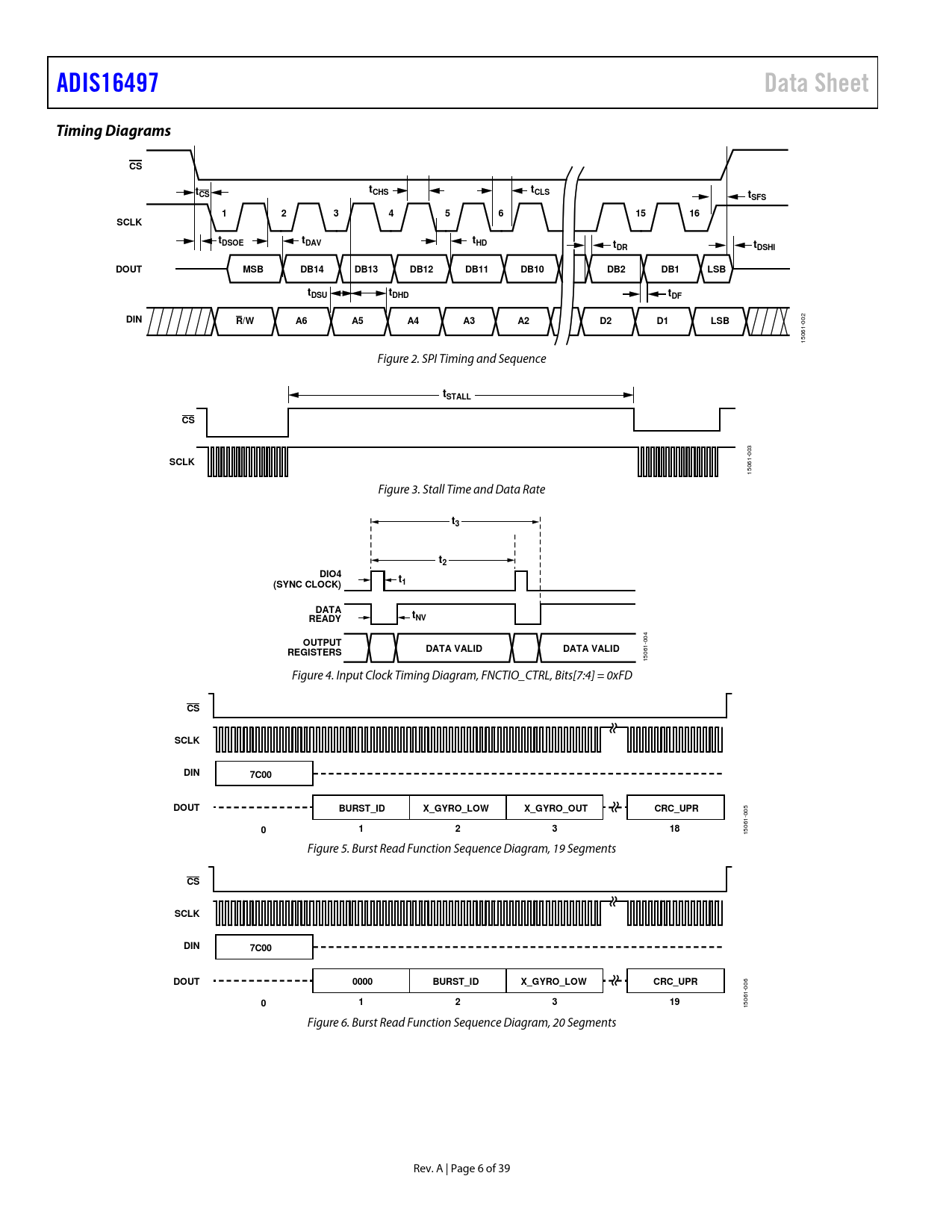

ADIS16497. Data Sheet. Timing Diagrams. CHS. tCLS. tSFS. SCLK. DSOE. DAV. tHD. DSHI. DOUT. MSB. DB14. DB13. DB12. DB11. DB10. DB2. DB1. LSB. DSU. DHD. tDF. DIN. R/W
ADIS16497 Data Sheet Timing Diagrams CHS tCLS tSFS SCLK DSOE DAV tHD DSHI DOUT MSB DB14 DB13 DB12 DB11 DB10 DB2 DB1 LSB DSU DHD tDF DIN R/W
ADIS16497 Data Sheet Timing Diagrams CS t t CS CHS tCLS tSFS 1 2 3 4 5 6 15 16 SCLK t t DSOE DAV tHD t t DR DSHI DOUT MSB DB14 DB13 DB12 DB11 DB10 DB2 DB1 LSB t t DSU DHD tDF DIN R/W A6 A5 A4 A3 A2 D2 D1 LSB
002 15061- Figure 2. SPI Timing and Sequence
tSTALL CS
003
SCLK
15061- Figure 3. Stall Time and Data Rate
t3 t2 DIO4 t1 (SYNC CLOCK) DATA t READY NV OUTPUT
004
REGISTERS DATA VALID DATA VALID
15061- Figure 4. Input Clock Timing Diagram, FNCTIO_CTRL, Bits[7:4] = 0xFD
CS SCLK DIN 7C00 DOUT BURST_ID X_GYRO_LOW X_GYRO_OUT CRC_UPR
005
0 1 2 3 18
15061- Figure 5. Burst Read Function Sequence Diagram, 19 Segments
CS SCLK DIN 7C00 DOUT 0000 BURST_ID X_GYRO_LOW CRC_UPR
006
0 1 2 3 19
