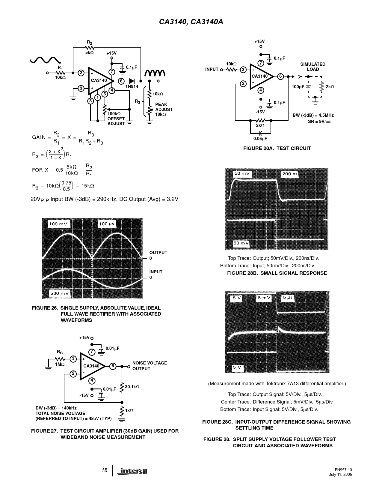

CA3140, CA3140A. +15V. 0.1. 10k. SIMULATED. INPUT. LOAD. CA3140. 1N914. 100pF. PEAK. ADJUST. 100k. -15V. BW (-3dB) = 4.5MHz. OFFSET. SR = 9V/. 0.05
CA3140, CA3140A +15V 0.1 10k SIMULATED INPUT LOAD CA3140 1N914 100pF PEAK ADJUST 100k -15V BW (-3dB) = 4.5MHz OFFSET SR = 9V/ 0.05
CA3140, CA3140A R +15V 2 5k
+15V 0.1
µ
F 10k
7 SIMULATED R 0.1
µ
F 1 INPUT 3 + LOAD 7 2 - 10k
CA3140 6 CA3140 6 2 - 3 1N914 + 100pF 2k
4 4 5 10k
1 8 R3 PEAK 0.1
µ
F ADJUST 100k
-15V 10k
µ
s ADJUST 2k
Ω R R GAIN 2 = ---- = X 3 = -------------- R R R
0.05
µ
F
+ R 1 1 2 3 2
FIGURE 28A. TEST CIRCUIT
X + X  R = --------- R 3  1 – X  1 5kΩ R FOR X = 0.5 ------- 2 = ---- 10kΩ R1   R = 10kΩ 0.75 ------ = 15kΩ 3  0.5  20VP-P Input BW (-3dB) = 290kHz, DC Output (Avg) = 3.2V
OUTPUT 0
Top Trace: Output; 50mV/Div., 200ns/Div. Bottom Trace: Input; 50mV/Div., 200ns/Div.
INPUT FIGURE 28B. SMALL SIGNAL RESPONSE 0 FIGURE 26. SINGLE SUPPLY, ABSOLUTE VALUE, IDEAL FULL WAVE RECTIFIER WITH ASSOCIATED WAVEFORMS +15V 0.01
µ
F R 7 S 3 + 1M
NOISE VOLTAGE CA3140 6 OUTPUT 2 - 4
(Measurement made with Tektronix 7A13 differential amplifier.)
30.1k
0.01
µ
F -15V
Top Trace: Output Signal; 5V/Div., 5µs/Div. Center Trace: Difference Signal; 5mV/Div., 5µs/Div.
BW (-3dB) = 140kHz 1k
Ω Bottom Trace: Input Signal; 5V/Div., 5µs/Div.
TOTAL NOISE VOLTAGE (REFERRED TO INPUT) = 48
µ
V (TYP) FIGURE 28C. INPUT-OUTPUT DIFFERENCE SIGNAL SHOWING SETTLING TIME FIGURE 27. TEST CIRCUIT AMPLIFIER (30dB GAIN) USED FOR WIDEBAND NOISE MEASUREMENT FIGURE 28. SPLIT SUPPLY VOLTAGE FOLLOWER TEST CIRCUIT AND ASSOCIATED WAVEFORMS
