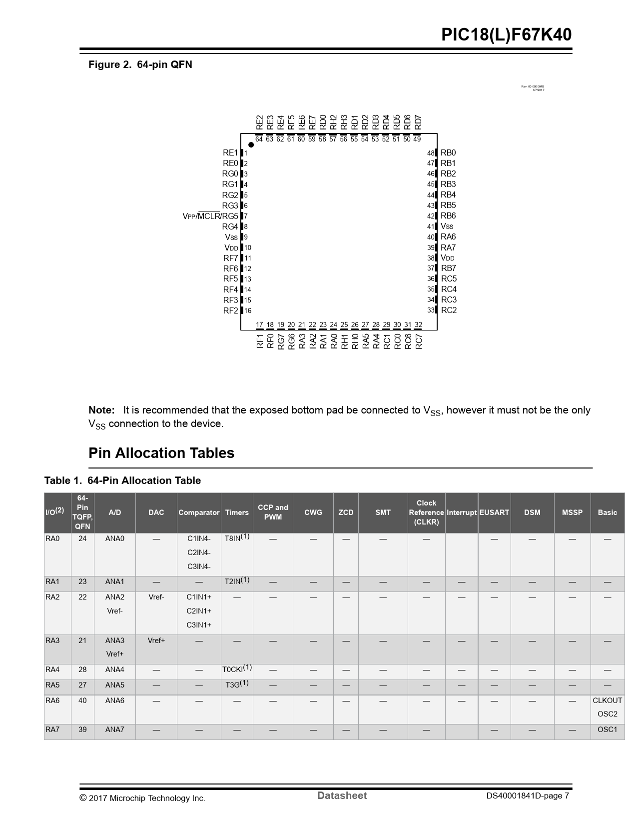

PIC18(L)F67K40. Figure 2. 64-pin QFN. Note: . Pin Allocation Tables. Table 1. 64-Pin Allocation Table. 64-. Clock. Pin. CCP and. I/O(2)
PIC18(L)F67K40 Figure 2. 64-pin QFN Note:  Pin Allocation Tables Table 1. 64-Pin Allocation Table 64- Clock Pin CCP and I/O(2)
Filename: 00-000064B.vsd Title: 64-pin QFN Last Edit: 3/7/2017
PIC18(L)F67K40
First Used: N/A Notes: Generic 64-pin QFN diagram
Rev. 00-000 064B 3/7/201 7 2 3 4 5 6 7 0 2 3 1 2 3 4 5 6 7 E E E E E E D H H D D D D D D D R R R R R R R R R R R R R R R R 64 63 62 61 60 59 58 57 56 55 54 53 52 51 50 49 RE1 1 48 RB0 RE0 2 47 RB1 RG0 3 46 RB2 RG1 4 45 RB3 RG2 5 44 RB4 RG3 6 43 RB5 VPP/MCLR/RG5 7 42 RB6 RG4 8 41 VSS VSS 9 40 RA6 VDD 10 39 RA7 RF7 11 38 VDD RF6 12 37 RB7 RF5 13 36 RC5 RF4 14 35 RC4 RF3 15 34 RC3 RF2 16 33 RC2 17 18 19 20 21 22 23 24 25 26 27 28 29 30 31 32 1 0 7 6 3 2 1 0 1 0 5 4 1 0 6 7 F F G G A A A A H H A A C C C C R R R R R R R R R R R R R R R R
Note: 
It is recommended that the exposed bottom pad be connected to VSS, however it must not be the only VSS connection to the device.
Pin Allocation Tables Table 1. 64-Pin Allocation Table 64- Clock Pin CCP and I/O(2) A/D DAC Comparator Timers CWG ZCD SMT Reference Interrupt EUSART DSM MSSP Basic TQFP, PWM (CLKR) QFN
RA0 24 ANA0 — C1IN4- T8IN(1) — — — — — — — — — C2IN4- C3IN4- RA1 23 ANA1 — — T2IN(1) — — — — — — — — — — RA2 22 ANA2 Vref- C1IN1+ — — — — — — — — — — — Vref- C2IN1+ C3IN1+ RA3 21 ANA3 Vref+ — — — — — — — — — — — — Vref+ RA4 28 ANA4 — — T0CKI(1) — — — — — — — — — — RA5 27 ANA5 — — T3G(1) — — — — — — — — — — RA6 40 ANA6 — — — — — — — — — — — — CLKOUT OSC2 RA7 39 ANA7 — — — — — — — — — — — OSC1 © 2017 Microchip Technology Inc.
