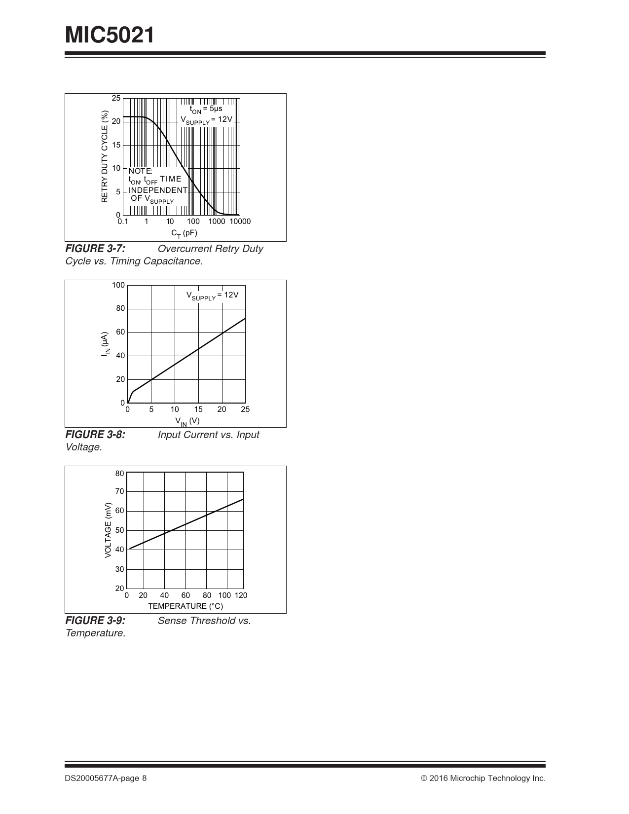

MIC5021 RETRY DUTY CYCLE (%) 25 tON = 5μs. VSUPPLY = 12V 20. 10 NOT E:. tON, tOFF T I M E. INDEPENDENT. OF VSUPPLY 5. 0.1 1 10. 100
MIC5021 RETRY DUTY CYCLE (%) 25 tON = 5μs VSUPPLY = 12V 20 10 NOT E: tON, tOFF T I M E INDEPENDENT OF VSUPPLY 5 0.1 1 10 100
VSUPPLY = 12V 20
15
10 NOT E:
tON, tOFF T I M E
INDEPENDENT
OF VSUPPLY 5
0
0.1 1 10
100
CT (pF) 1000 10000 FIGURE 3-7:
Overcurrent Retry Duty
Cycle vs. Timing Capacitance.
100
VSUPPLY = 12V IIN (μA) 80
60
40
20
0 0 5 FIGURE 3-8:
Voltage. 10
15
VIN (V) 20 25 Input Current vs. Input 80 VOLTAGE (mV) 70
60
50
40
30
20 0 20 FIGURE 3-9:
Temperature. DS20005677A-page 8 40
60
80 100 120
TEMPERATURE (°C) Sense Threshold vs.  2016 Microchip Technology Inc.
