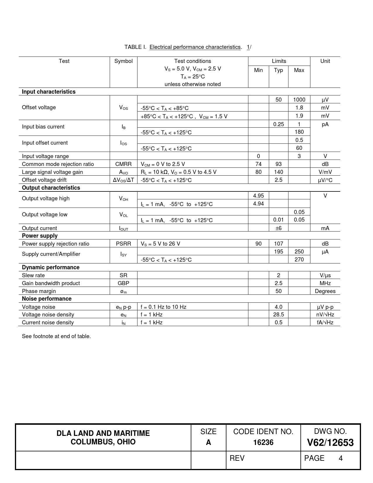

DescriptionLow Power, Rail-to-Rail Output, Precision JFET Quad Amplifier
Pages / Page8 / 4 — Input characteristics. Output characteristics. Power supply. Dynamic …
File Format / SizePDF / 178 Kb
Input characteristics. Output characteristics. Power supply. Dynamic performance. Noise performance. DLA LAND AND MARITIME
Input characteristics Output characteristics Power supply Dynamic performance Noise performance DLA LAND AND MARITIME
TABLE I. Electrical performance characteristics. 1/ Test Symbol Test conditions Limits Unit VS = 5.0 V, VCM = 2.5 V Min Typ Max TA = 25°C unless otherwise noted
50 1000 µV Offset voltage VOS -55°C < TA < +85°C 1.8 mV +85°C < TA < +125°C , VCM = 1.5 V 1.9 mV Input bias current IB 0.25 1 pA -55°C < TA < +125°C 180 Input offset current IOS 0.5 -55°C < TA < +125°C 60 Input voltage range 0 3 V Common mode rejection ratio CMRR VCM = 0 V to 2.5 V 74 93 dB Large signal voltage gain AVO RL = 10 kΩ, VO = 0.5 V to 4.5 V 80 140 V/mV Offset voltage drift ΔVOS/ΔT -55°C < TA < +125°C 2.5 µV/°C
Output voltage high VOH 4.95 V IL = 1 mA, -55°C to +125°C 4.94 Output voltage low VOL 0.05 IL = 1 mA, -55°C to +125°C 0.01 0.05 Output current IOUT ±6 mA
Power supply
Power supply rejection ratio PSRR VS = 5 V to 26 V 90 107 dB Supply current/Amplifier ISY 195 250 µA -55°C < TA < +125°C 270
Dynamic performance
Slew rate SR 2 V/µs Gain bandwidth product GBP 2.5 MHz Phase margin øm 50 Degrees
Noise performance
Voltage noise eN p-p f = 0.1 Hz to 10 Hz 4.0 µV p-p Voltage noise density eN f = 1 kHz 28.5 nV/√Hz Current noise density iN f = 1 kHz 0.5 fA/√Hz See footnote at end of table.
