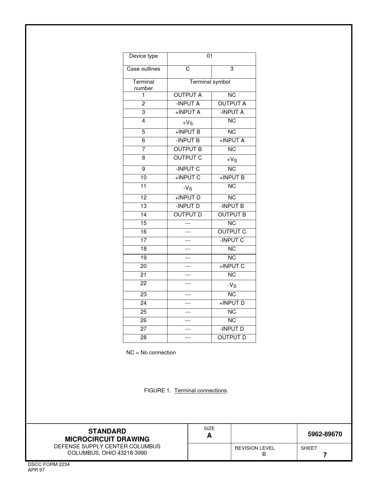

STANDARD. 5962-89670. MICROCIRCUIT DRAWING
STANDARD 5962-89670 MICROCIRCUIT DRAWING
Device type 01 Case outlines C 3 Terminal Terminal symbol number 1 OUTPUT A NC 2 -INPUT A OUTPUT A 3 +INPUT A -INPUT A 4 +VS NC 5 +INPUT B NC 6 -INPUT B +INPUT A 7 OUTPUT B NC 8 OUTPUT C +VS 9 -INPUT C NC 10 +INPUT C +INPUT B 11 -VS NC 12 +INPUT D NC 13 -INPUT D -INPUT B 14 OUTPUT D OUTPUT B 15 --- NC 16 --- OUTPUT C 17 --- -INPUT C 18 --- NC 19 --- NC 20 --- +INPUT C 21 --- NC 22 --- -VS 23 --- NC 24 --- +INPUT D 25 --- NC 26 --- NC 27 --- -INPUT D 28 --- OUTPUT D NC = No connection FIGURE 1. Terminal connections.
