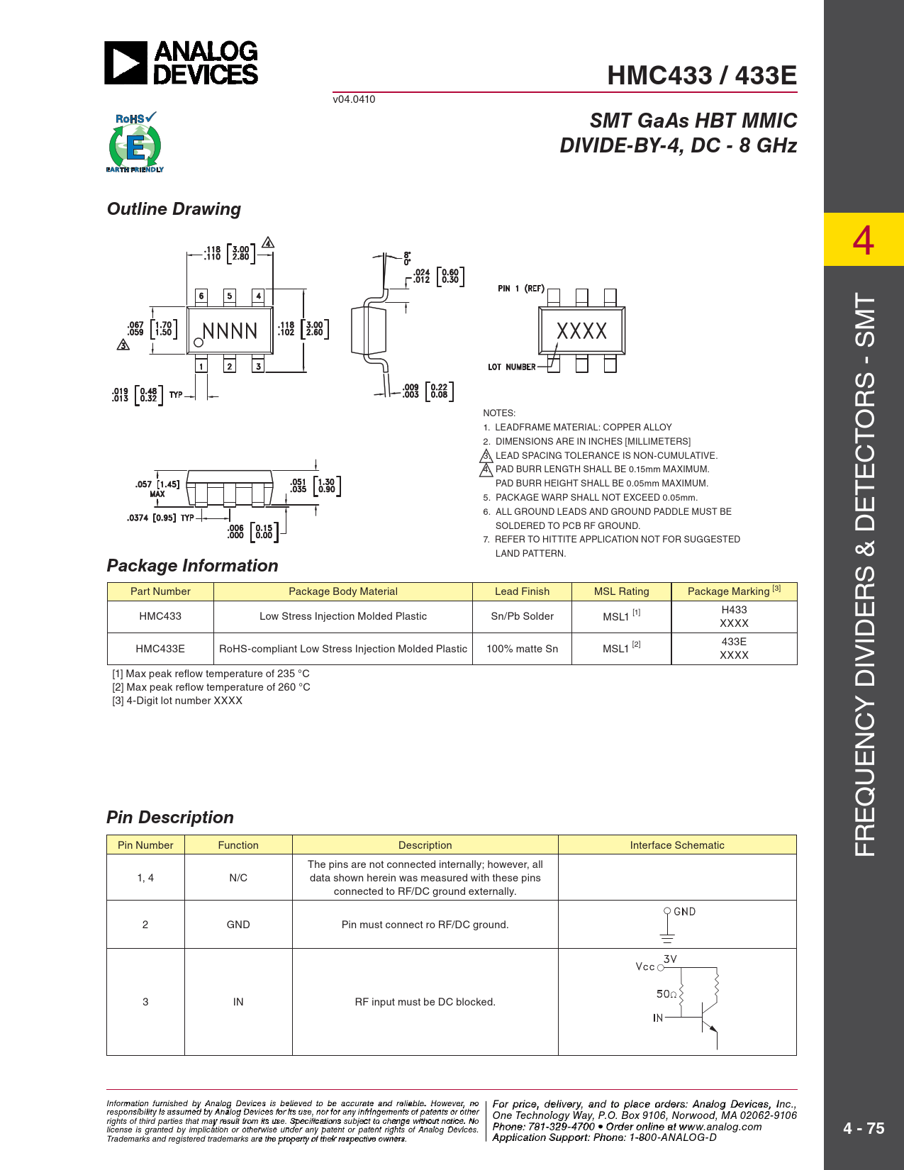

HMC433 / 433E. SMT GaAs HBT MMIC. DIVIDE-BY-4, DC - 8 GHz. Outline Drawing. Package Information. Pin Description. 4 - 75
HMC433 / 433E SMT GaAs HBT MMIC DIVIDE-BY-4, DC - 8 GHz Outline Drawing Package Information Pin Description 4 - 75
HMC433 / 433E
v04.0410
4 T S - SM R NOTES: 1. LEADFRAME MATERIAL: COPPER ALLOY O 2. DIMENSIONS ARE IN INCHES [MILLIMETERS] T 3. LEAD SPACING TOLERANCE IS NON-CUMULATIVE. C 4. PAD BURR LENGTH SHALL BE 0.15mm MAXIMUM. E PAD BURR HEIGHT SHALL BE 0.05mm MAXIMUM. T 5. PACKAGE WARP SHALL NOT EXCEED 0.05mm. 6. ALL GROUND LEADS AND GROUND PADDLE MUST BE E SOLDERED TO PCB RF GROUND. 7. REFER TO HITTITE APPLICATION NOT FOR SUGGESTED LAND PATTERN. & D
Package Information
S Part Number Package Body Material Lead Finish MSL Rating Package Marking [3] R [1] H433 HMC433 Low Stress Injection Molded Plastic Sn/Pb Solder MSL1 E XXXX [2] 433E ID HMC433E RoHS-compliant Low Stress Injection Molded Plastic 100% matte Sn MSL1 XXXX IV [1] Max peak refl ow temperature of 235 °C [2] Max peak refl ow temperature of 260 °C [3] 4-Digit lot number XXXX Y D NC E U Q
Pin Description
E R Pin Number Function Description Interface Schematic F The pins are not connected internally; however, all 1, 4 N/C data shown herein was measured with these pins connected to RF/DC ground externally. 2 GND Pin must connect ro RF/DC ground. 3 IN RF input must be DC blocked. Info F rmoatr pr ion f iurcne, de ished b ly iv A e n r al y o a g D n evd to p ices is bla eli c eve o ed t rde o be ras: H ccuratite tiatne M d reli iacr ble ow . Ho av wev e C er, n o o rpo Fora r t p iro ic n e ,, 2 d 0 eli A ve lrpha R y, and toad, C o place hoel rd m er s s fo : Ard, MA 01 nalog Devic 8 e 2 s 4 , Inc., responsibility is assumed by Analog Devices for its use, nor for any infringements of patents or other One Technology Way, P.O. Box 9106, Norwood, MA 02062-9106 Phone: 978-250-3343 Fax: 978-250-3373 O rights of third parties that may result from its use. Specifications subject to change without notice. No P rde hone r O : 7 n 81- -3li 2n 9 e a -47 t w 0 w 0 • O w rd .ehit r o t nilte in .c e ao t m license is granted by implication or otherwise under any patent or patent rights of Analog Devices. www.analog.com
4 - 75
