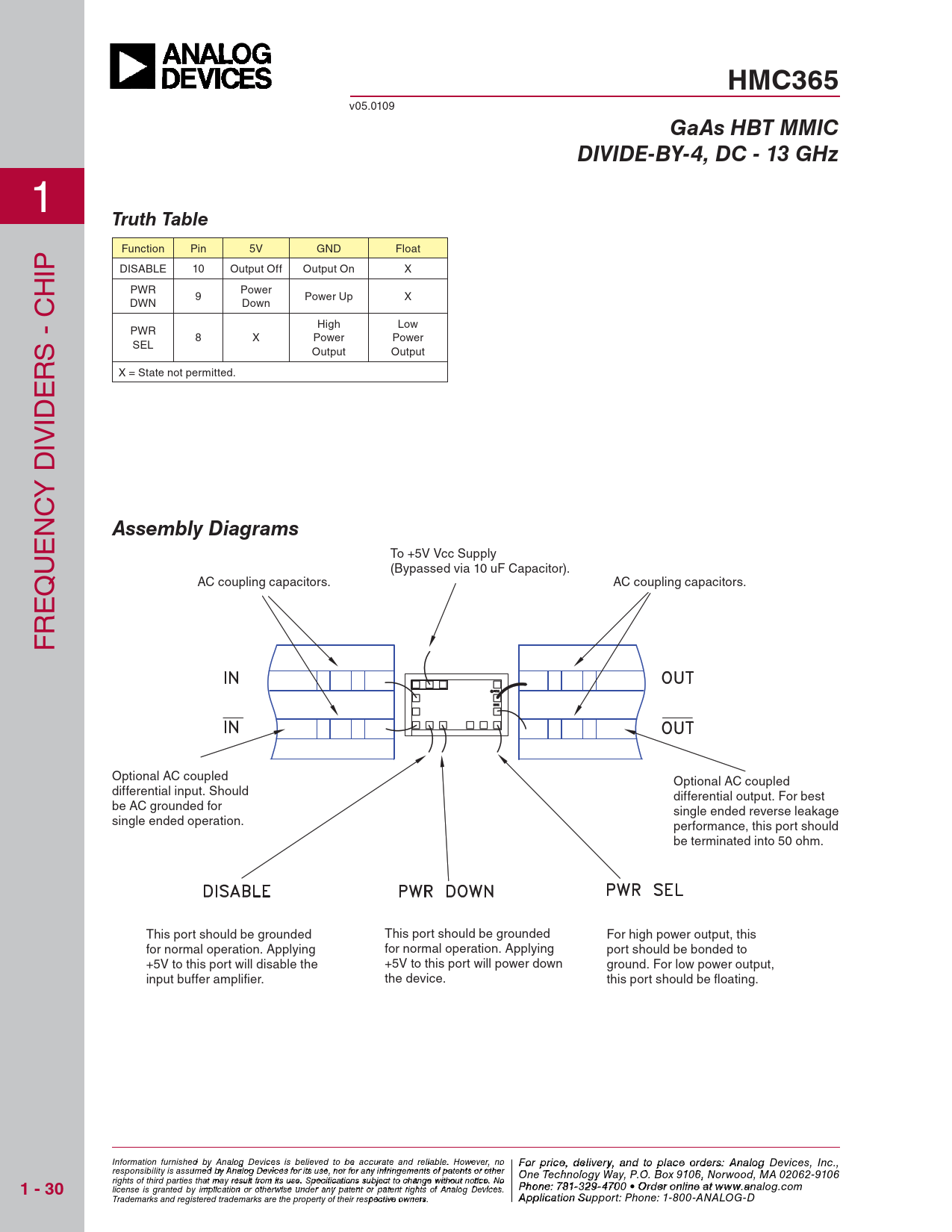

Truth Table
Function Pin 5V GND Float IP DISABLE 10 Output Off Output On X H PWR Power 9 Power Up X DWN Down High Low PWR 8 X Power Power S - C SEL Output Output R X = State not permitted. E ID IV Y D NC
Assembly Diagrams
E To +5V Vcc Supply U (Bypassed via 10 uF Capacitor). Q AC coupling capacitors. AC coupling capacitors. E R F Optional AC coupled Optional AC coupled differential input. Should differential output. For best be AC grounded for single ended reverse leakage single ended operation. performance, this port should be terminated into 50 ohm. This port should be grounded This port should be grounded For high power output, this for normal operation. Applying for normal operation. Applying port should be bonded to +5V to this port will disable the +5V to this port will power down ground. For low power output, input buffer amplifi er. the device. this port should be fl oating. Information furnish F ed obr pri y Anal ce, de og Device li s vie s r beyli, a eve nd to pla d to be accura ce o te and rder reliabl s e , pl . Ho ease co wever, no For price, delivery, and to place orders: Analog Devices, Inc., responsibility is assumed by Analog Devices for its use, nor for any infringements of patents or other ntact Hittite Microwave Corporation: One Technology Way, P.O. Box 9106, Norwood, MA 02062-9106 rights of third parties that may result from its use. Specifications subject to change without notice. No
