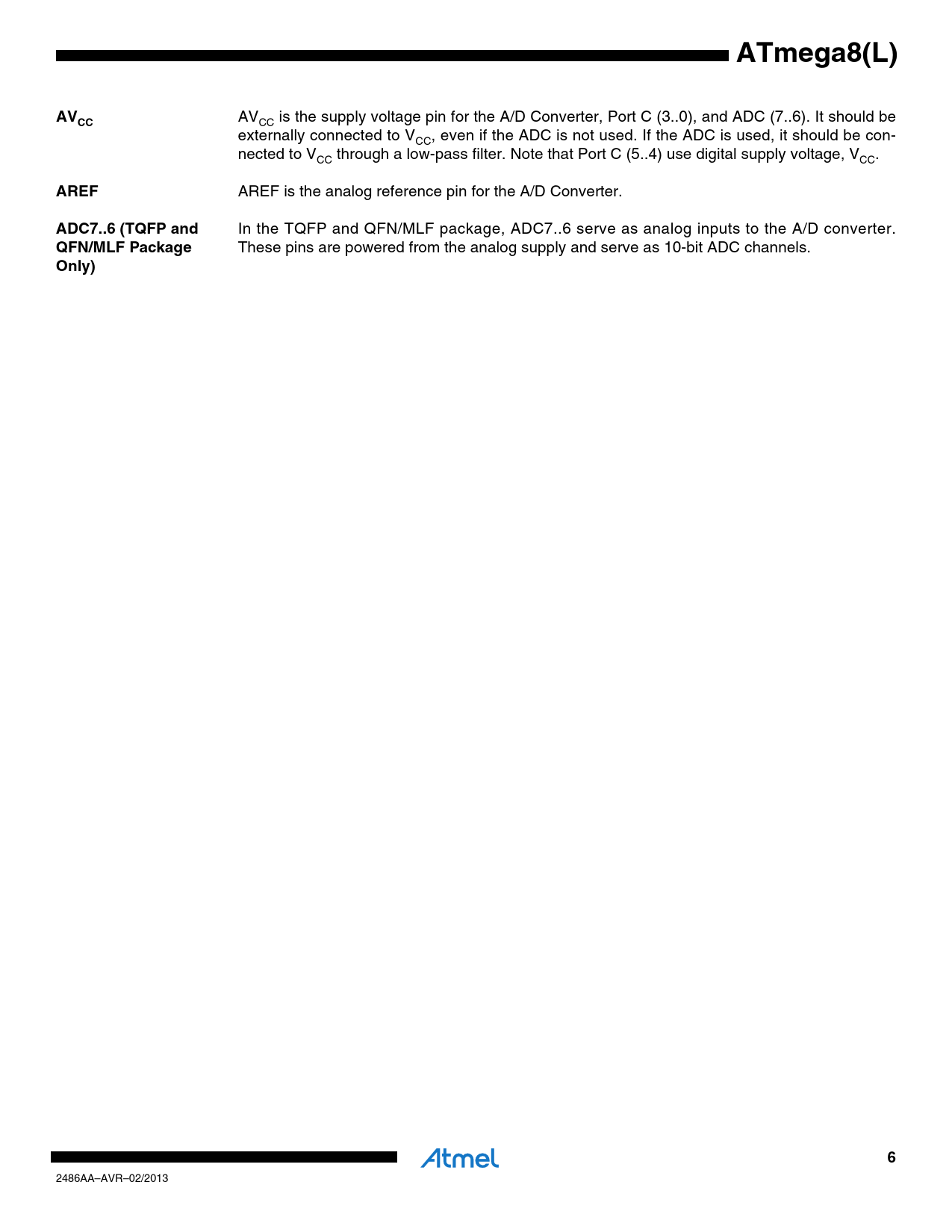

ATmega8(L). AREF. ADC7..6 (TQFP and. QFN/MLF Package. Only)
ATmega8(L) AREF ADC7..6 (TQFP and QFN/MLF Package Only)
ATmega8(L) AV
AV is the supply voltage pin for the A/D Converter, Port C (3..0), and ADC (7..6). It should be
CC
CC externally connected to V , even if the ADC is not used. If the ADC is used, it should be con- CC nected to V through a low-pass filter. Note that Port C (5..4) use digital supply voltage, V . CC CC
AREF
AREF is the analog reference pin for the A/D Converter.
ADC7..6 (TQFP and
In the TQFP and QFN/MLF package, ADC7..6 serve as analog inputs to the A/D converter.
QFN/MLF Package
These pins are powered from the analog supply and serve as 10-bit ADC channels.
Only) 6
