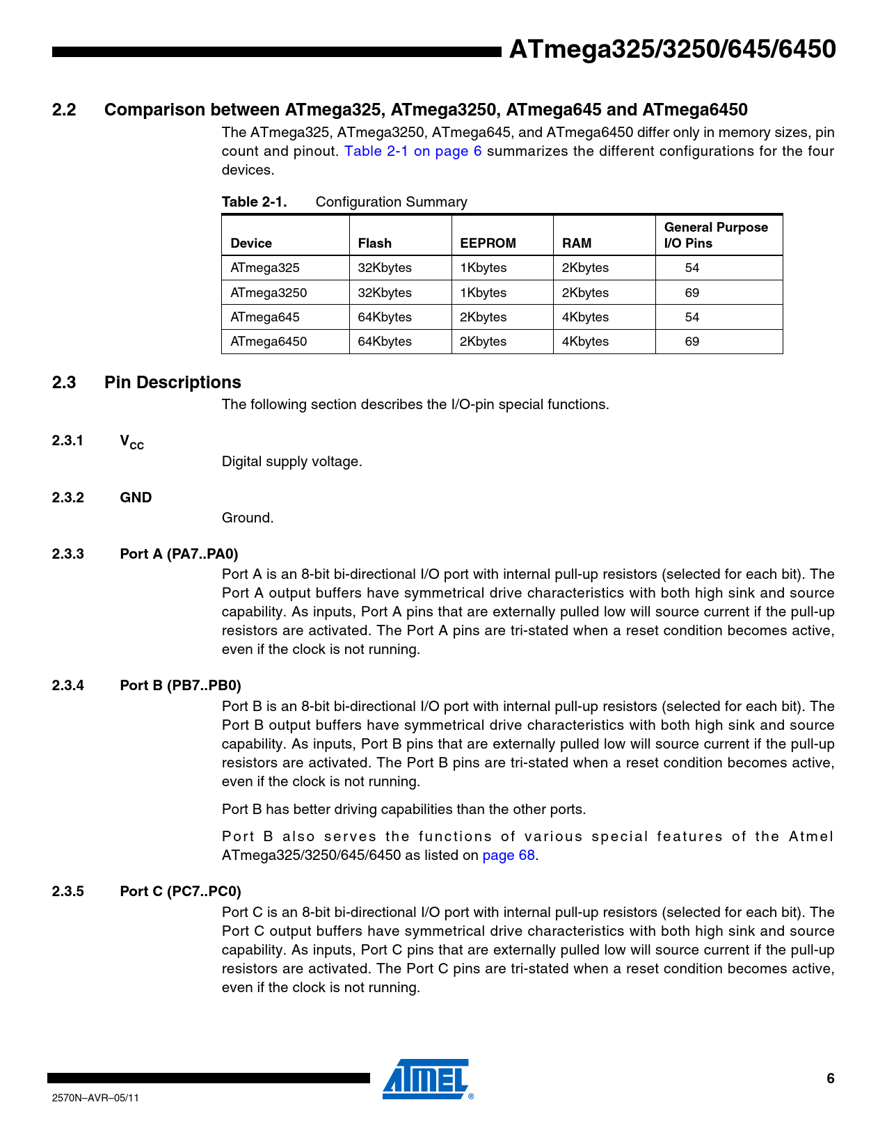

ATmega325/3250/645/6450 2.2 Comparison between ATmega325, ATmega3250, ATmega645 and ATmega6450
The ATmega325, ATmega3250, ATmega645, and ATmega6450 differ only in memory sizes, pin count and pinout. Table 2-1 on page 6 summarizes the different configurations for the four devices.
Table 2-1.
Configuration Summary
General Purpose Device Flash EEPROM RAM I/O Pins
ATmega325 32Kbytes 1Kbytes 2Kbytes 54 ATmega3250 32Kbytes 1Kbytes 2Kbytes 69 ATmega645 64Kbytes 2Kbytes 4Kbytes 54 ATmega6450 64Kbytes 2Kbytes 4Kbytes 69
2.3 Pin Descriptions
The following section describes the I/O-pin special functions.
2.3.1 VCC
Digital supply voltage.
2.3.2 GND
Ground.
2.3.3 Port A (PA7..PA0)
Port A is an 8-bit bi-directional I/O port with internal pull-up resistors (selected for each bit). The Port A output buffers have symmetrical drive characteristics with both high sink and source capability. As inputs, Port A pins that are externally pulled low will source current if the pull-up resistors are activated. The Port A pins are tri-stated when a reset condition becomes active, even if the clock is not running.
2.3.4 Port B (PB7..PB0)
Port B is an 8-bit bi-directional I/O port with internal pull-up resistors (selected for each bit). The Port B output buffers have symmetrical drive characteristics with both high sink and source capability. As inputs, Port B pins that are externally pulled low will source current if the pull-up resistors are activated. The Port B pins are tri-stated when a reset condition becomes active, even if the clock is not running. Port B has better driving capabilities than the other ports. P o r t B a l s o s e r v e s t h e f u n c t i o n s o f v a r i o u s s p e c i a l f e a t u r e s o f t h e A t m e l ATmega325/3250/645/6450 as listed on page 68.
2.3.5 Port C (PC7..PC0)
Port C is an 8-bit bi-directional I/O port with internal pull-up resistors (selected for each bit). The Port C output buffers have symmetrical drive characteristics with both high sink and source capability. As inputs, Port C pins that are externally pulled low will source current if the pull-up resistors are activated. The Port C pins are tri-stated when a reset condition becomes active, even if the clock is not running.
