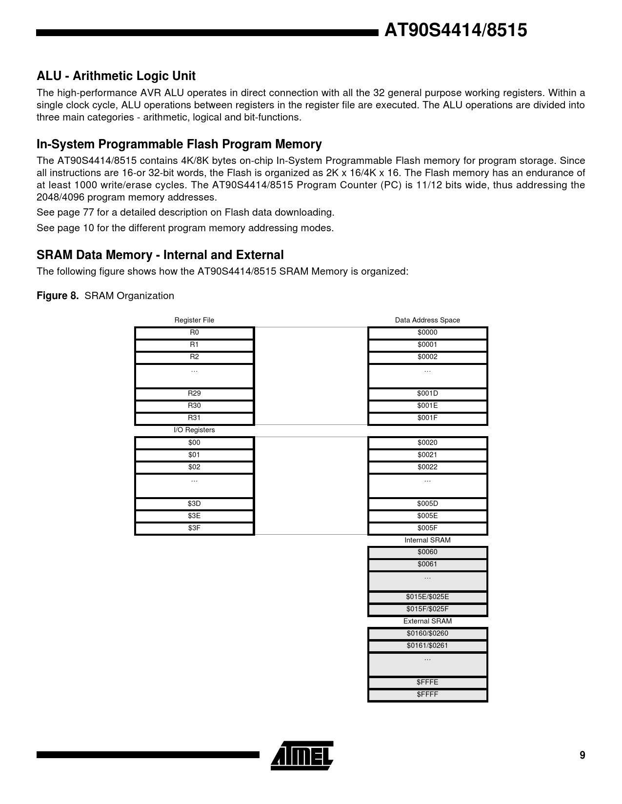

AT90S4414/8515 ALU - Arithmetic Logic Unit
The high-performance AVR ALU operates in direct connection with all the 32 general purpose working registers. Within a single clock cycle, ALU operations between registers in the register file are executed. The ALU operations are divided into three main categories - arithmetic, logical and bit-functions.
In-System Programmable Flash Program Memory
The AT90S4414/8515 contains 4K/8K bytes on-chip In-System Programmable Flash memory for program storage. Since all instructions are 16-or 32-bit words, the Flash is organized as 2K x 16/4K x 16. The Flash memory has an endurance of at least 1000 write/erase cycles. The AT90S4414/8515 Program Counter (PC) is 11/12 bits wide, thus addressing the 2048/4096 program memory addresses. See page 77 for a detailed description on Flash data downloading. See page 10 for the different program memory addressing modes.
SRAM Data Memory - Internal and External
The following figure shows how the AT90S4414/8515 SRAM Memory is organized:
Figure 8.
SRAM Organization Register File Data Address Space R0 $0000 R1 $0001 R2 $0002 … … R29 $001D R30 $001E R31 $001F I/O Registers $00 $0020 $01 $0021 $02 $0022 … … $3D $005D $3E $005E $3F $005F Internal SRAM $0060 $0061 … $015E/$025E $015F/$025F External SRAM $0160/$0260 $0161/$0261 … $FFFE $FFFF
