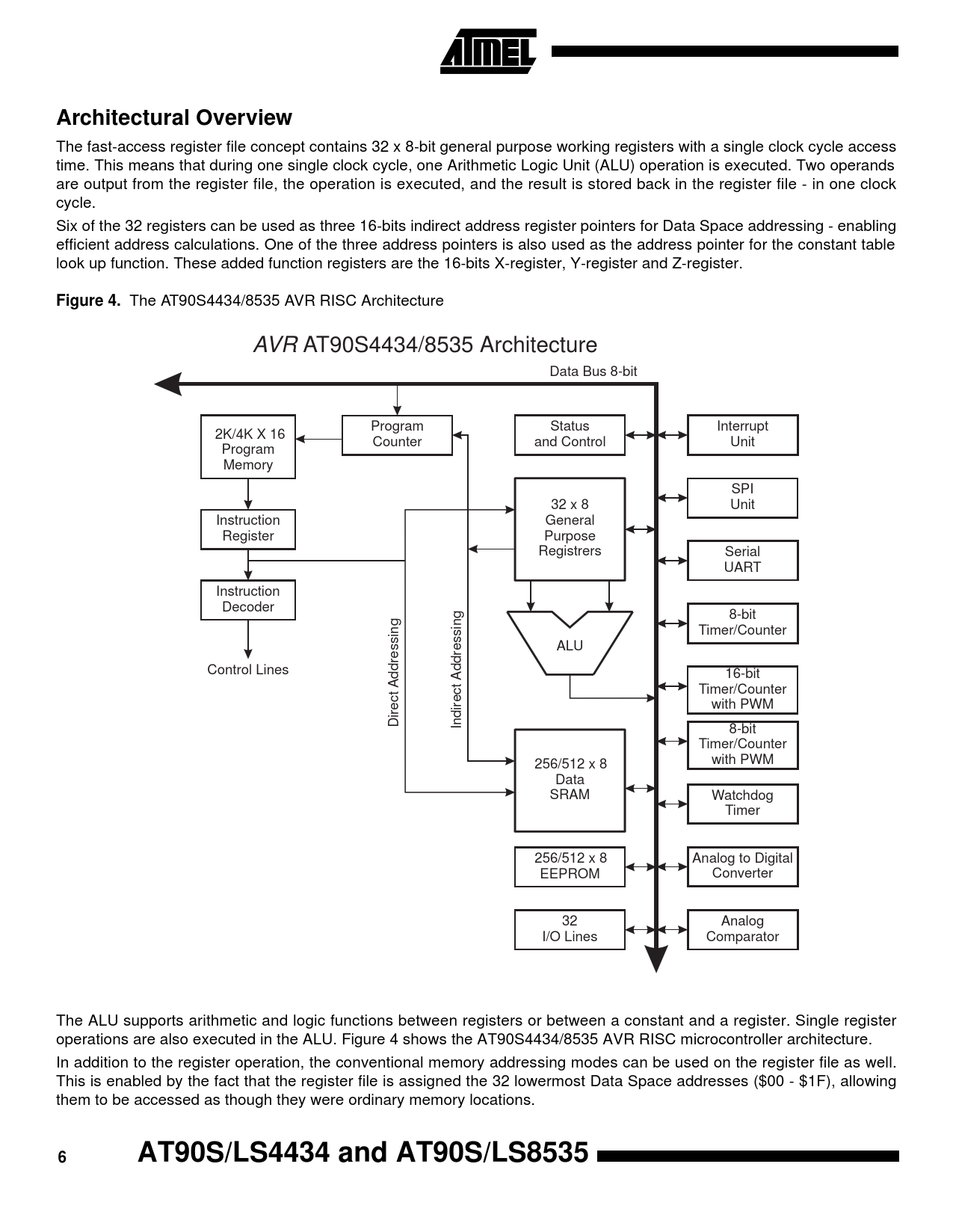

Architectural Overview
The fast-access register file concept contains 32 x 8-bit general purpose working registers with a single clock cycle access time. This means that during one single clock cycle, one Arithmetic Logic Unit (ALU) operation is executed. Two operands are output from the register file, the operation is executed, and the result is stored back in the register file - in one clock cycle. Six of the 32 registers can be used as three 16-bits indirect address register pointers for Data Space addressing - enabling efficient address calculations. One of the three address pointers is also used as the address pointer for the constant table look up function. These added function registers are the 16-bits X-register, Y-register and Z-register.
Figure 4.
The AT90S4434/8535 AVR RISC Architecture AVR AT90S4434/8535 Architecture Data Bus 8-bit Program Status Interrupt 2K/4K X 16 Counter and Control Unit Program Memory SPI 32 x 8 Unit Instruction General Register Purpose Registrers Serial UART Instruction Decoder 8-bit Timer/Counter ALU Control Lines 16-bit Timer/Counter with PWM Direct Addressing Indirect Addressing 8-bit Timer/Counter with PWM 256/512 x 8 Data SRAM Watchdog Timer 256/512 x 8 Analog to Digital EEPROM Converter 32 Analog I/O Lines Comparator The ALU supports arithmetic and logic functions between registers or between a constant and a register. Single register operations are also executed in the ALU. Figure 4 shows the AT90S4434/8535 AVR RISC microcontroller architecture. In addition to the register operation, the conventional memory addressing modes can be used on the register file as well. This is enabled by the fact that the register file is assigned the 32 lowermost Data Space addresses ($00 - $1F), allowing them to be accessed as though they were ordinary memory locations.
