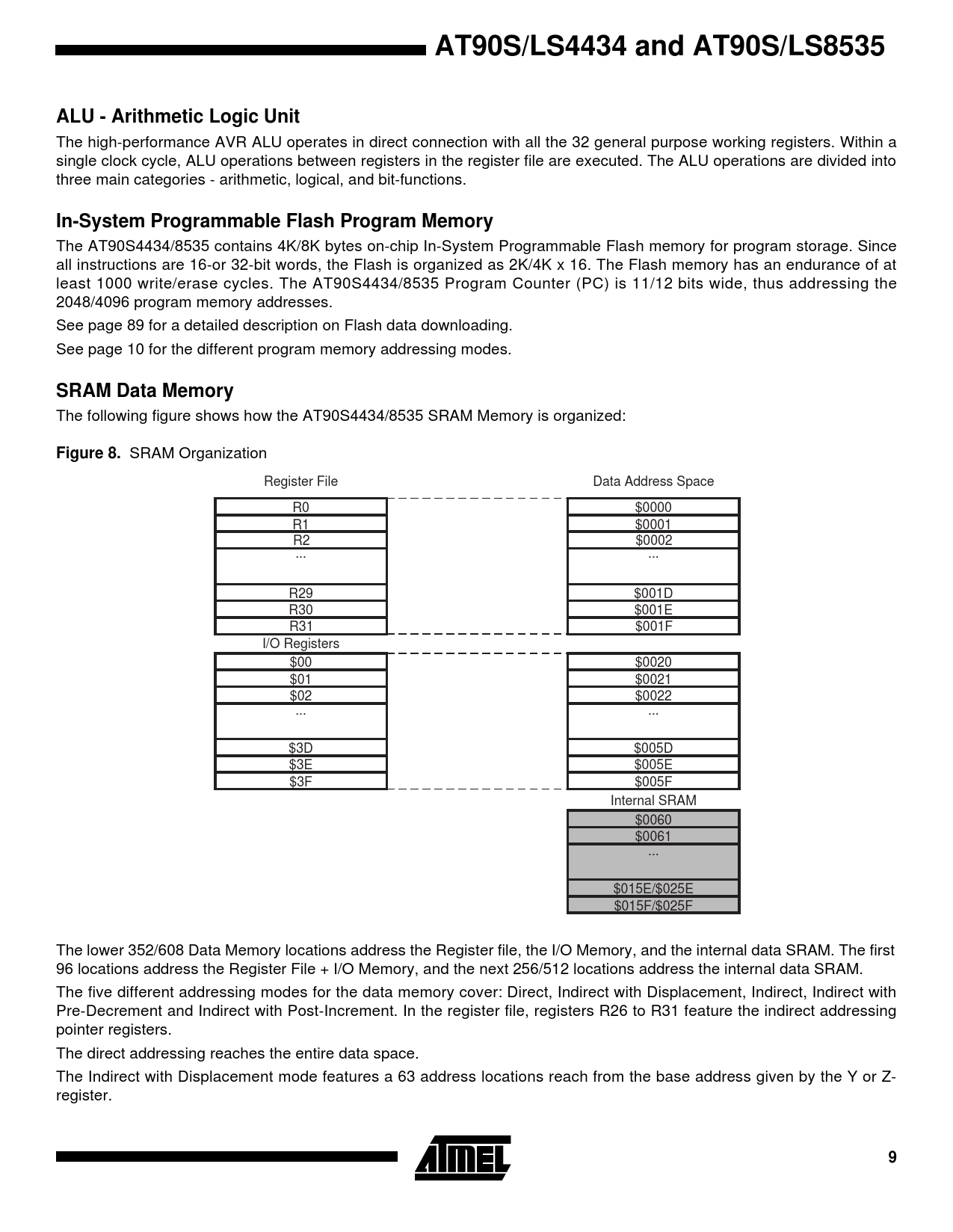

SRAM Data Memory
The following figure shows how the AT90S4434/8535 SRAM Memory is organized:
Figure 8.
SRAM Organization Register File Data Address Space R0 $0000 R1 $0001 R2 $0002 ... ... R29 $001D R30 $001E R31 $001F I/O Registers $00 $0020 $01 $0021 $02 $0022 ... ... $3D $005D $3E $005E $3F $005F Internal SRAM $0060 $0061 ... $015E/$025E $015F/$025F The lower 352/608 Data Memory locations address the Register file, the I/O Memory, and the internal data SRAM. The first 96 locations address the Register File + I/O Memory, and the next 256/512 locations address the internal data SRAM. The five different addressing modes for the data memory cover: Direct, Indirect with Displacement, Indirect, Indirect with Pre-Decrement and Indirect with Post-Increment. In the register file, registers R26 to R31 feature the indirect addressing pointer registers. The direct addressing reaches the entire data space. The Indirect with Displacement mode features a 63 address locations reach from the base address given by the Y or Z- register.
