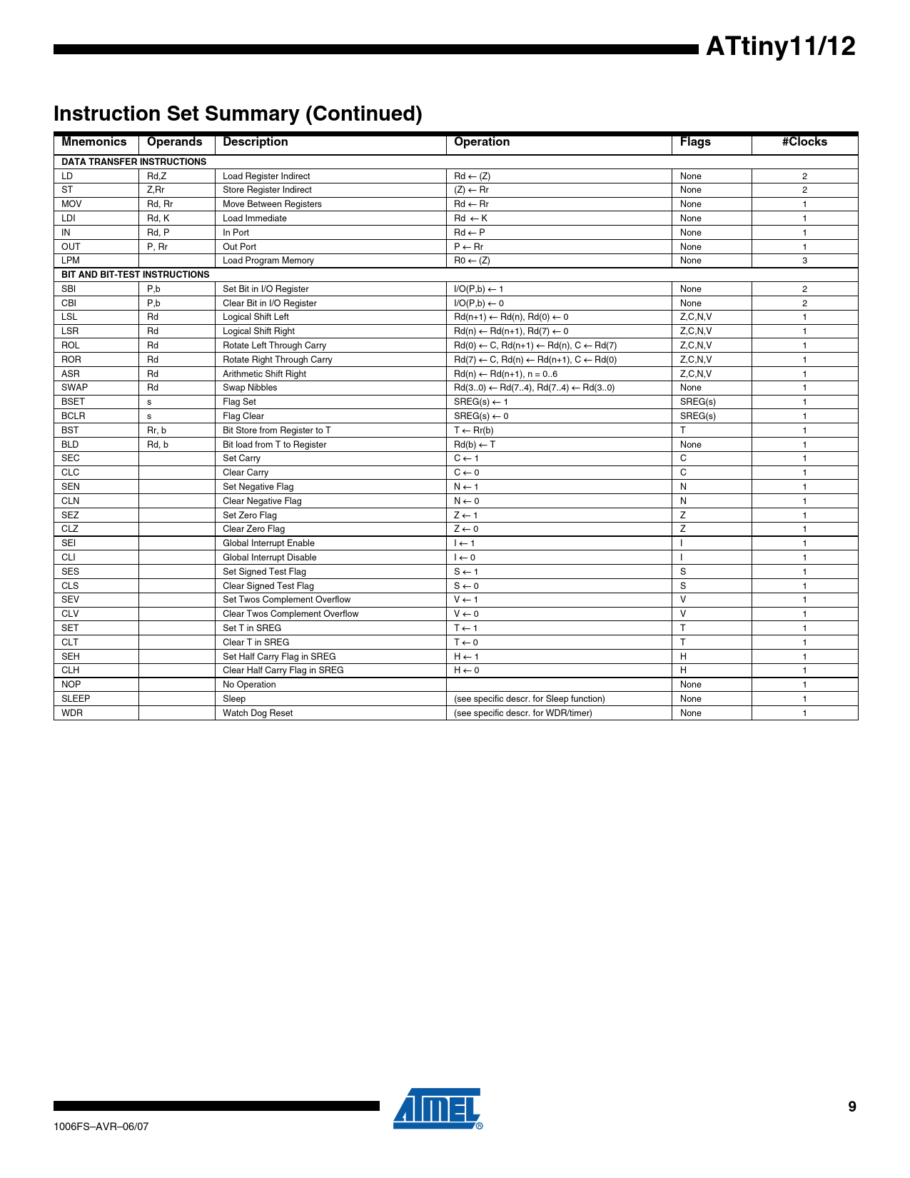

ATtiny11/12. Instruction Set Summary (Continued). Mnemonics. Operands. Description. Operation. Flags. #Clocks
ATtiny11/12 Instruction Set Summary (Continued) Mnemonics Operands Description Operation Flags #Clocks
ATtiny11/12 Instruction Set Summary (Continued) Mnemonics Operands Description Operation Flags #Clocks DATA TRANSFER INSTRUCTIONS
LD Rd,Z Load Register Indirect Rd ← (Z) None 2 ST Z,Rr Store Register Indirect (Z) ← Rr None 2 MOV Rd, Rr Move Between Registers Rd ← Rr None 1 LDI Rd, K Load Immediate Rd ← K None 1 IN Rd, P In Port Rd ← P None 1 OUT P, Rr Out Port P ← Rr None 1 LPM Load Program Memory R0 ← (Z) None 3
BIT AND BIT-TEST INSTRUCTIONS
SBI P,b Set Bit in I/O Register I/O(P,b) ← 1 None 2 CBI P,b Clear Bit in I/O Register I/O(P,b) ← 0 None 2 LSL Rd Logical Shift Left Rd(n+1) ← Rd(n), Rd(0) ← 0 Z,C,N,V 1 LSR Rd Logical Shift Right Rd(n) ← Rd(n+1), Rd(7) ← 0 Z,C,N,V 1 ROL Rd Rotate Left Through Carry Rd(0) ← C, Rd(n+1) ← Rd(n), C ← Rd(7) Z,C,N,V 1 ROR Rd Rotate Right Through Carry Rd(7) ← C, Rd(n) ← Rd(n+1), C ← Rd(0) Z,C,N,V 1 ASR Rd Arithmetic Shift Right Rd(n) ← Rd(n+1), n = 0..6 Z,C,N,V 1 SWAP Rd Swap Nibbles Rd(3..0) ← Rd(7..4), Rd(7..4) ← Rd(3..0) None 1 BSET s Flag Set SREG(s) ← 1 SREG(s) 1 BCLR s Flag Clear SREG(s) ← 0 SREG(s) 1 BST Rr, b Bit Store from Register to T T ← Rr(b) T 1 BLD Rd, b Bit load from T to Reg ister Rd(b) ← T None 1 SEC Set Carry C ← 1 C 1 CLC Clear Carry C ← 0 C 1 SEN Set Negative Flag N ← 1 N 1 CLN Clear Negative Flag N ← 0 N 1 SEZ Set Zero Flag Z ← 1 Z 1 CLZ Clear Zero Flag Z ← 0 Z 1 SEI Global Interrup t Enable I ← 1 I 1 CLI Global Interrupt Disable I ← 0 I 1 SES Set Signed Test Flag S ← 1 S 1 CLS Clear Signed Test Flag S ← 0 S 1 SEV Set Twos Com plement Overflow V ← 1 V 1 CLV Clear Twos Complement Overflow V ← 0 V 1 SET Set T in SREG T ← 1 T 1 CLT Clear T in SREG T ← 0 T 1 SEH Set Half Carr y Flag in SREG H ← 1 H 1 CLH Clear Half Carry Flag in SREG H ← 0 H 1 NOP No Operation None 1 SLEEP Sleep (see specific descr. for Sleep function) None 1 WDR Watch Dog Reset (see specific descr. for WDR/timer) None 1
