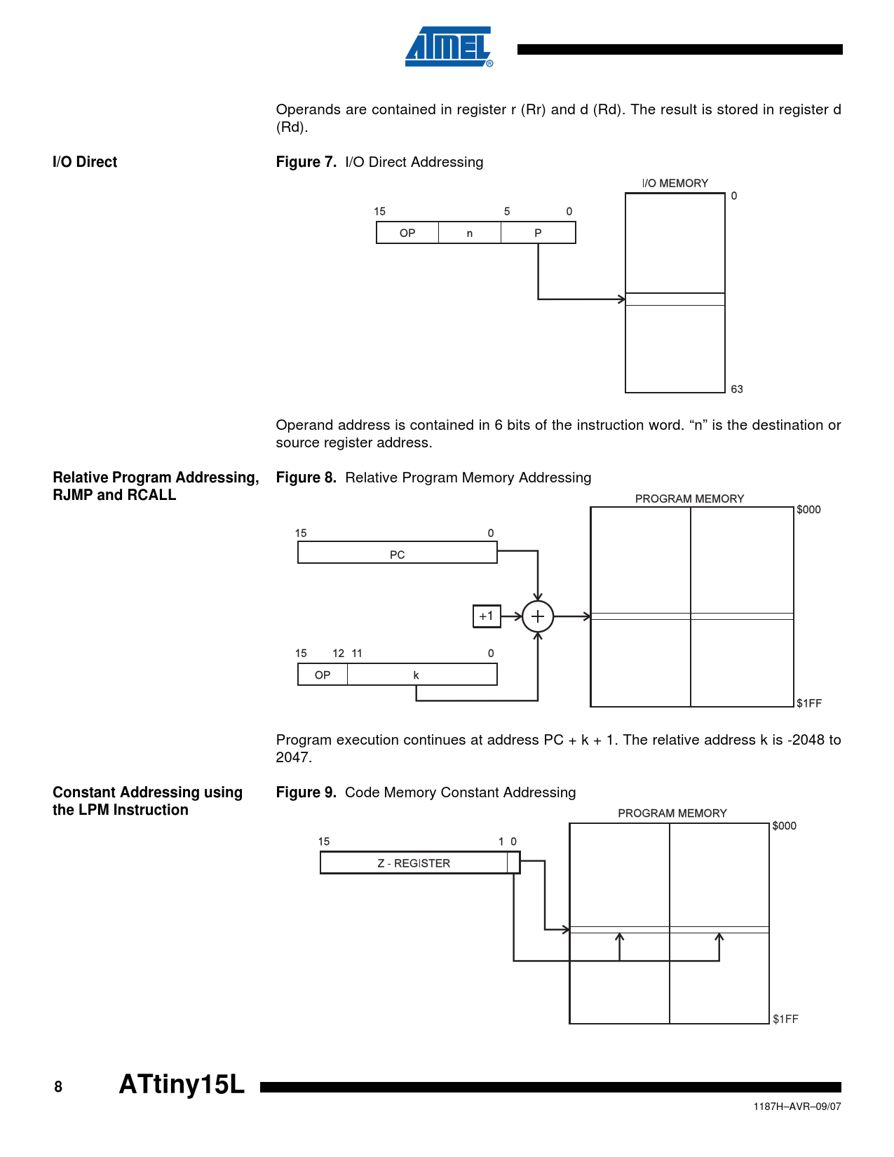

Operands are contained in register r (Rr) and d (Rd). The result is stored in register d (Rd).
I/O Direct Figure 7.
I/O Direct Addressing Operand address is contained in 6 bits of the instruction word. “n” is the destination or source register address.
Relative Program Addressing, Figure 8.
Relative Program Memory Addressing
RJMP and RCALL
+1 Program execution continues at address PC + k + 1. The relative address k is -2048 to 2047.
Constant Addressing using Figure 9.
Code Memory Constant Addressing
the LPM Instruction
$1FF
